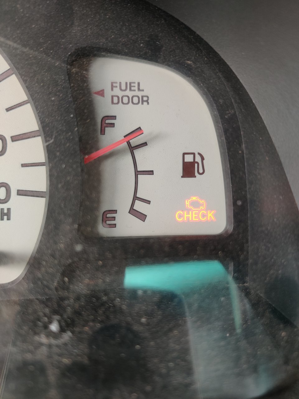

    It's fine, tank is full

    At least the fuel guage is working correctly now.
