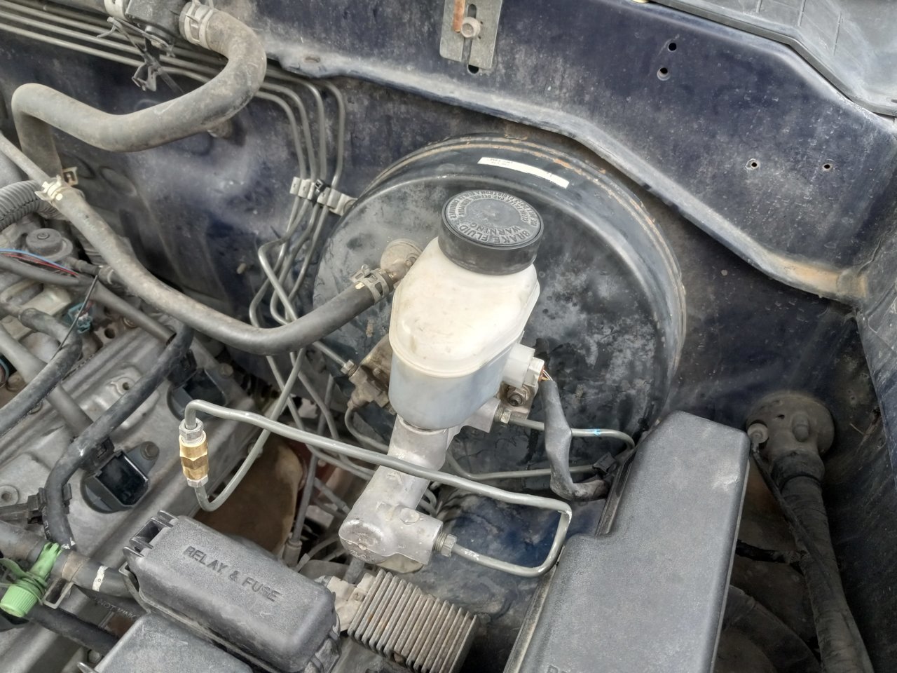

    I put the regular cab tundta booster and master in my double cab tundra
    Much more stopping power throughout but I can still make it act up in the same way... soo back to the rear lspv delete or drum adjustment

    Did you bleed the lspv before or after the rear drums? I found if you do the passenger side drum than the drivers side than the lspv it works best.

    I did it like this... Lspv, passenger drum, driver drum, passenger caliper, driver caliper
    I have one man bleed screws so even installing the master dry and no bench bleeding it only took about 7 minutes to get a rock solid pedal after bleeding all 5 bleeders
