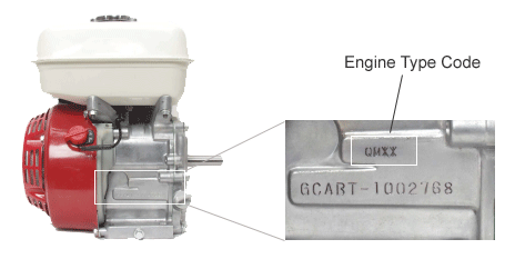

    My guess is that its going to be GX270UT1RA2. The middle digits tell me the generation and the manufacturing plant. But they don't stamp those middle identifiers on the block, however the letters in the serial number will tell me the generation. And with that I can look up the equivalent Thai spec engine and get you part numbers for way cheaper parts

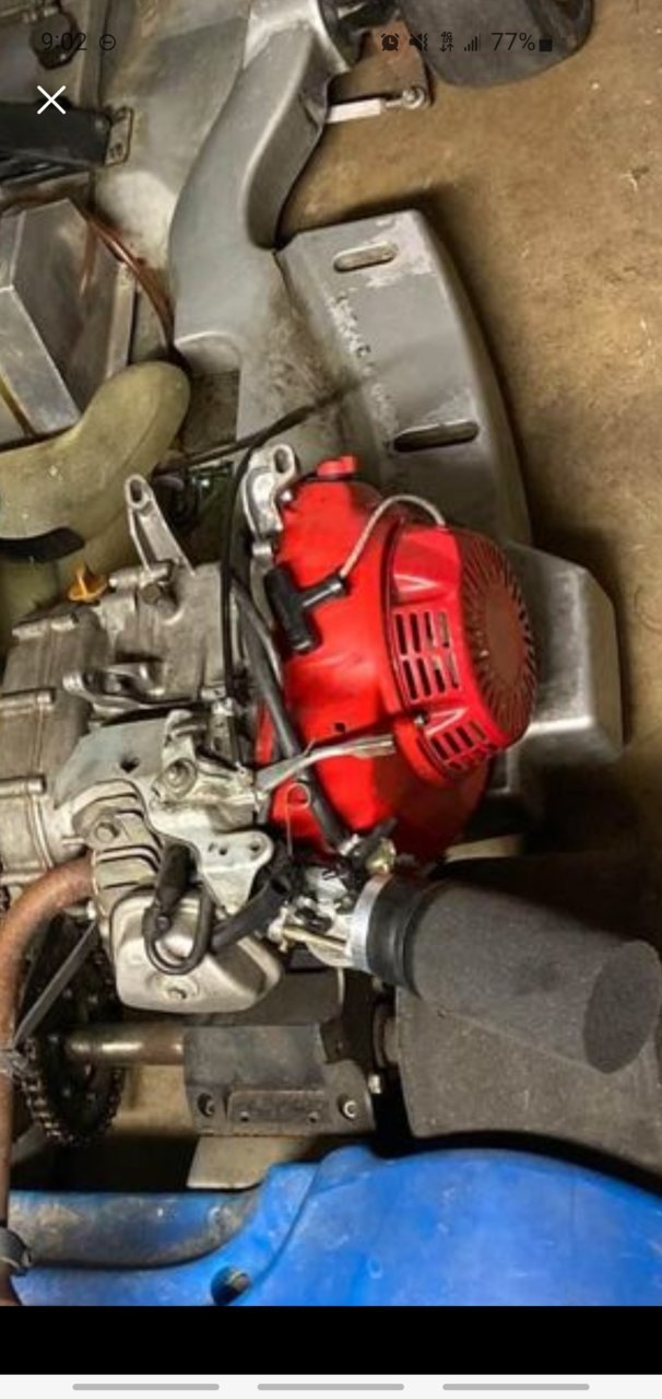

    The only close-up

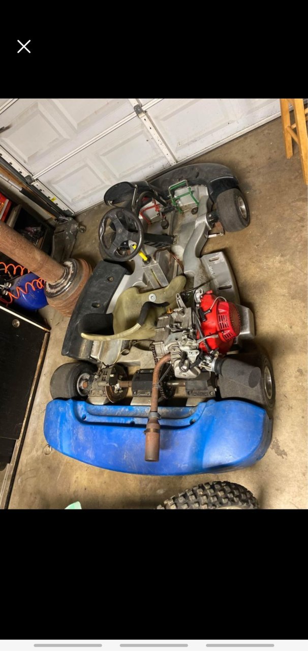

    Getting you in the loop; I've been checking out steel pricing (even if I got it from some rando that had extra in his or her shop). Add to that the cost of my time, I'm finding that I could buy a go kart frame for way less than building my own.
    I found multiple frames between $100 to $300. Figure I could always cut and replace anything with questionable integrity and weld new steel in place.
    Well, I found this thing and what stood out was the Honda GX270 that comes with it.
    Compression is good, but it knocks.
    After multiple back and forth texts between Jimmie and I, if I need to rebuild the whole thing and replace a few extra things, it'll cost me a lot less than buying a new motor.
    Apparently these Honda's are the bees knees?

    On the side of the block where I've circled, you'll find the type code and serial numberScreenshot_20220705-211124_Chrome.jpg

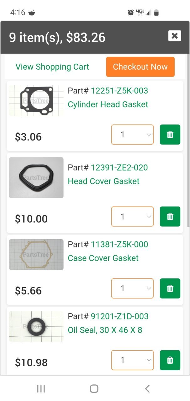

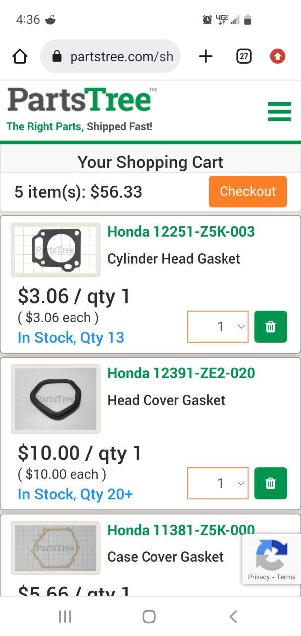

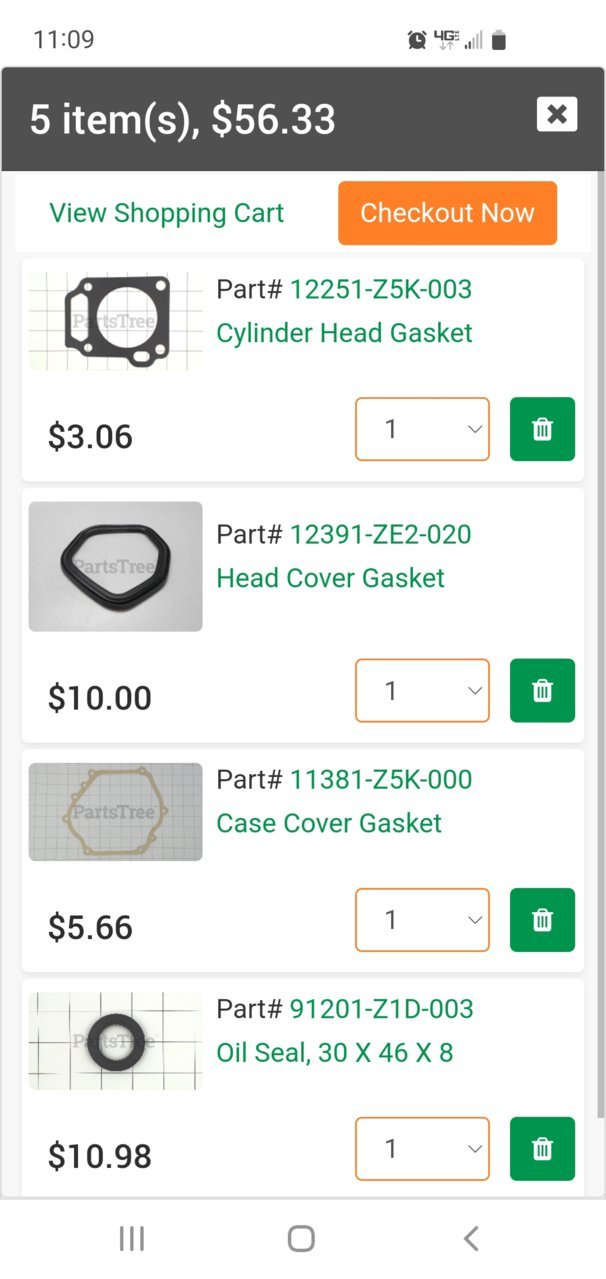

    These are the total parts if you can get away with just swapping the con rod. The other one was if you did the piston and rings at the same time but I wouldn't order anything till you got it apart.. who knows, you may want to do the clutch pack if it's got an ungodly amount of hours on it (or they ran it dry lol)

    Ahh ok, there's the rod part number.
