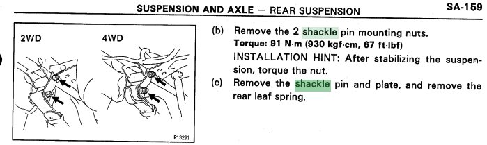

    I’m not sure since they’re already in and waiting to be torqued. It was a pain to put them in and I don’t want to pull them out again to measure haha. Might just send it at 70 lbs

    torque spec for the OEM shackle bolts is 67 ft/lbs, so I'd go with that in lieu of nothing specific from the aftermarket company.
    actually I'd probably do 70 as well because prime numbers make me uneasy
