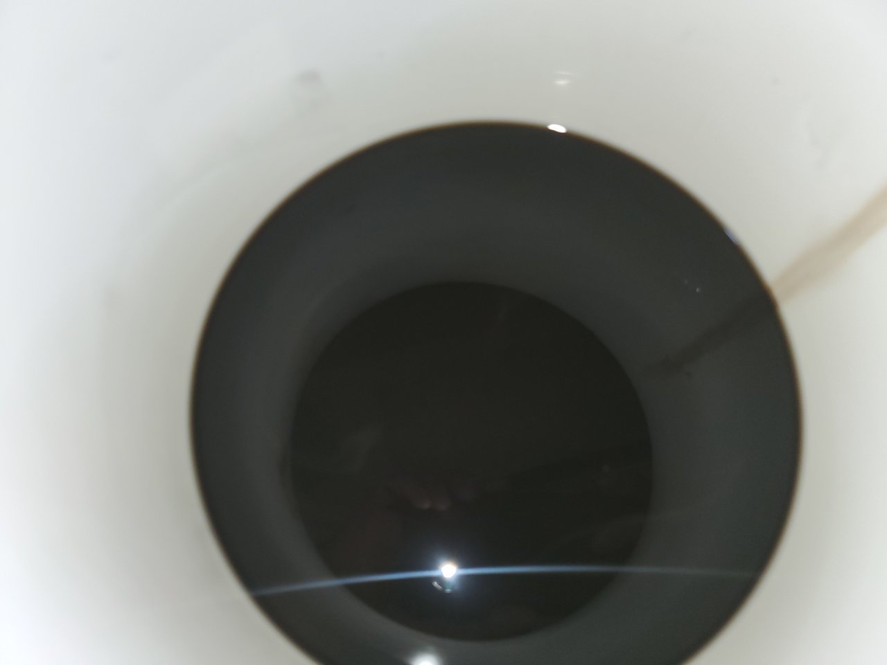

    That's pretty much the idea. No matter how much I clean the pan that I have I still see glitter :bananadead: Want to drain the trans on the Ford and hopefully have a super clean pan to check for danger sparkles
