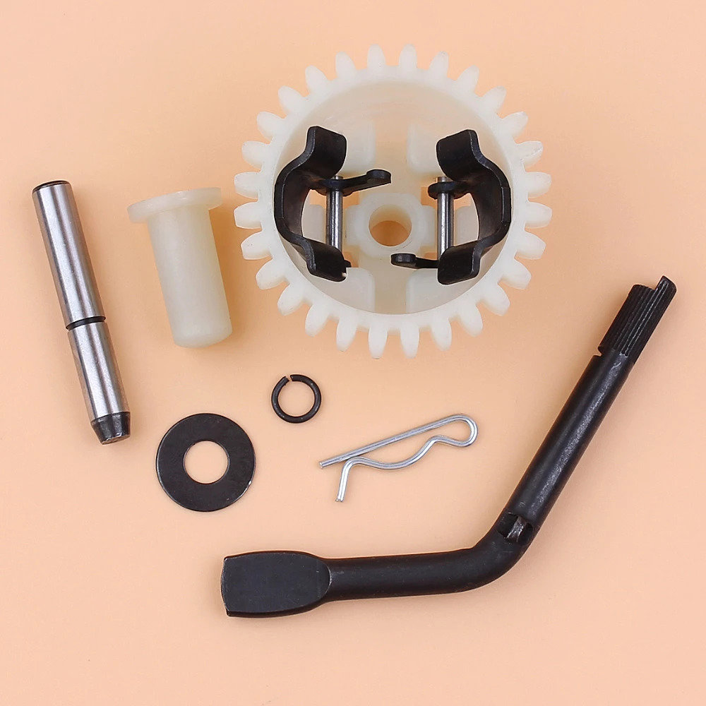

    It's a plastic gear with weights on it.. looks like this
    Governor-Gear-Arm-Shaft-Lock-Pin-Kit-For-Honda-GX200-GX160-168F-5-5HP-6-5HP.jpg_Q90.jpg_.jpg

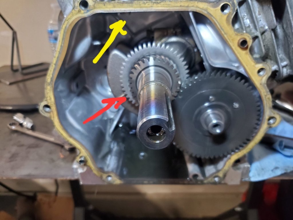

    It rides on this shaft on the case
    The plastic gear rides against this gear on the crank (marked in red) due to centrifugal force, at 3600rpm the metal weights on the plastic gear fling out and press against the bent shaft (in the first picture) that comes through the block (where the yellow arrow is) that bent shaft is mechanically linked to the throttle control to keep the engine at a max of 3600.20220707_160933.jpg

    Wow, that's pretty cool. I appreciate the explanation :D
    It never occurred to me but it makes sense to do it that way since 3600 RPM could happen at various throttle positions depending on engine load.

    Yea that's part of the beauty of power equipment engines. They're built around the sole purpose of doing work and all small gas engines run with maximum torque output at 3600rpm (+/- 200rpm) so they can do fancy little effective feats of simple engineering like that

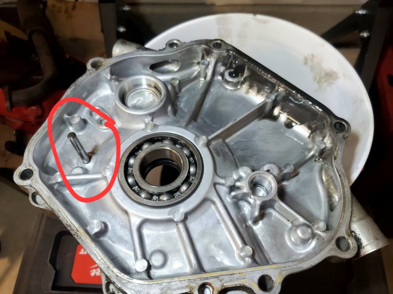

    @Abeyancer
    I love that site man, but shit it's so easy to say "I should get this, and this too"
    I'm noticing I'm missing little shit like a second dowel on both the crankcase cover gasket as well as the head gasket. :facepalm:

    Damn, they robbed you of your dowels?!?!
    The crankcase cover isn't so critical but the head one kinda is... although I've put mowers back together with no dowels, or gaskets. Just hondabond and hopes and dreams. They've all run lol

    Nooo, looking back again only one is missing on the cover for the reduction gearbox.
