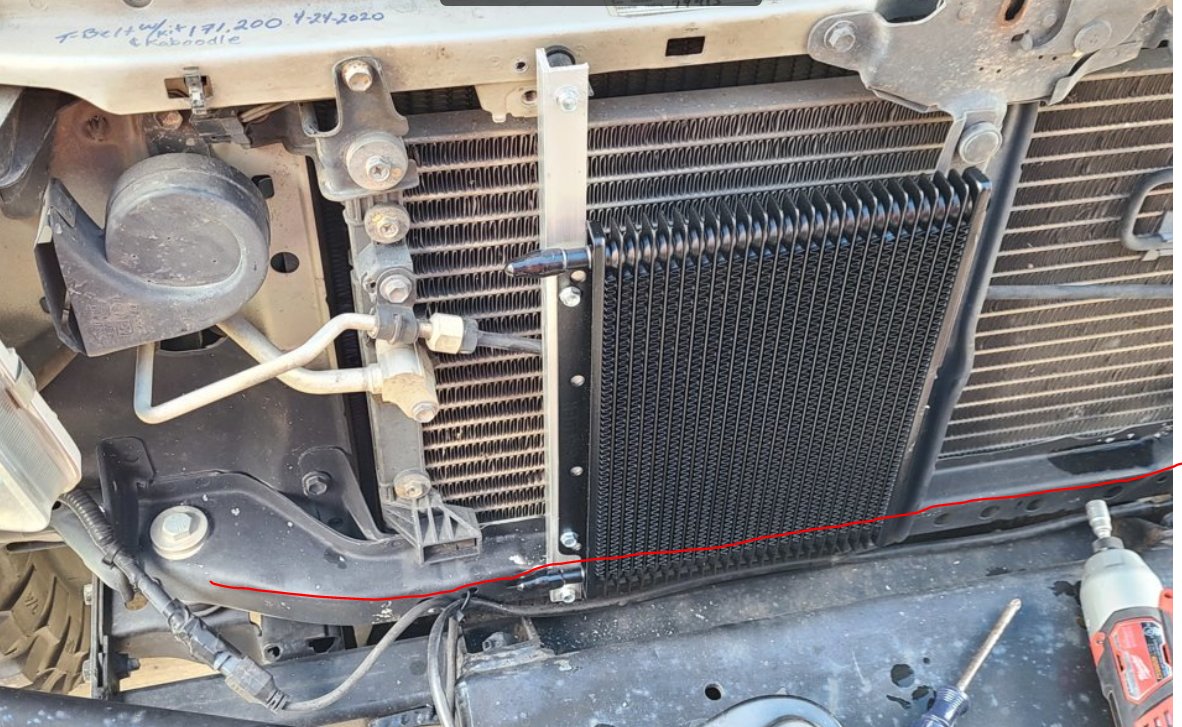

    What's a non-issue? That damn AC line in the way? It's an issue with the ARB because of the limited space to work with. The bumper literally contacts the cooler if using @zero4's mounting method.
    It needs to not extend out further than this support (in red)

    Did you leave it in this orientation or put it on its side? I was under the impression you wanted the intake on the bottom and the return on the top (unit turned on the side of course).
    Just realized that pic is looking down. Any other pics?

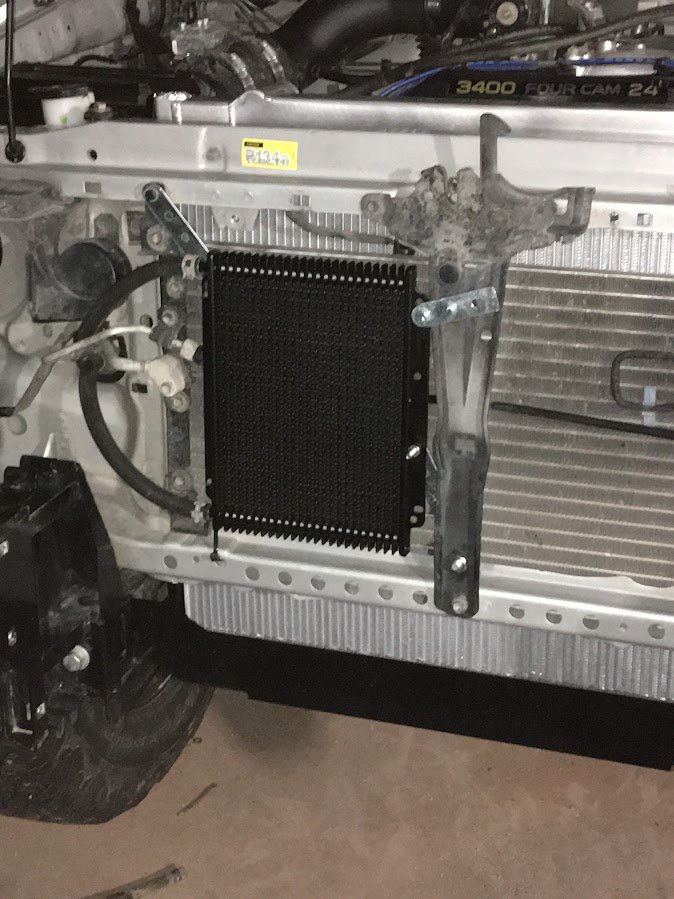

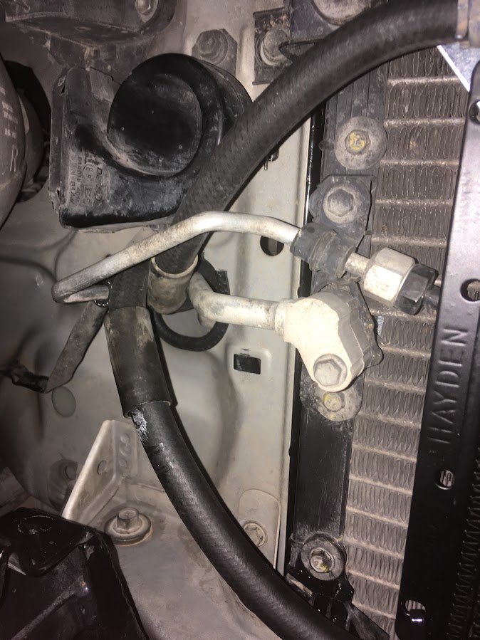

    Intended on getting a 4th bracket at the bottom left but so far I've just kept 3-4 zip ties on it... really need to get a nutsert riveted on the core support and get over my mental health issues. Intake at bottom and return on top like all the smart internet people told me.
    No more pictures because I finished this like a day before the winter storm hit us here in Texas. I was freezing to death bolting the bumper back on in shorts and a tshirt but didn't want to run out of time.

    I did have to remove 1 horn to make room but hardly a sacrifice really.
    The front leaves a lot of room, and yes the ARB takes up some of it, but the cooler is light and could stand to use 3 points of contact and hold on well. I know, I beat the 4R up pretty well.
