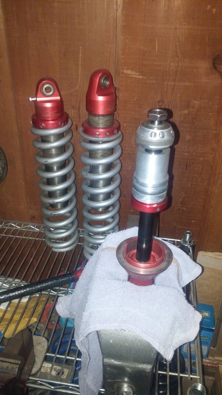

    I ask because I recall a conversation some 2-3 years ago with Fox about a rebuild. They said it's a little more intensive doing 2.0 IFP shocks than it is doing 2.5?
    I asked because I was looking into a revalve, and later on for a rebuild, for the universal Fox 2.0 shocks I ran on the Tacoma -

    I agree it does look a little more complicated. But it doesn't look to difficult. Looks like the valve stacks are mounted on the shaft the same way.
    I found this that might help you out.
    https://expeditionportal.com/forum/threads/rebuilding-fox-2-0-shock.204713/
    I also here shocks without a Schrader valve take little more work to charge.

    Honestly you really don't need to much specialty tools. With kings and SAWs you need an adjustable spanner wrench, an Allen key set, sockets, snap ring pliers, a set of picks, tape measure, a vice and a tank of nitrogen. You will master it pretty quick.

    Have all of that minus the spanner wrench and a means of charging said shocks.
    That and nitrogen, don't have any.

    Most bike shops or off-road shops will charge them for $20. I got lucky, some one down the street from me has a tank and is willing to share.
