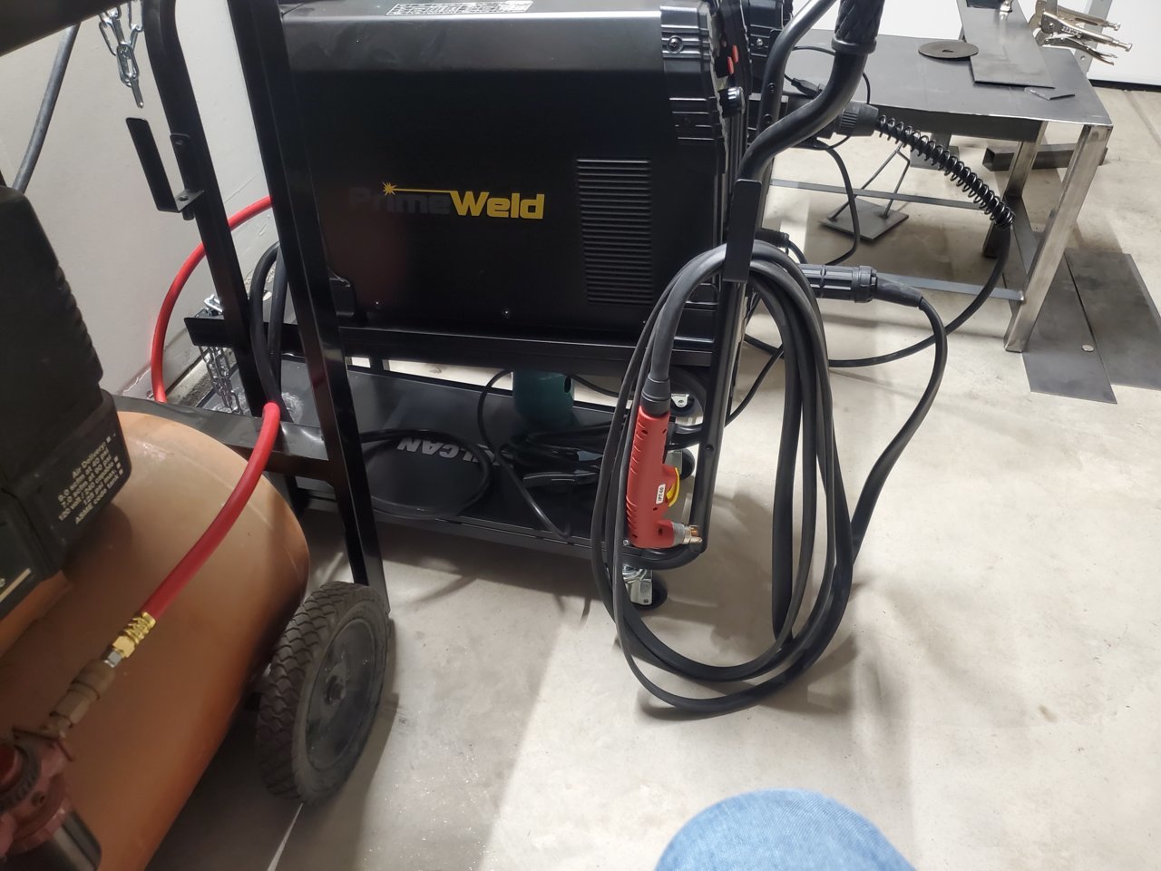

    Bought a short but fat air hose from the air dryer filter to the plasma cutter.
    Put quick connect/disconnects on the long hose so now I've got that I can conveniently use whenever.
    Swivel made it easy to thread on the backside.

    oh shit quick disconnects are gonna be super helpful for that. Never considered using them with a plasma before

    How much length ya got between the compressor and the dryer? We always tried to give it a good bit of hose so the air has time to cool down, making the dryer more effective.
    Then again I was in Houston, where it’s not so much humidity as it is water with air in it.

    I've tested the connections, no leaks and no real drop in pressure as all I need to the cutter is 65-70psi.
    I've got the compressor set to 90psi, and the regulator at the cutter to step it down to where I need.

    Not much really.
    The drier has a 2' hose from the compressor, and now it's an 8' hose to the plasma cutter.
    I want to put another filter right behind the plasma cutter, but cutting a few times and running my air compressor leaves not a single droplet when I pull the drain valve.
    Since buying a new drain valve, I remove it any and every single time I use the air compressor.

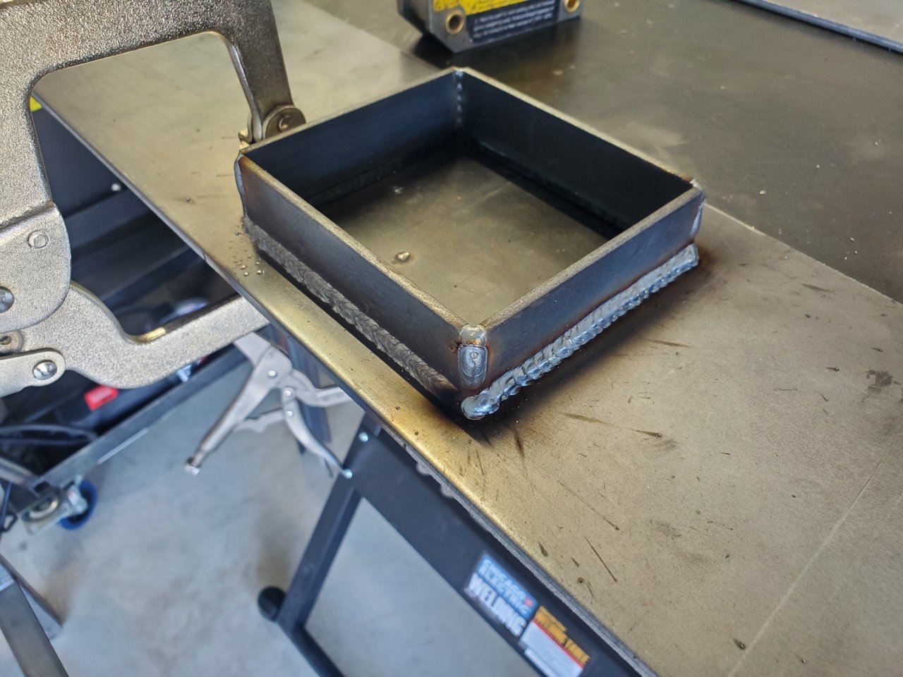

    Welding up this stupid thing

    Yep
    Fucked up some welds tho lol
