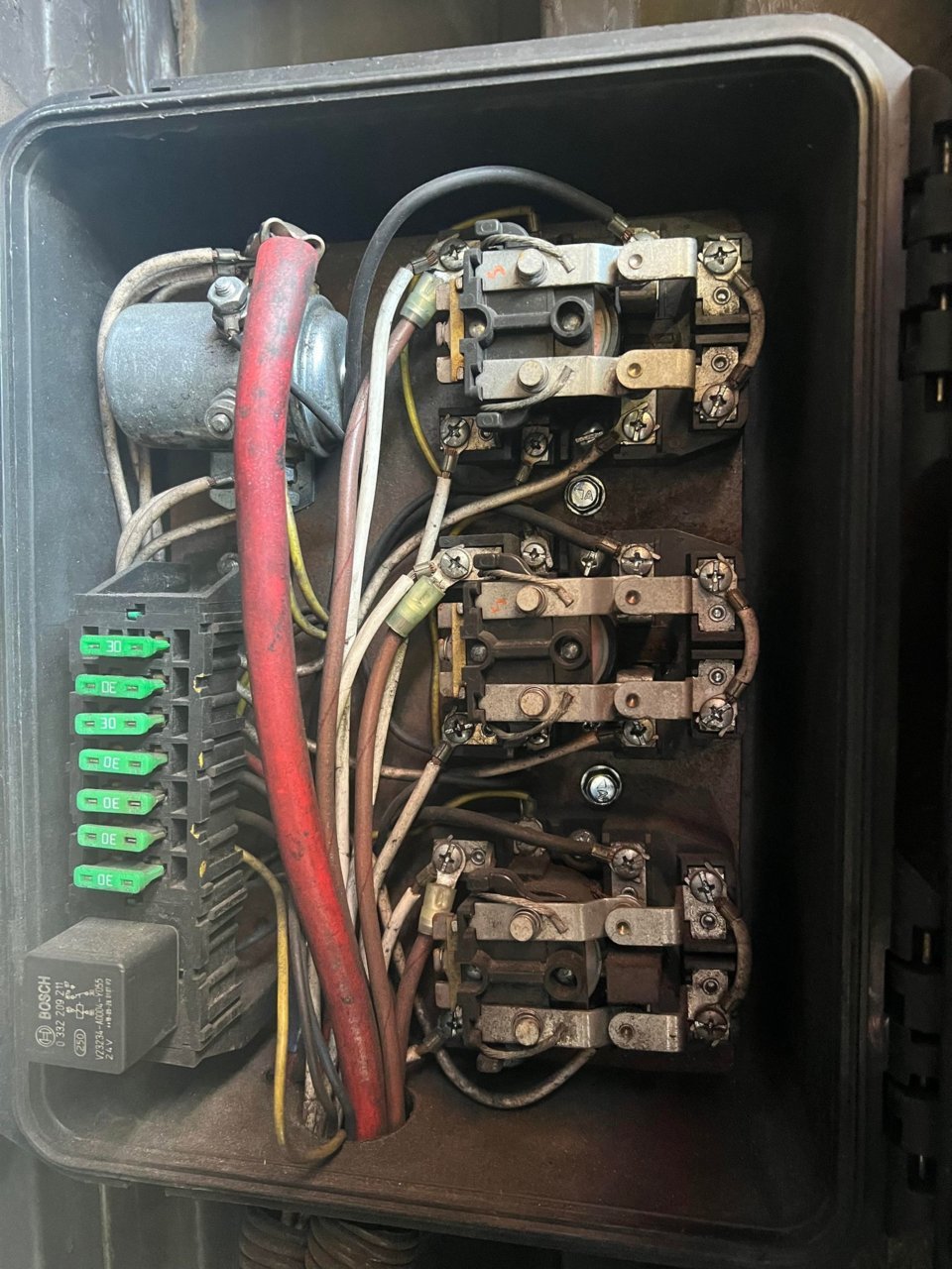

    BartMaster1234
    Aug 21, 2016
    #195197
    45,878
    Tyler
    Pittsburgh, Pennsylvania
    Flux Capacitor
    @Blue92 @Abeyancer @0xDEADBEEF
    Can any of you guys identify what kind of contactor/solenoid/relays are being used here? I'm trying to find replacements for the buses, they are what control the six e-fans for the Cummins ISX buses. We use a flawed design on the other buses which use only those cylindrical solenoids and they always fail, this setup has never failed so we want to re-create it.

  9. Aug 13, 2022 at 7:08 PM
    BartMaster1234
    Aug 21, 2016
    #195197
    45,878
    Tyler
    Flux Capacitor
    Yeah it’s a mystery. No part numbers on it either. Could you tell me what the difference between a contactor and a solenoid is? They seem like they do the same thing.
  10. Aug 13, 2022 at 7:13 PM
    Blue92
    Blue92 Well-Known Member
    Aug 26, 2017
    #228071
    16,481
    Daniel
    North Carolina
    2018 Sport
    Contactor uses an electro magnetic coil to close contacts. Solenoid uses a coil to open/close a valve, or move an actuator.

  13. Aug 13, 2022 at 7:17 PM
    0xDEADBEEF
    Mar 2, 2019
    #285037
    19,828
    2000 reg cab 4x4 flatbed MT
    Kinda looks like an open frame power relay. Have you taken one out and looked at the sides? Might be some numbers hidden

  15. Aug 13, 2022 at 7:18 PM
    Speedytech7
    Feb 20, 2014
    #123587
    58,019
    FCQM+VG Cheney, Washington
    It's less Tacoma and more mod
    Are you guys playing with solid state relays yet in your control stuff? We have them for high speed applications like trans brake control and nitrous control.

  17. Aug 13, 2022 at 7:23 PM
    BartMaster1234
    Aug 21, 2016
    #195197
    45,878
    Tyler
    Flux Capacitor
    Interesting. I think that could be what it is.
    I’ll have to try to pull it off before it leaves in the morning. That specific bus always goes out everyday on the account of being extremely reliable.

  20. Aug 13, 2022 at 7:28 PM
    BartMaster1234
    Aug 21, 2016
    #195197
    45,878
    Tyler
    Flux Capacitor
    24vDC.
    If you could help me with a design that would be great. Currently the fans receive the trigger signal to turn on at 100% speed when the alternator is on (engine on) and it KILLS the fans because the drivers just let the buses idle all day. We wanted to do a setup where it changes with engine temperature like a car would.
