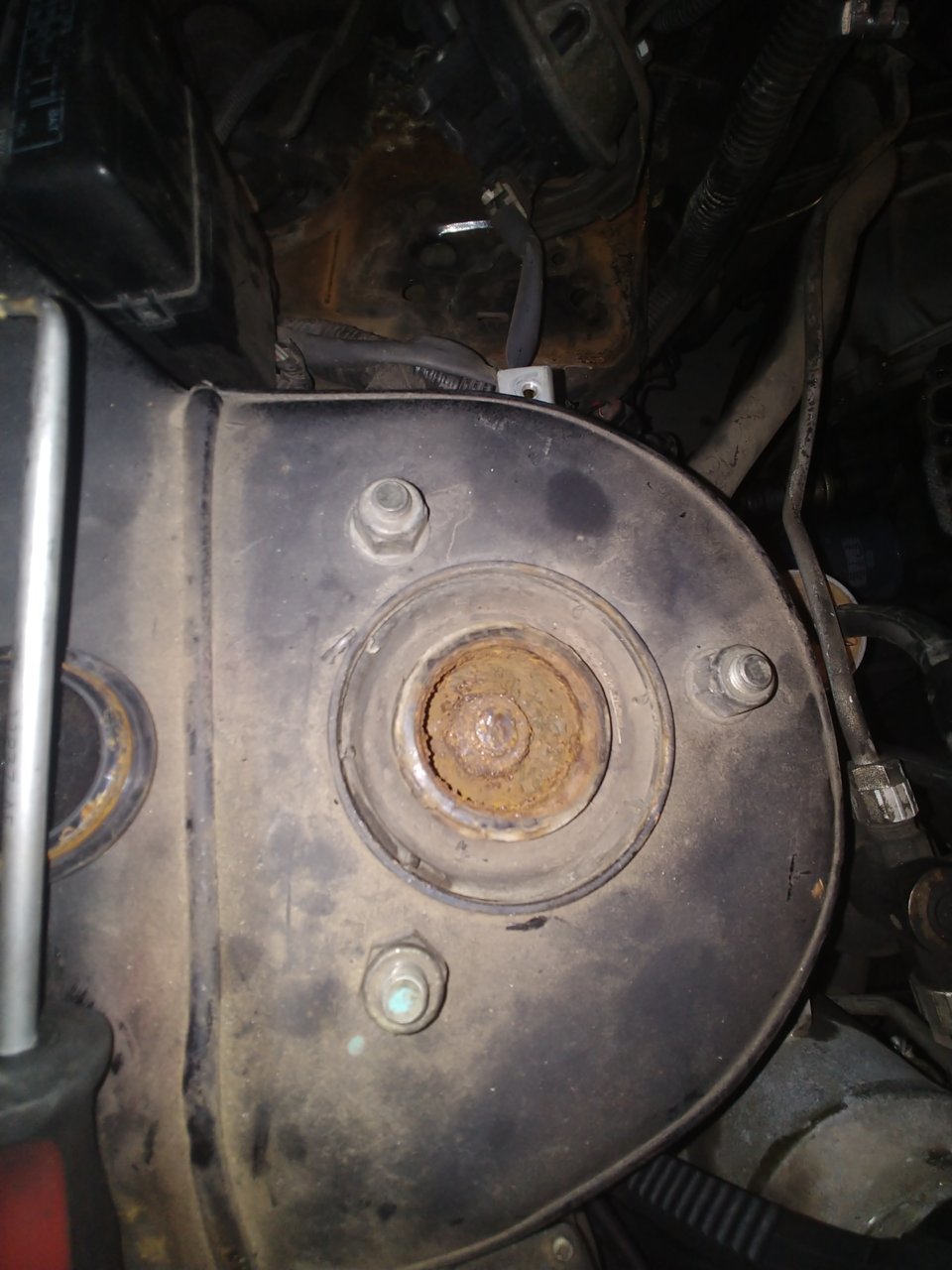

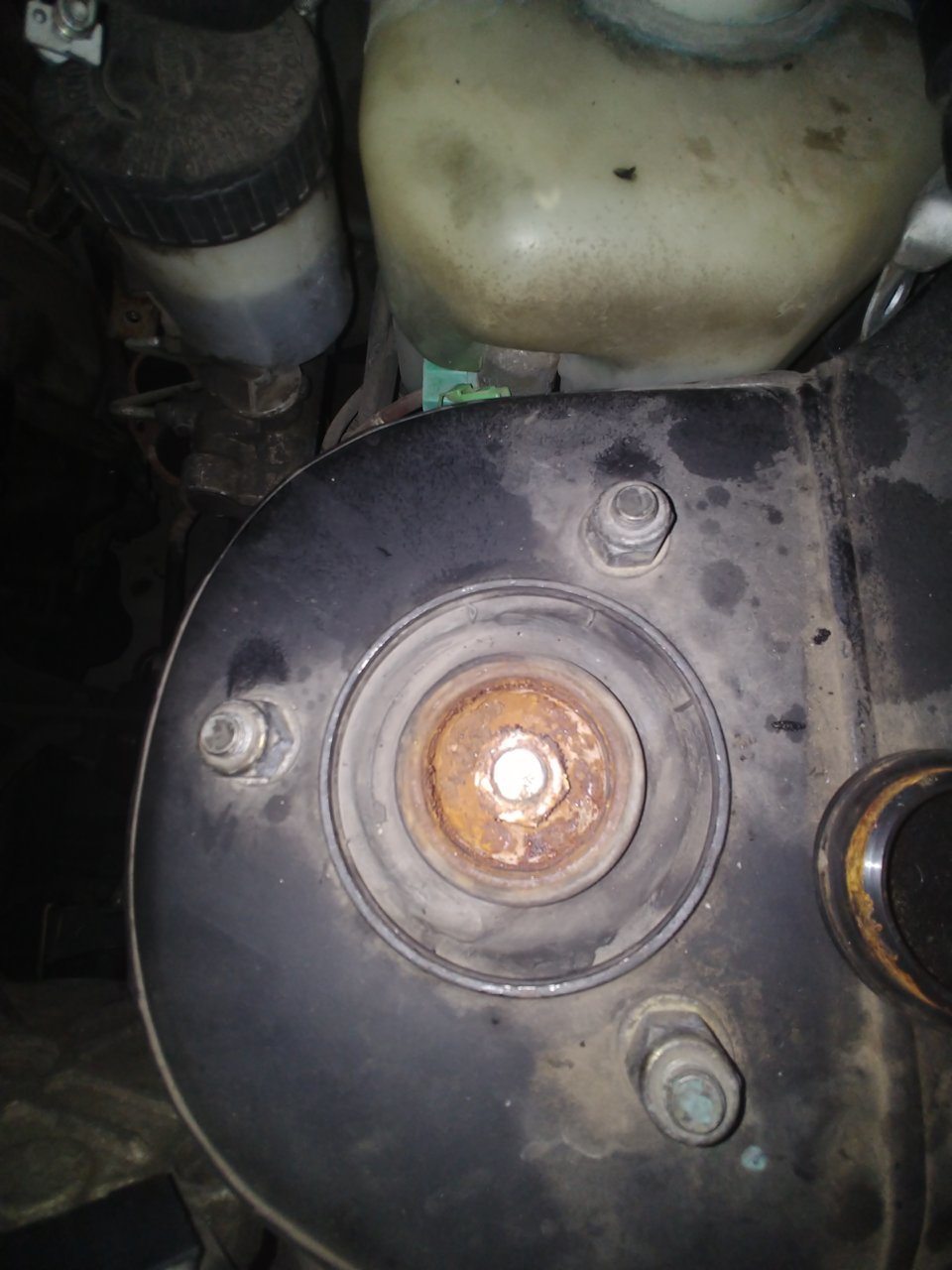

    It's less Tacoma and more mod
    Yeah they're Eibach lowering coils from the late 80s and they're decent. But the strut nuts are fucked

    It's the only real rust on the car...

    ive used strut compressors to hold the sping and cut the nuts off.
    no issues at all. just make sure the strut hat has no load on it.

    i've had worse than that come right off with a bit of heat

    I dont have a good torch anymore, just a propane thing that take too long

    yea. cut em lol

    They're toast anyway, one makes amazing clunking noises that sounds like failing tranny mounts
