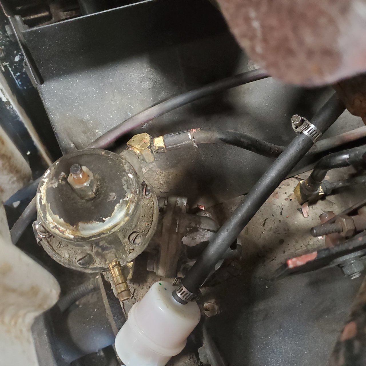

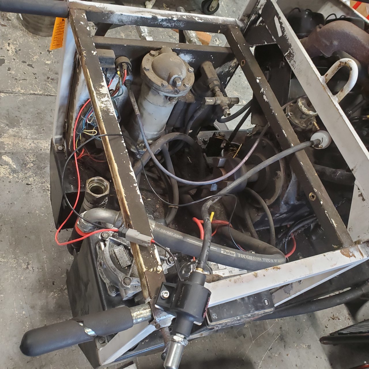

    @Wulf @Kwikvette that used powerpack is another can of worms, diagnosis showed mechanical fuel pump is bad (plus you can see the broken fuel line in this photo) 20220907_102418.jpg So I'm trying to just to see if the engine will run with plumbing in an electric fuel pump for shits and giggles.

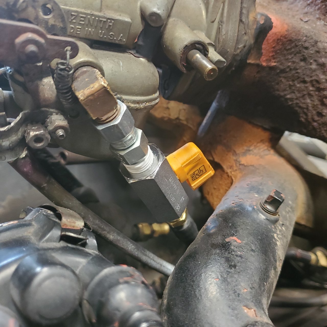

    You know what that means!!! Hey fam, its ya boi here for the adapter party:luvya:
    20220907_102409.jpgwith special guest star, 1/4fnpt ball valve cause I don't have any normal 1/4 couplers, nor a 1/4fnpt hose barb lol

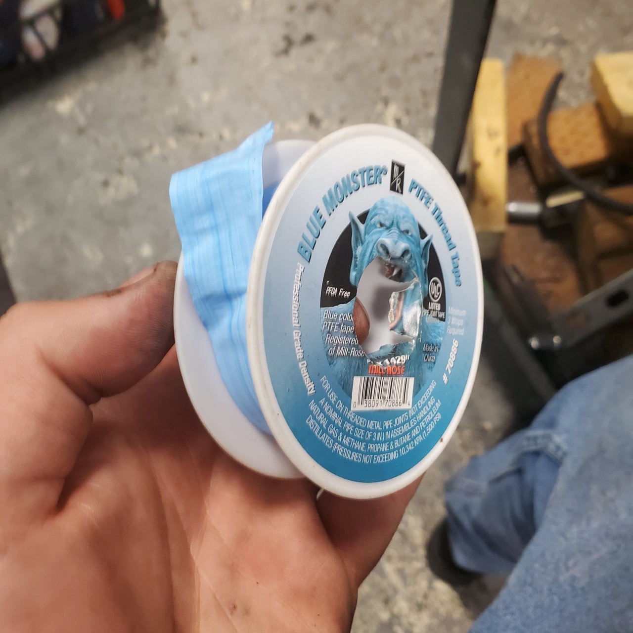

    Some more teflon tape and you can call yourself a plumber

    Oooohhh shit, did you pay your DuPont Tax for using that "T" word?!?!:D
    No worries there Dawgs, I got that high class PTFE in stock!20220907_110937.jpg

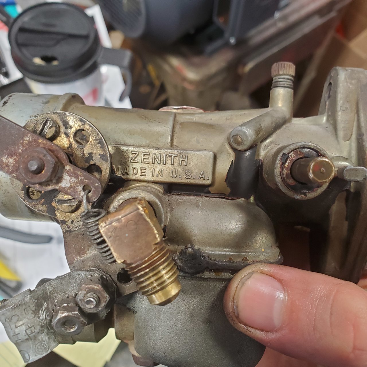

    Nope, carb is flooding now that it get gas.. gotta remove it and check the needle, seat and float.

    What the baby AN fitting or Made in USA... or the float bowl held on by asphalt sealer?

    The made in USA zenith carb was what I was remarking on specifically though. The baby AN fitting is different for a small engine but not the first I've seen it. And that is the rubber gasket degraded to the point it just looks like asphalt sealer
