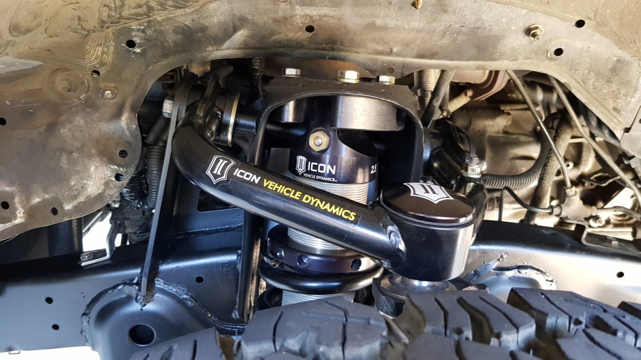

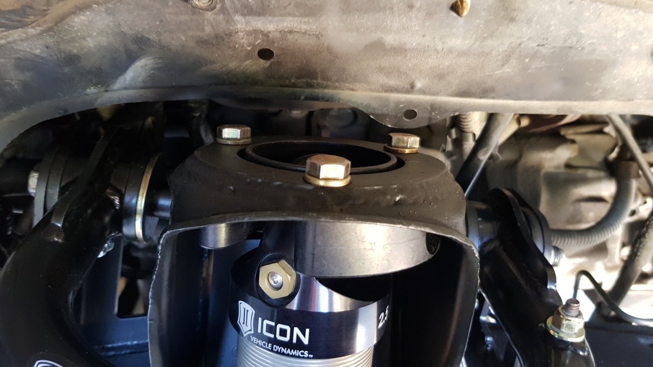

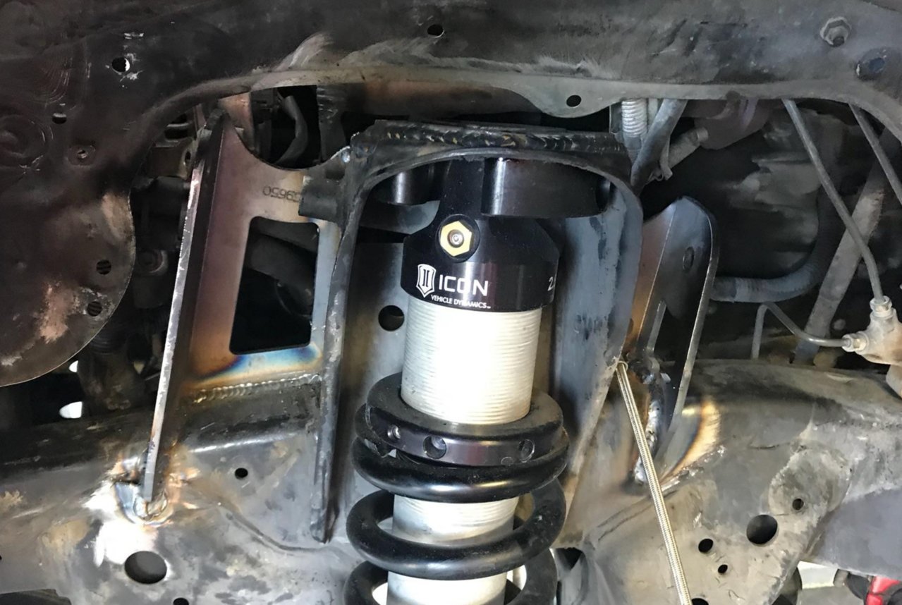

    I had TC shock bucket gussets installed a few weeks ago. What were you looking to find out about them?
    If you were looking for how to install threads, I doubt you'll find any. To be honest if you are an experienced welder you shouldn't need guidance from an how to thread. It's pretty straight forward, the instructions included with the gussets is all you need. Most important part is to install the sleeves, washers & bolts for the UCAs minus the outer washers & bushings when welding the gussets in place. The rest is mainly just weld prep. BTW in case you weren't aware, you need to have aftermarket UCAs, they won't work with stock UCAs.
    Same for the spindle gussets, tear down, & prep for welding. I didn't get the spindle gussets installed cause the fab guy doesn't do spindle teardowns on 1st gens. I'll get them done when I need to do wheel bearings.
    While you're at it I recommend welding on top plates for the shock buckets. That's where it cracked for me.
