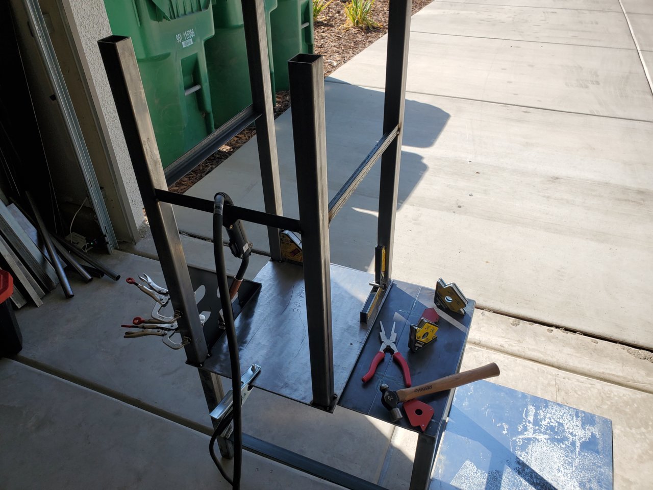

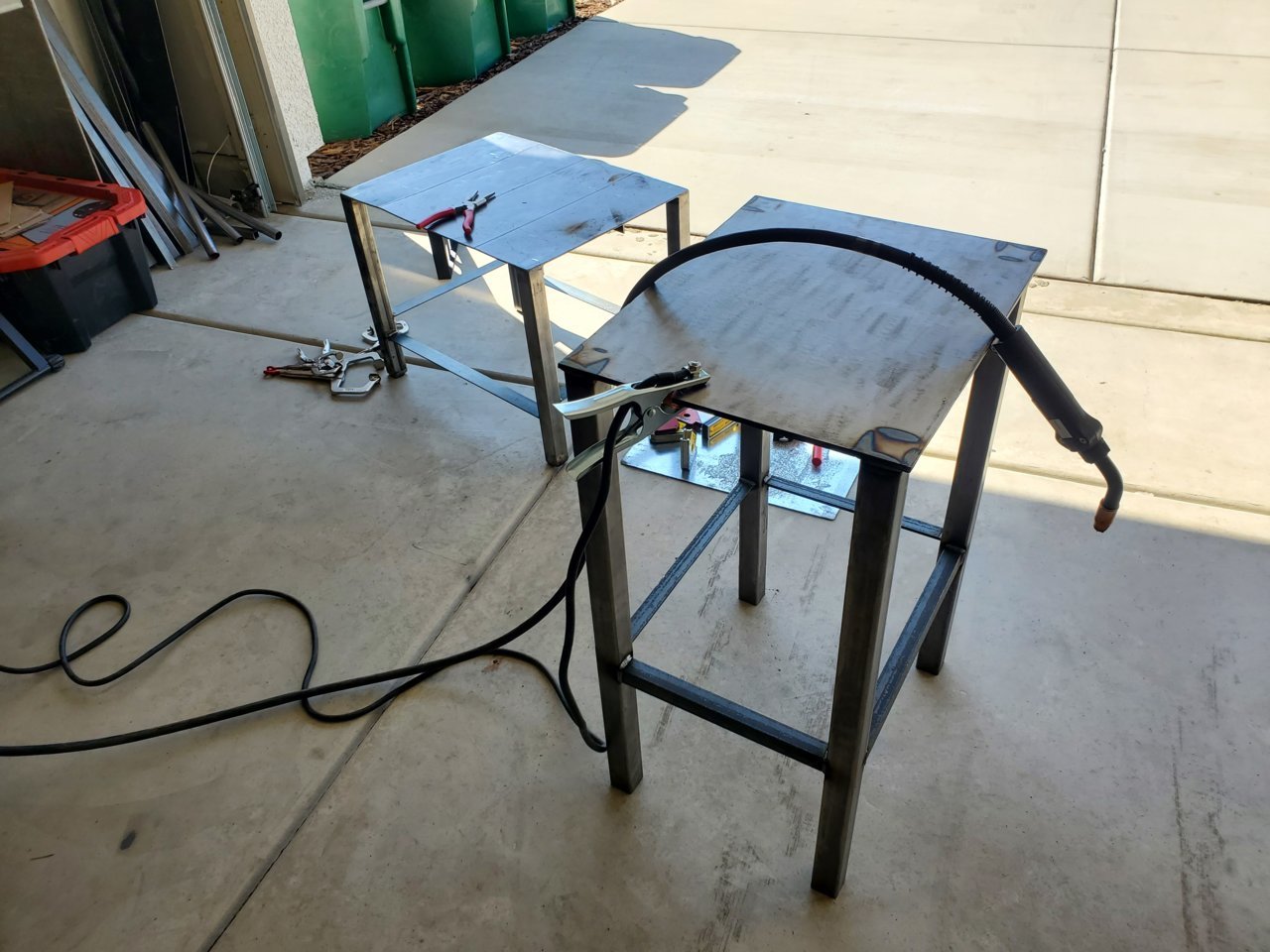

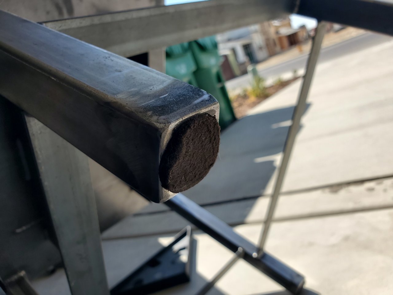

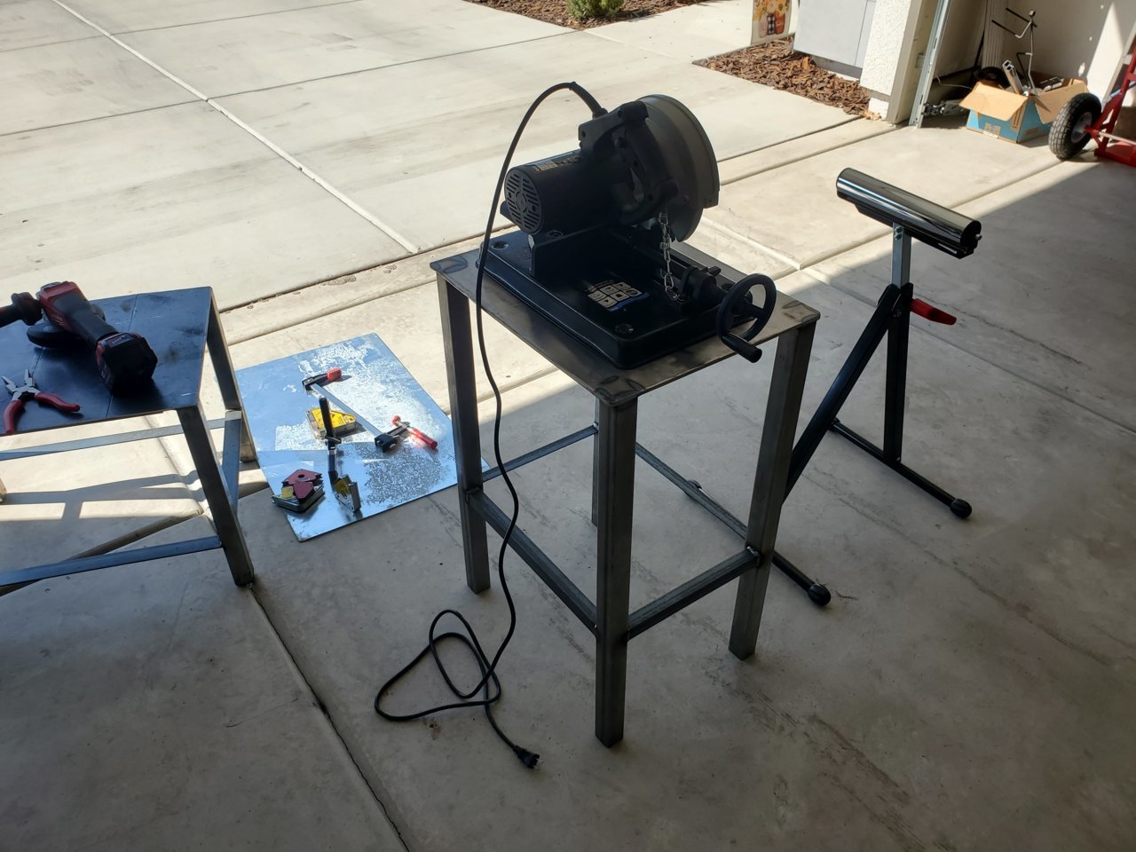

  20. Sep 14, 2022 at 10:21 AM
    Kwikvette
    Feb 27, 2019
    #284735
    81,995
    Fresno County
    4 run, 2 don't
    Follow-up to yesterday's steel plate I bought.
    Made a little stand for my saw sitting near 30" tall for a comfortable cutting height -
    Just need to buy some casters and weld them to one side as well as a handle so I can easily move and tuck it away
    Just need to figure how I want to "clamp" the saw to the table top
    Tabletop is 18 1/2" x 15" x 1/4"
    Legs are 1 1/2" square at 29 1/2" x 1/8"
    Angle is 1" x 1" x 1/8" at 15 9/16" and 11 3/8" between the legs
    Need to cut 1 1/2" flat stock pieces and weld to the bottom of the legs like I did my other table, and put "soft feet" on them -
