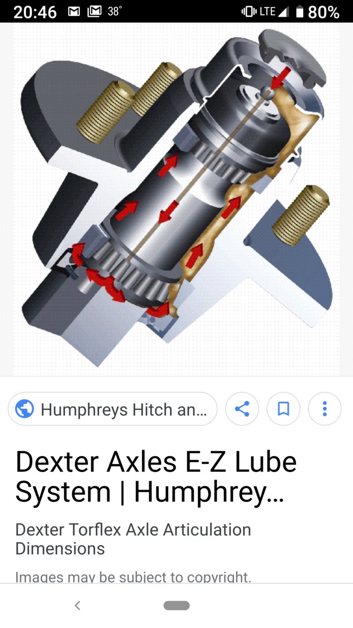

    No BB's. They just encourage you to skip checking the bearring. Plus the seals on trailer axles are shit. Plus the buddies push the grease past the seals and it ends up on the inside of your wheels. At best you have dirty wheels, at worse you have unbalanced wheels from the accumulation of dirt on inside of the wheel.

    Just pull the caps, jack up the trailer once a year and check for slop in the hub. Tighten if needed.
    BB's is bearring Buddies. I'll pass.

    Just to be clear, Berring Buddies and EZ lube axles are 2 different things. I like the latter.

    In case some are wondering what EZ Lube axle stubs are, here you go.Screenshot_20181011-204638.jpg
