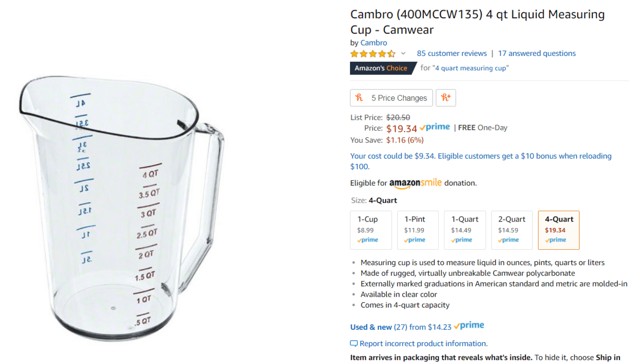

    i use a container with mesaurements.. drain into it, put the same amount back in. (i do it with the trans cold so that the fluid level isnt higher or lower than what the new fluid would be at..)

    Yes, this. Was thinking of ordering one of these to have a good idea of exactly how much was drained.

    No I don't think it works that way. It won't suck the fluid in. It has to be pumped in. The machine we had at the shop pumps new fluid in.
    So DIYrs will refill the pain after 4-5 qrts comes out or use some sort of electric pump.

    I'd get a much bigger container that. Even though you'd only be pumping out 4-5 qrts at a time it'll get messy with a container that small. Just use a 5 gallon bucket or water bottle. Pour 4 or 5 qrts of water in then mark a line.

    4 quarts isnt enough. usually get like 5.5 qts out of a trans
