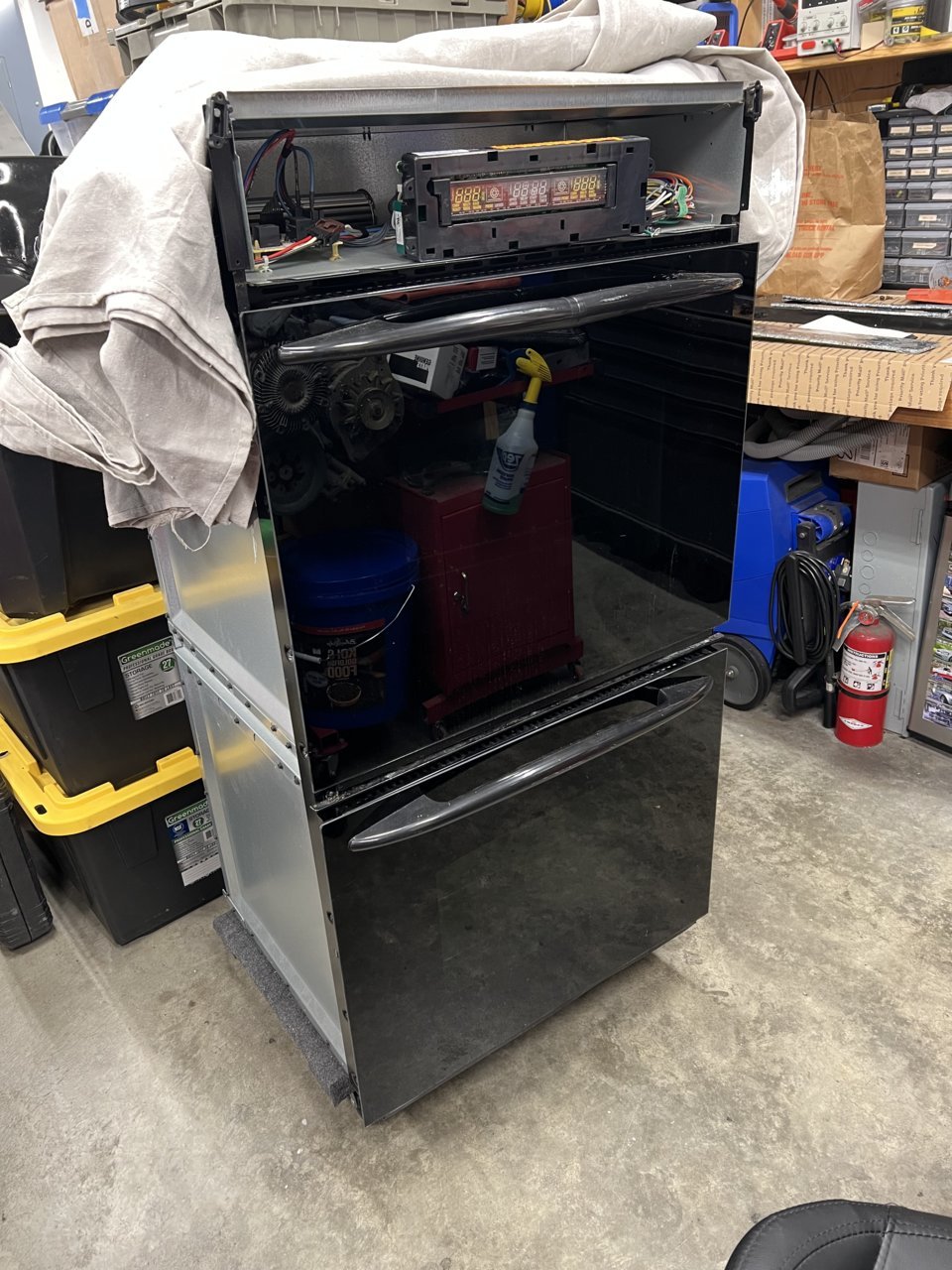

    I picked up a GE Double Oven for powdercoating. It runs on 240v.
    What gauge wire do you think I would need to run from the breaker to the plug, maybe 3 feet away?
    I currently have a 30a circuit ran for my compressor, the run is very short - as the panel is opposite of the outlet on the wall. I was wondering if it was okay to just swap the 30a breaker for a 50a one, and replace the 10-30R receptacle with a 14-50 (or other 50a outlet) to run the oven.

    That’s already on a dedicated breaker. I just want to know if I can swap the outlet and breaker from the 30a one to a 50a one. The run is short, only three feet.

    That’s the info I’ve been unable to find. It’s supposed to be hard wired into a junction box since it’s a built in oven, but since it’s on wheels not to be installed permanently I have to put a plug on it.

    Damn manuals won’t tell me. They just say hook it up to a junction box. I’ll keep looking but I can only assume it runs north of 50 amps.

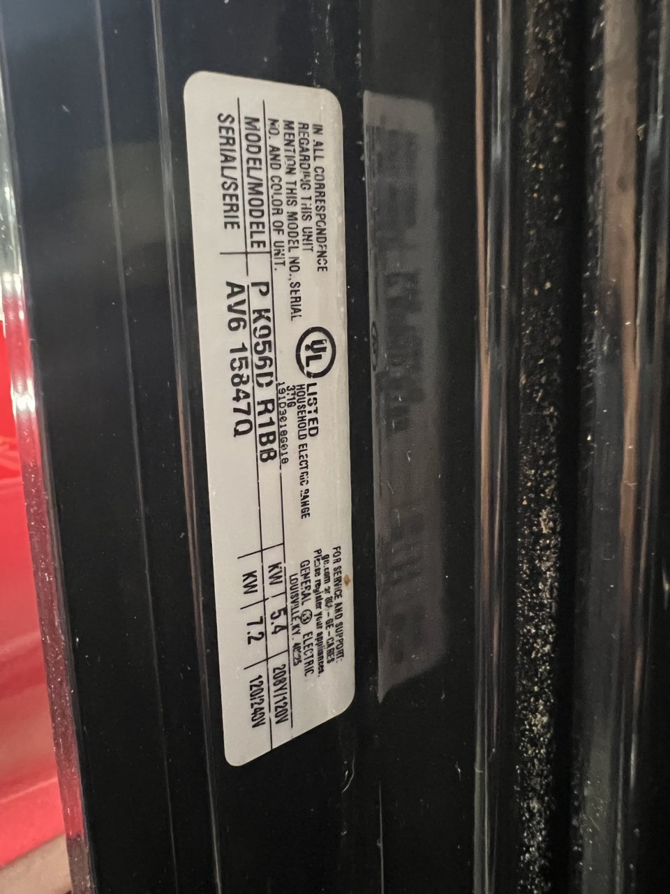

    Should be a nameplate on it somewhere listing watts. Need to know rated current to determine wire size and OCP.

    Granted it’s older, our kitchen aid has the info inside the thing behind a panel

    Like @Empty_Lord said, it may be near the panel where the conductors enter the unit. My dryer and oven have a small removable plate where the conductors enter for connection.

    This is true. Let me look

    I found it. Don’t know if that’s what you’re looking for.
    Ignore the missing control panel. I dropped the whole oven from my truck and it shattered haha.

    My eyeballs tell me 50 amp

    7.2kW -> 7200 W -> 7200 VA
    7200 VA / 240V -> 30A

    Not accounting for voltage drop. Also, could cause issues if using "continuously" (i.e. for 3+ hours at high temps). Don't have the code book in front of me either for special conditions.

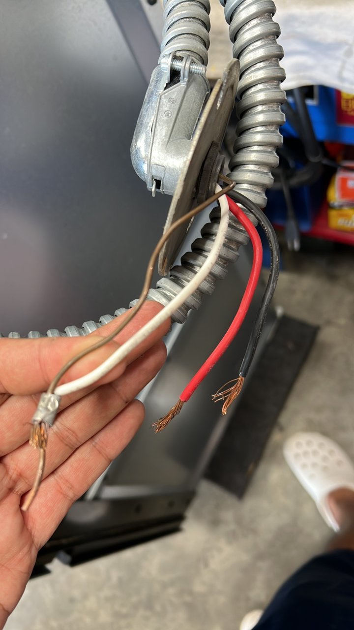

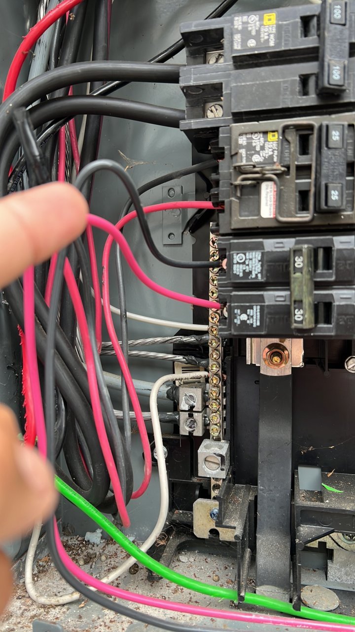

    Wow the damn thing only takes 30A? So I could run it off my NEMA 10-30 plug? I see that the original install bonded the ground and neutral together. My 10-30 has two hots and a ground. No neutral. BUT there is a neutral in the wall not connected to anything.
