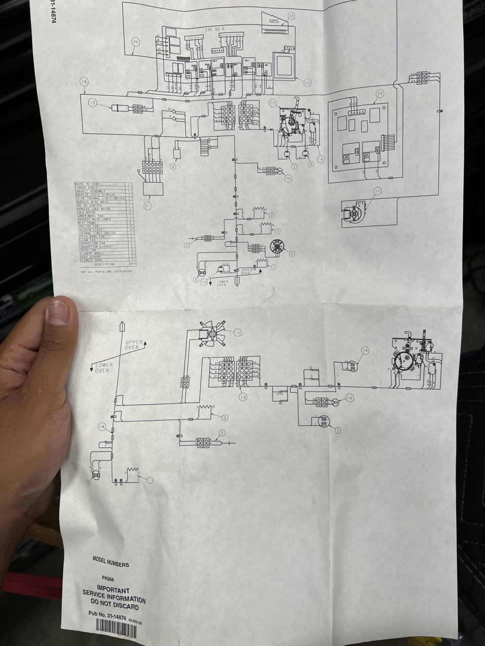

    Depends on the load and wiring. What does the range have for inputs? The heating element is likely phase-phase, but many units will have a neutral input to utilize 120 circuits for controls, fans etc.

  3. Sep 26, 2022 at 8:23 PM

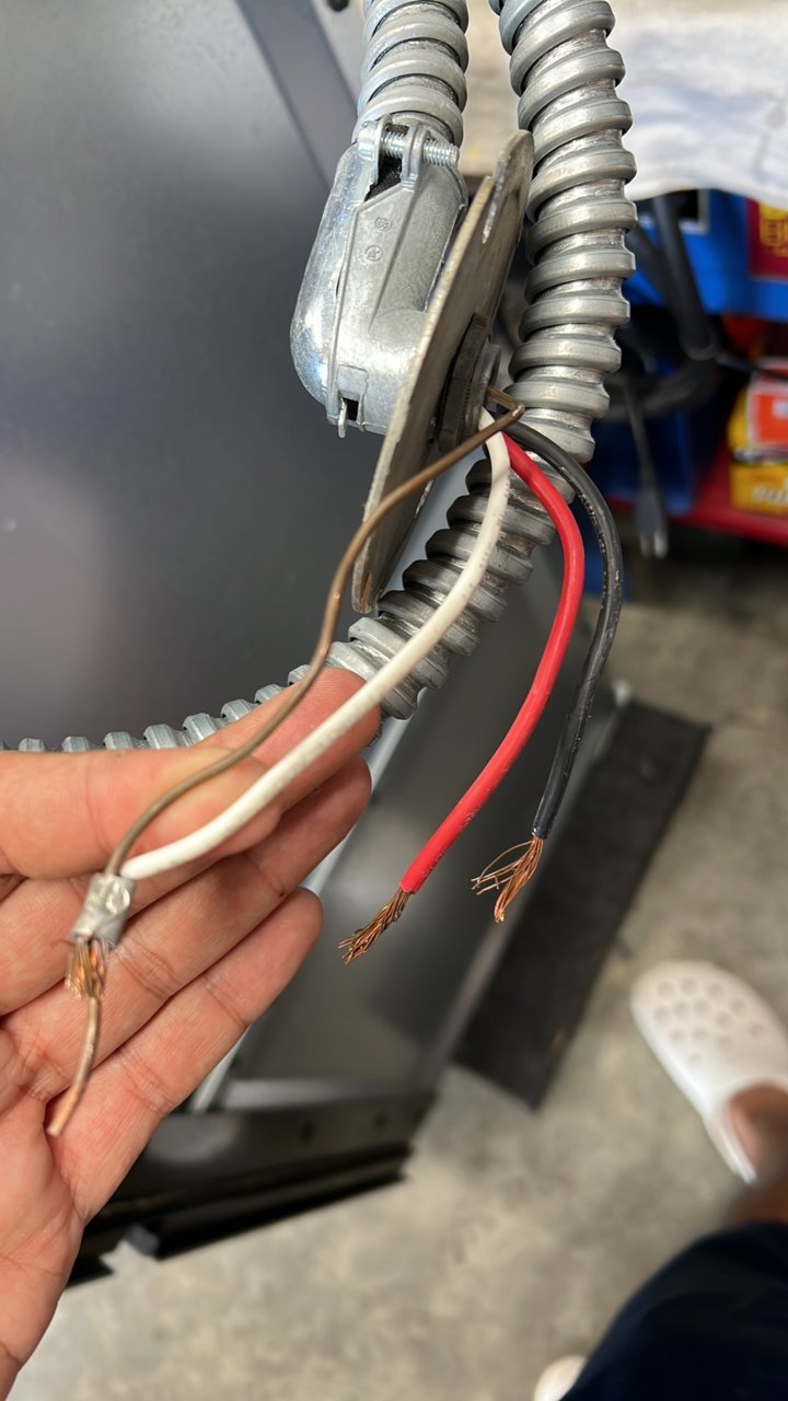

    Inputs as in wiring? Looks like it’s two hots, a ground, and a neutral. The neutral and ground were bond together in the original installation before I picked it up. The wires going to it seem like a very small gauge which surprised me.

    Inputs on the oven itself, not the wiring in the wall. If it was bonded N -> G in the range itself, I would have to look at the schematic. You'll likely want to have an individual ground and neutral conductor ran to the unit, but hard to say for sure without a manual/diagram.

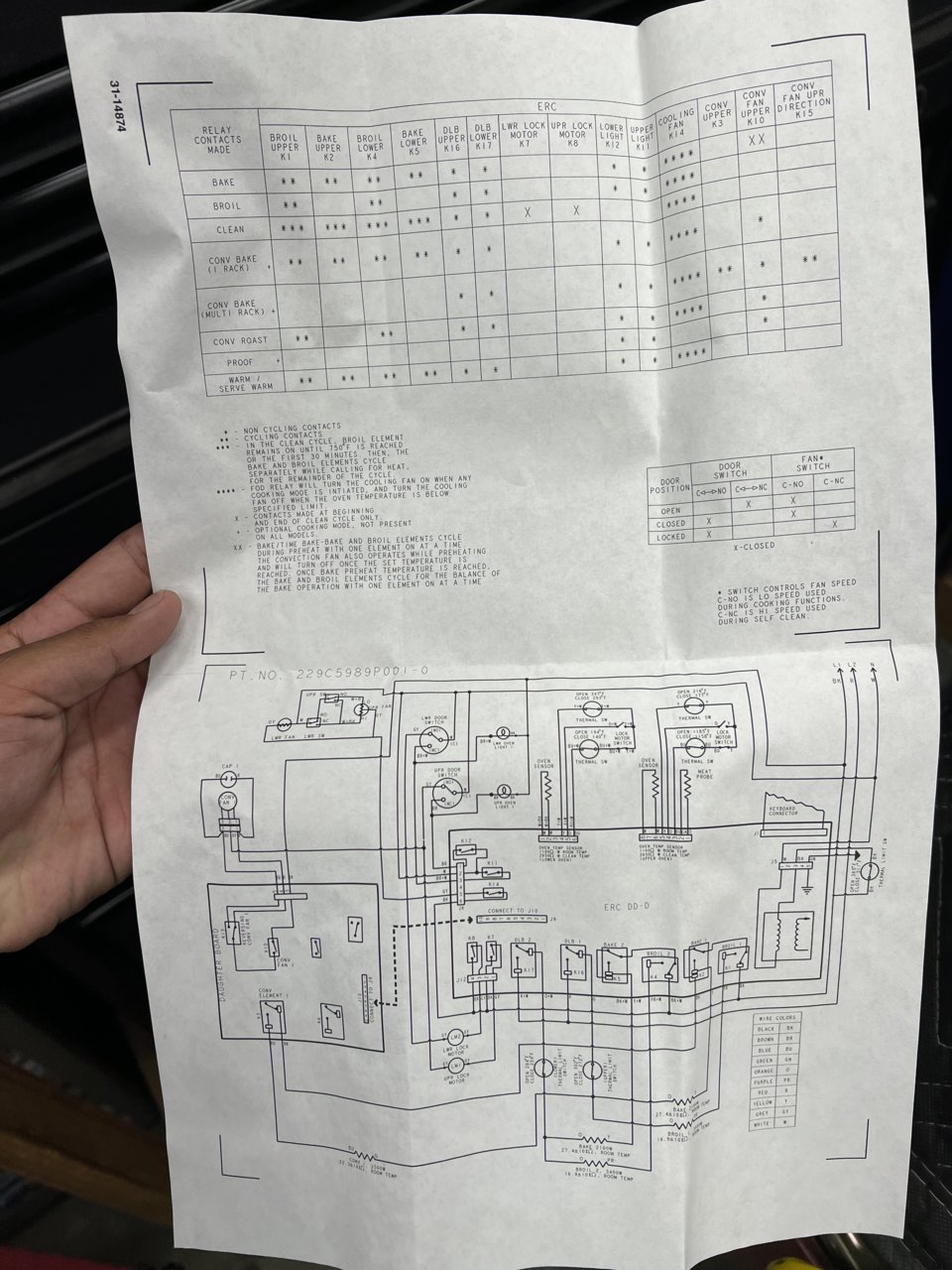

    It’s no issue having to run an independent ground and neutral to the oven, since I have that in the wall right now. I’m just concerned if I need to run thicker wiring in the wall, or if I’m okay just swapping the breaker and outlet. Let me get you the schematic.

    @Gen1FTMFW

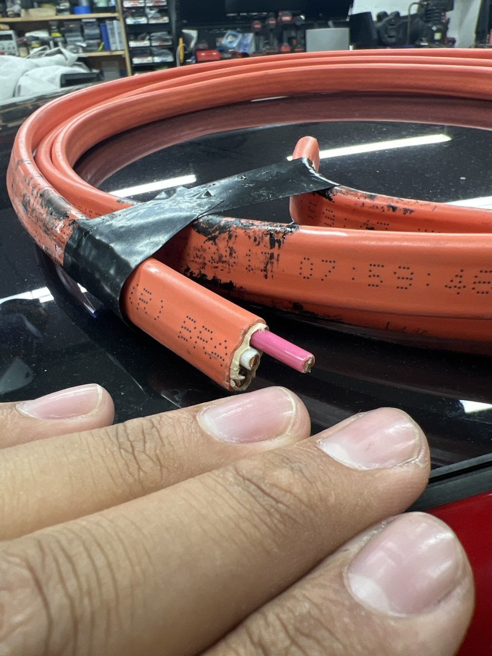

    Looks like it’s 10GA, it’s what I had the sparky run when they did the 30a circuit for my air compressor. I think orange means 10GA. It’s a very short run. Less than 5 feet from the NEMA 10-30R outlet to the panel opposite of the wall.
    The schematics
    70625BC9-6221-4998-94CD-75FC8AF5DABE.jpg 725F03FD-DFBC-43E4-8AE2-91B798E5C643.jpg

    A little blurry trying to view through phone, but looks like it's calling for L1, L2 and N (black, red, white). Doesn't call for a ground, but likely needs an equipment grounding conductor that ties to the frame not included in the schematic that I can see. What is the distance from the breaker to the range and what is the desired use (i.e. do you plan on using it for more than 3+ hours at a time)?
