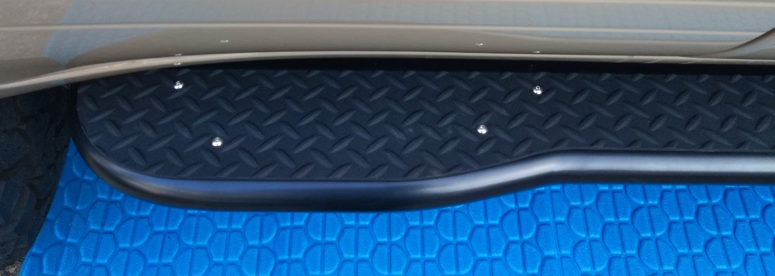

    Did you make fillers yourself? Looks nice and I'm not usually a diamond plate person

    Nope. Came from WKOR with them. The hardware has been outdoors for 2 years and still looks like new.

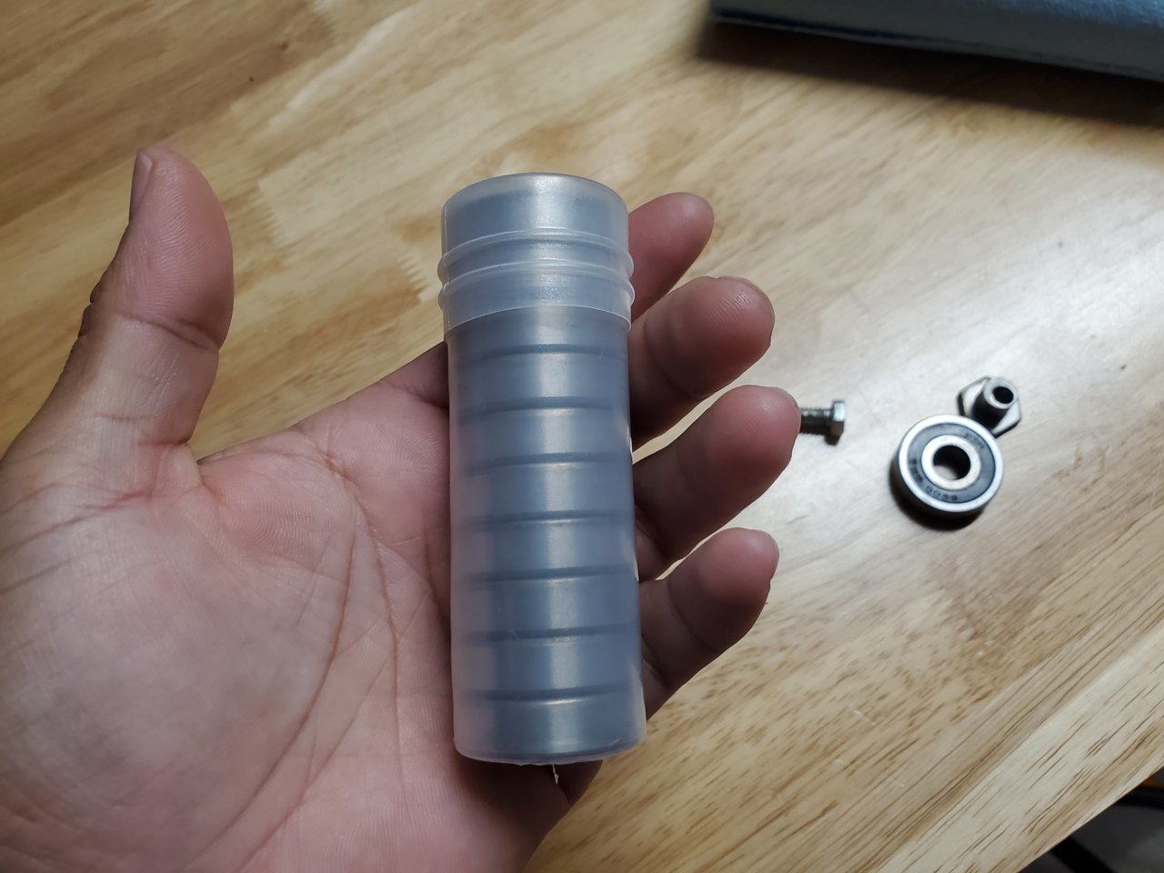

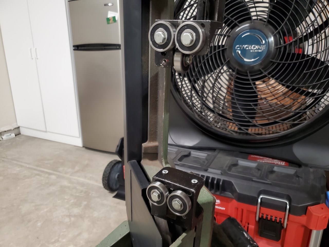

    @Abeyancer
    Old cheap bearings replaced with new cheap bearings :laughing:
    At least now they all roll freely.
    Just need to get a new blade but I'm feeling both cheap and lazy atm :burp:

    My horizontal band needs a new drive pulley retainer plate and I've just been too lazy to make it

    Mine doesn't even have a cover on it for the pulley/belt :rofl:
    That and there are some bolts missing for the poor excuse of a stand...too lazy to do anything about that at the moment either.
