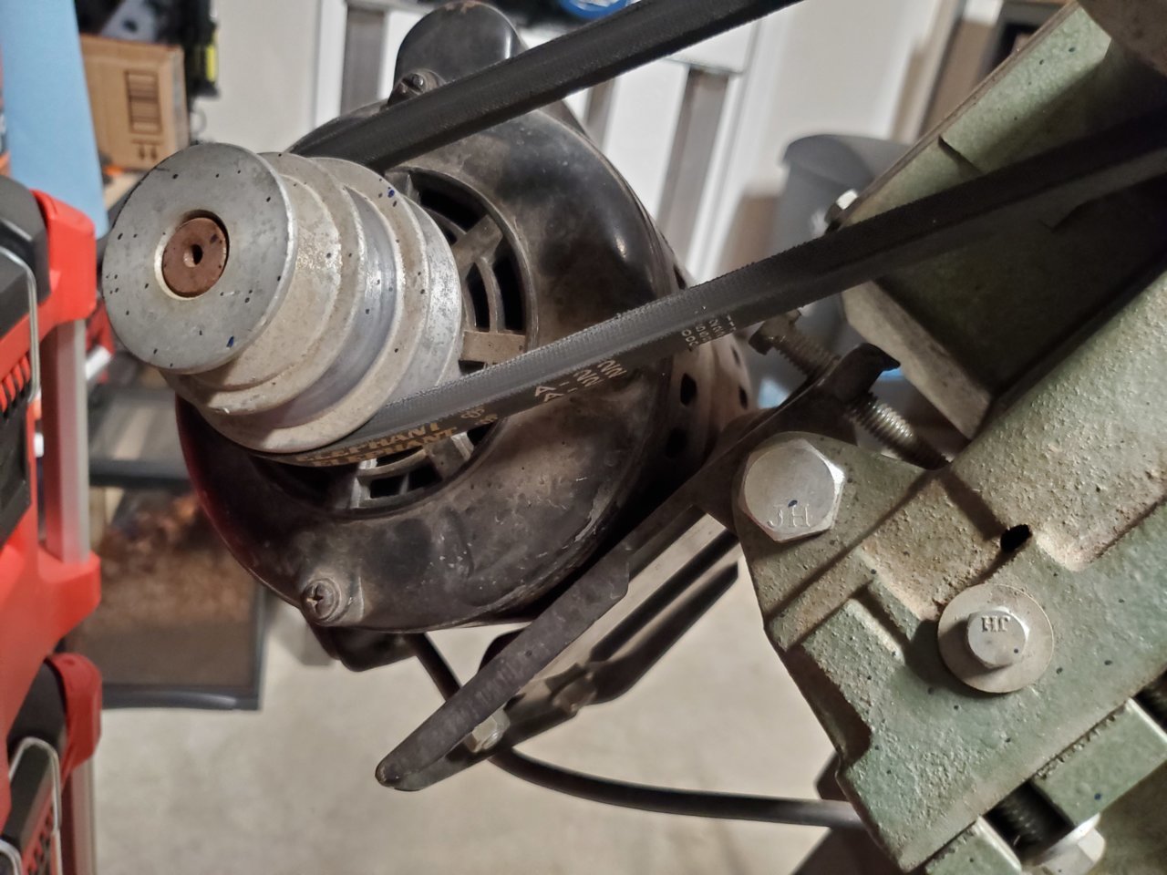

    So far, I'm $26 and some elbow grease all in for this bandsaw and she's cutting nice and smooth!
    Only 4 things to work on;
    1. I now have a consistent tapping with the motor running. I don't recall this noise when I first turned it on so I think it may have to do with it's positioning or the pulley setup. The motor "holds" in the same way my friends HF drill press does - you turn it on and though you hear power going to the motor, it needs manual assisted help for that first turn

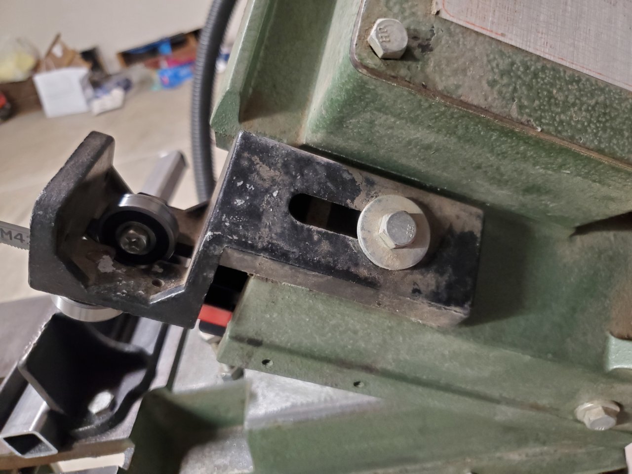

    2. The guide/arm sits kind of cock-eyed so I need to drill and tap it and add some sort of "set screws" that will add an angle/offset and allow the blade to cut square with any media
    3. The legs are made up of folded sheet metal that form a "boxed stand". Bolts are missing so if you push it, it will fall in on itself. I don't know if I want to make a table top using the rest of my 1/4" steel plate for it

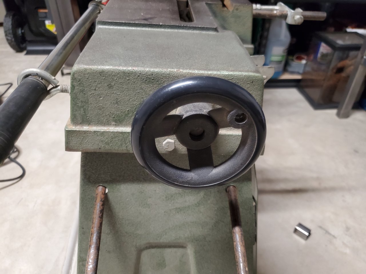

    4. The handle for the "vise" needs a sort of handle attached or welded on, or flat out replaced so I don't have to turn this tiny wheel by hand

    I wonder if that motor needs a new starting capacitor.

    Yeah, I mean the whole setup is over 17 years old and age does a number on such things for sure.
    I just want absolutely minimal investment in this thing. If I exceed $50 all in, I'll simply sell it for as much and just buy a new one.
    It runs, it cuts, but one needs to consider that the motor is old and replacing it will run about $175-200. At another $100 or so I could just buy a whole new unit.

    Pop off the cylindricalish cover on the side and see what’s inside. Capacitors are usually pretty cheap, might be a very easy fix.
