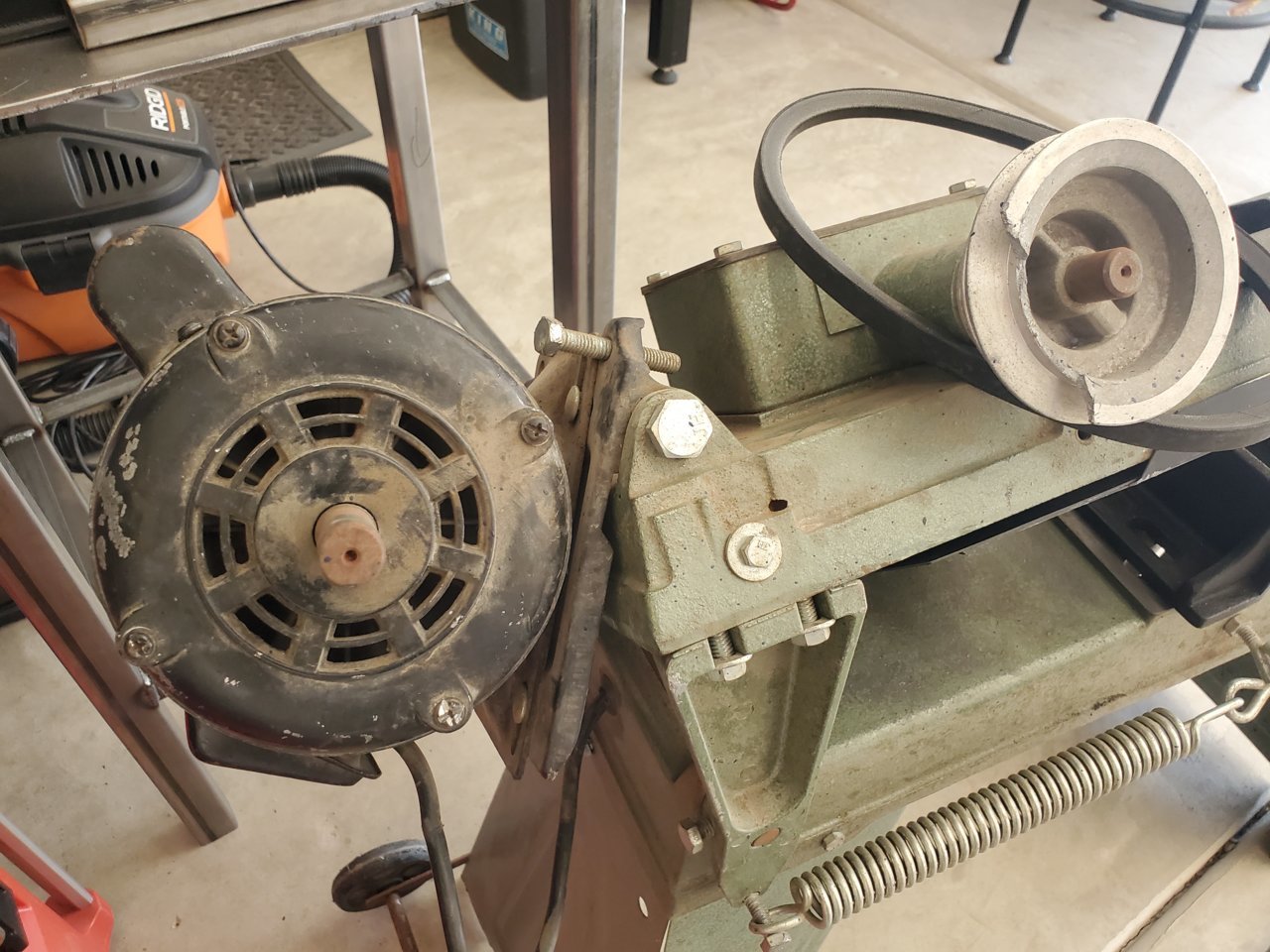

    It's possible those 4 bolts won't come out cause they're the length of the motor and there are captive nuts on the inside of the front face (alot of smaller 120v motors do that to keep all the pieces together) rhey could be seized in the stator due to corrosion
    I would attempt to spin the motor slowly by hand and see if you can feel or hear the click in one particular spot. If you can, then it's most likely the fan and I'd say fuck it. If not, or if it feels kinda grindy then it's probably a bearing on the rotor starting to fail

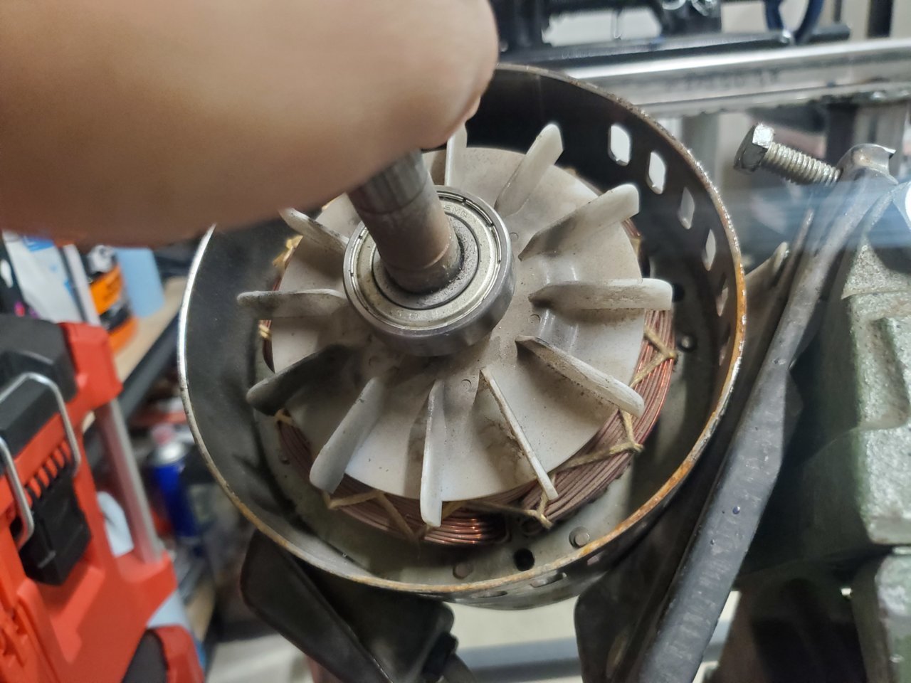

    4 run, 2 don't
    Feels like it's really grinding; resistance (and noise) coming from the back.
    Bearing shown spins freely, nothing up top is making any noise.

    That's the output side you're holding correct? Yea if you're feeling resistance with it like that it's the bearing on the backside. You'll wanna pull the whole rotor, most often it's a different sized bearing but they might be the same front and back since it's a cheap chinesium motor
