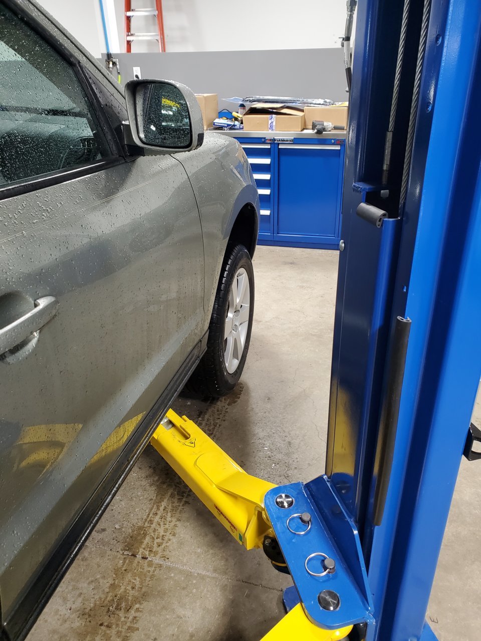

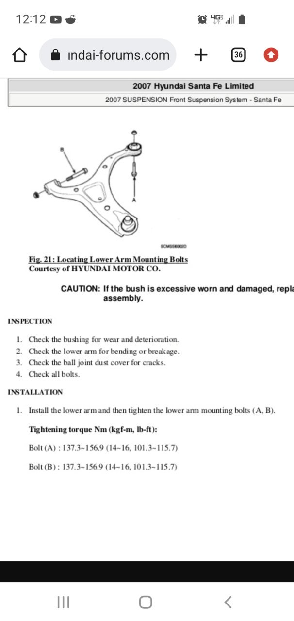

    Fixing the wife's santa fe, swapping control Arma due to ball joint wear. Do I do these torque with the vehicle on the ground or can I use a jack to press up on the control arm until the spring compresses?

    Either one is acceptable. I usually use the jack to just before the car lifts

    Only because it doesn't specify, I'd just torque to spec when installed.

    Cool, I'm using a "be your own mechanic" garage, rent a bay for 50 an hour with full toolbox and 2 post lift.. this lift is fucking life saving lol20221022_101630.jpg

    Smoke break to look up torque specs :rofl:
    Back to it!
