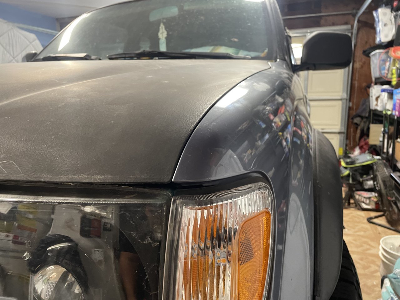

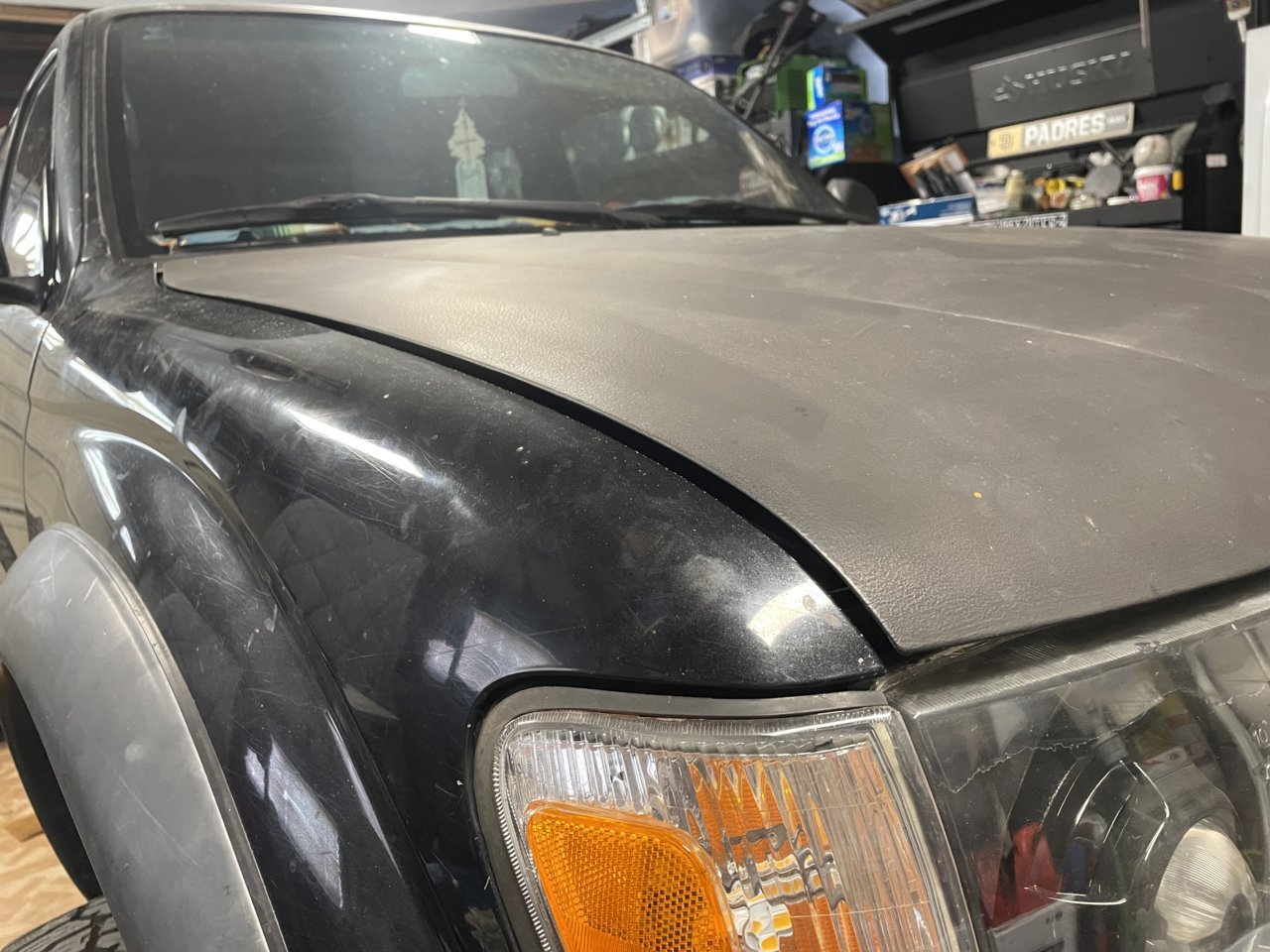

    I’ve always had this problem where the passenger side hood bumper thing has to be really tall almost maxed out in order to for the hood to unlatch when I pull the handle inside the truck. Anybody ever deal with this? Maybe I need a new hot latch mechanism? I’ve tried playing with different heights but if the bumper gets too low the hood won’t unlatch.9E21A86F-0055-4DDE-8DC1-24B213AA1740.jpg62CB018D-88C6-4B03-B815-FD58B4387B61.jpg

    Kind of sounds like your hood release cable is stretched out
    Take the grille off and play with the hood latch itself
    Godzilla619[QUOTED] likes this.

    You can do 2 things that may help.
    Loosen up the latch bolts and push it down a little and tighten it up.
    You can also take some plyers and Ben's the core support up a little where the bumper screws in and back the bumper down a little.

    Thanks @Wulf and @Tour991 for the suggestions! I'll try them out later this week
