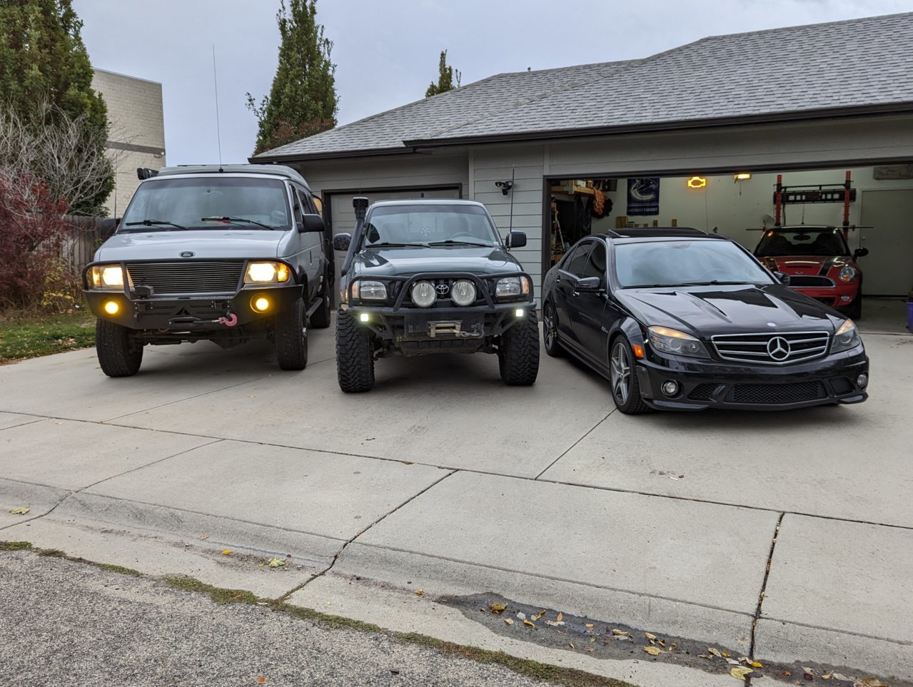

    01x4
    01x4 I know what I'm doing?

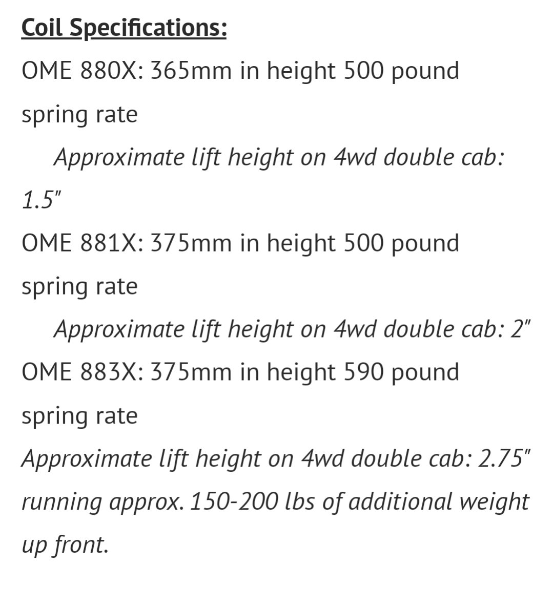

    880s - 882s are all 500# springs with different length, stock springs I thought were 490#? But I can't remember where I read that
    883s are 590#
    This doesn't mention 882s but they're still available
    Abeyancer[QUOTED] and Gen1FTMFW like this.

    Looks like they all provide at least some lift...
