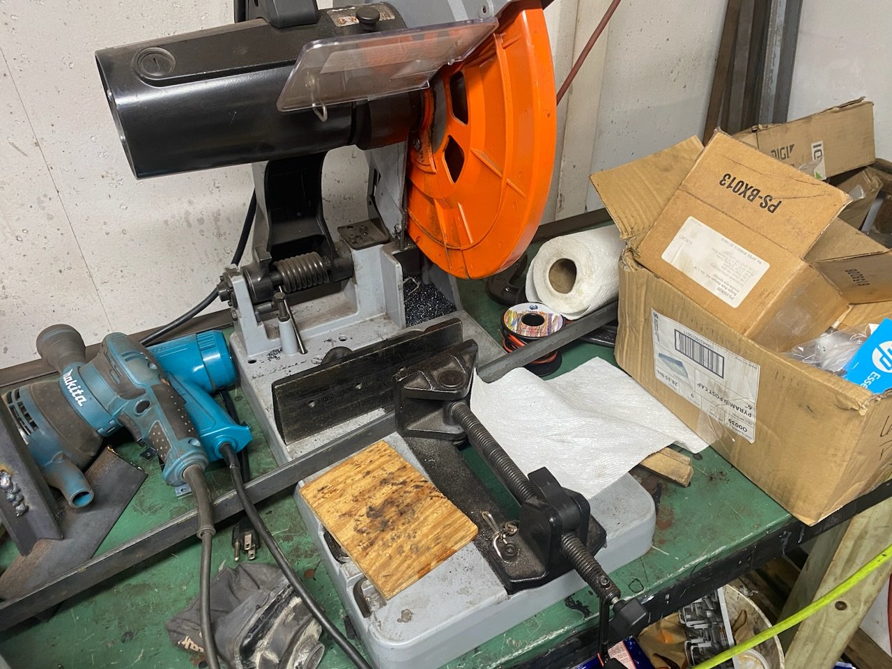

    I hate dust from abrasive saws, but they're also damn near as loud too.
    I opted against one because I didn't like the idea of fine dust lingering for others to breath. Sure I have a respirator, but that stuff sticks around. I don't want my wife and/or dogs breathing it in anytime they're in and out of the garage.

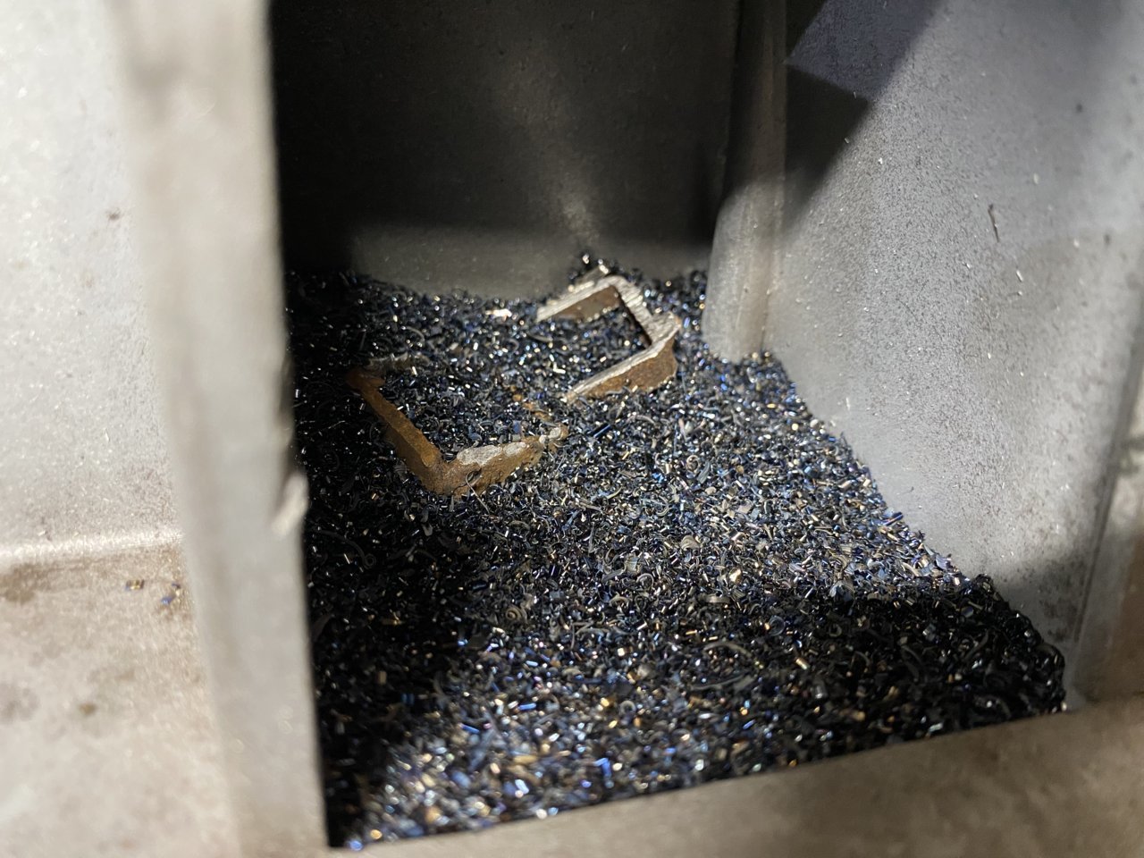

    The cold cut saw lends itself to a cleaner cut, since there are no burrs to hit with a flap disc. I also find the cuts to be much more consistent so as long as I measure my pieces correctly, all my cuts yield the same length.
    The downfall with it though is you get what I'd call "crumbs". They go everywhere even if you put yourself in one corner of your garage, and they're stupid sharp too. Cut some mild steel with short sleeves (not that I do that or recommend it) and you'll feel like you got hit with large metal splinters all over. But because the pieces are large, it's easier to spot and clean.
    I rather sweep and vacuum that stuff up. Would hate for a piece to stab through one of our dogs paws. Every time I step into the garage, Biscuit is quick to follow -

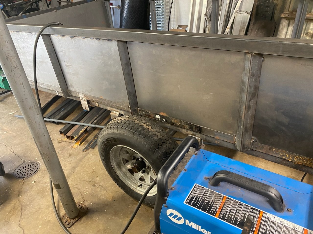

    Nope; need to sweep and vacuum after I'm done.
    You've seen it, was just cutting a bunch of steel the other day.
    So you've got a means of cutting metal? Why use an angle grinder then?
  9. Nov 9, 2022 at 2:04 PM
    0xDEADBEEF
    Mar 2, 2019
    #285037
    19,843
    2000 reg cab 4x4 flatbed MT
    Can cut small stuff, structural members and the like:
    But I’m cutting sheetmetal panels for this:
    So, it’s Grindr or jigsaw.
