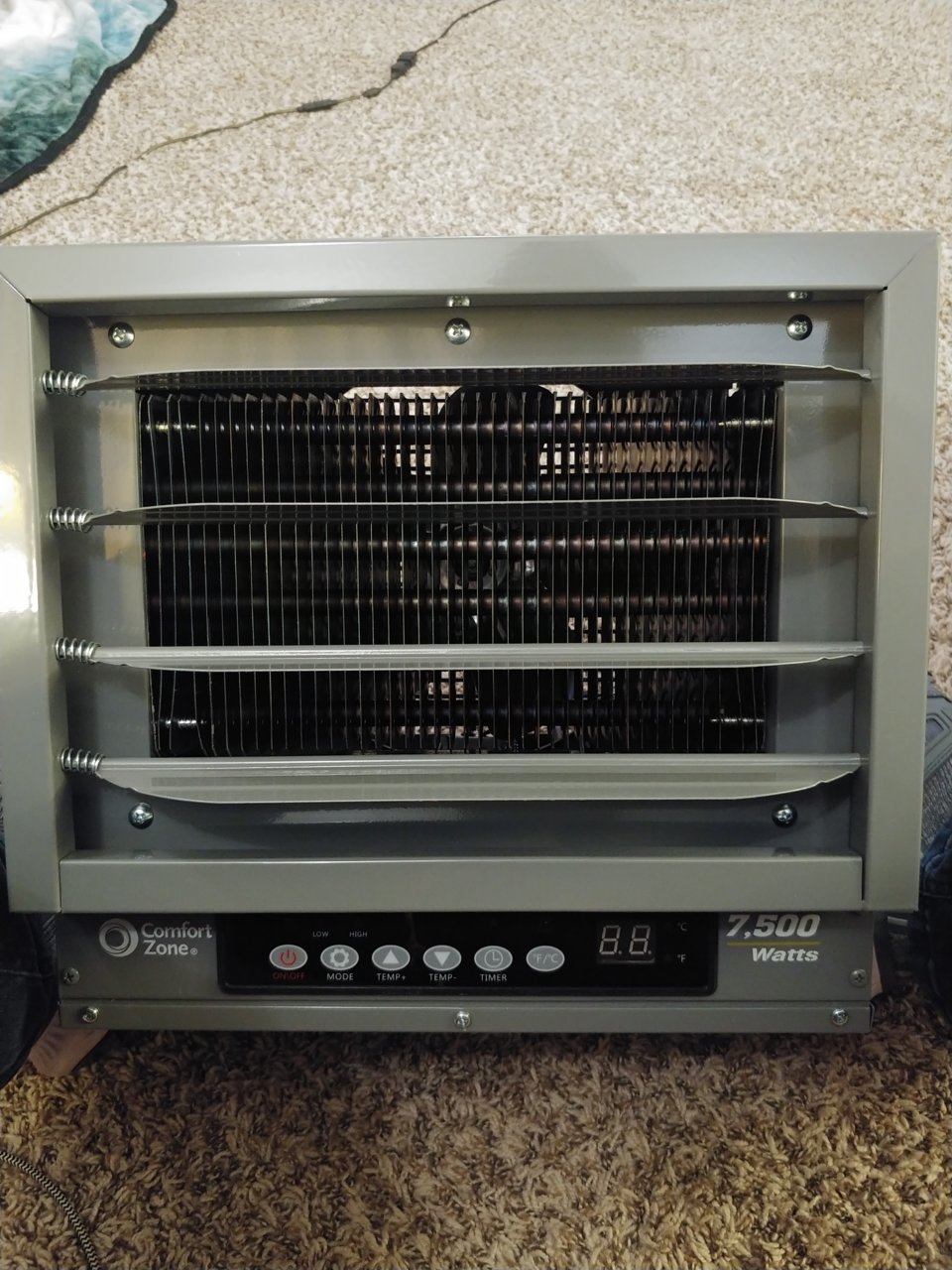

    This unit is what I got to get some heat up in there.
