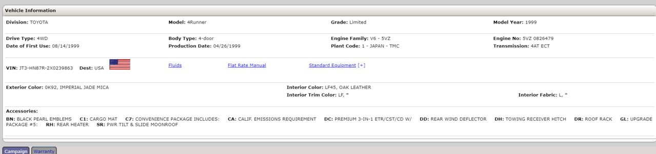

    I beg to differ. My 99 has the center diff lock.

    Multimode you mean.
    Limited only, and a two-model year option.

    I thought the multi mode on the limited was all-wheel drive with a center diff lock.

    Multimode is an option.
    1996-2000 4Runners had a real 4HI/4LO setup only (unless specified like below).
    1999-2000 4Runner Limited only; Toyota had offered the Multimode as an option, hence why there's so few of them. The only difference is that the push-button on that setup would enable "AWD" (labeled as 4WD) and really wasn't in 4HI until you physically moved the lever. Doing this would put you in 4HI the same way your Tacoma goes into 4HI.
