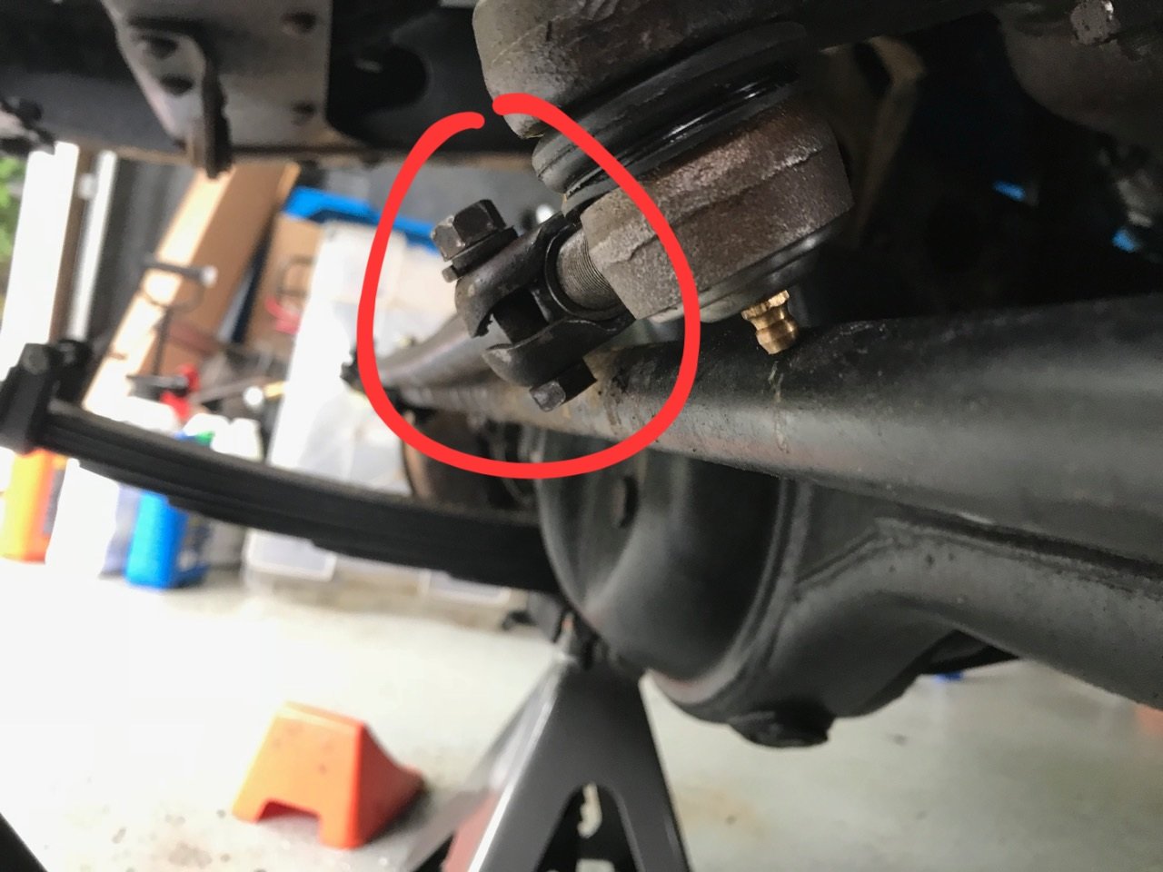

    Yep, everything fits just right.
    It's the tie rod end itself (where it bolts up) where it contacts the body slightly.

    It's less Tacoma and more mod
    Is that tie rod super loose or something, mine looked like it could hit until I tightened everything properly and then it pulled away

    Nope, all well since the previous-previous owner put new 555 tie rod ends on.
    Looking at a random pic online, it looks as if I can undo this and swivel it (even though this looks like a 60 series). Thought it was a permanent piece.
    It's what contacts with the body.

    Oh the sleeve clamp, yeah you can move that
