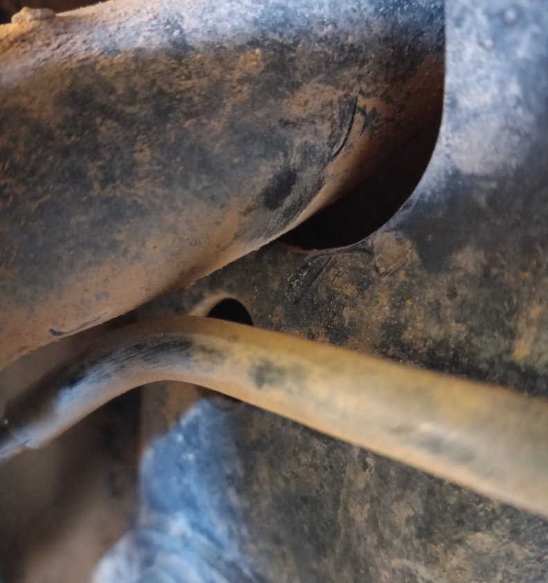

    100 suspension down travel droop isn't limited by shocks or torsion bars. It is limited by the upper control arm resting against the UCA frame mount. This happens on either side.

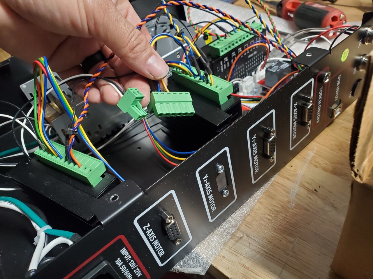

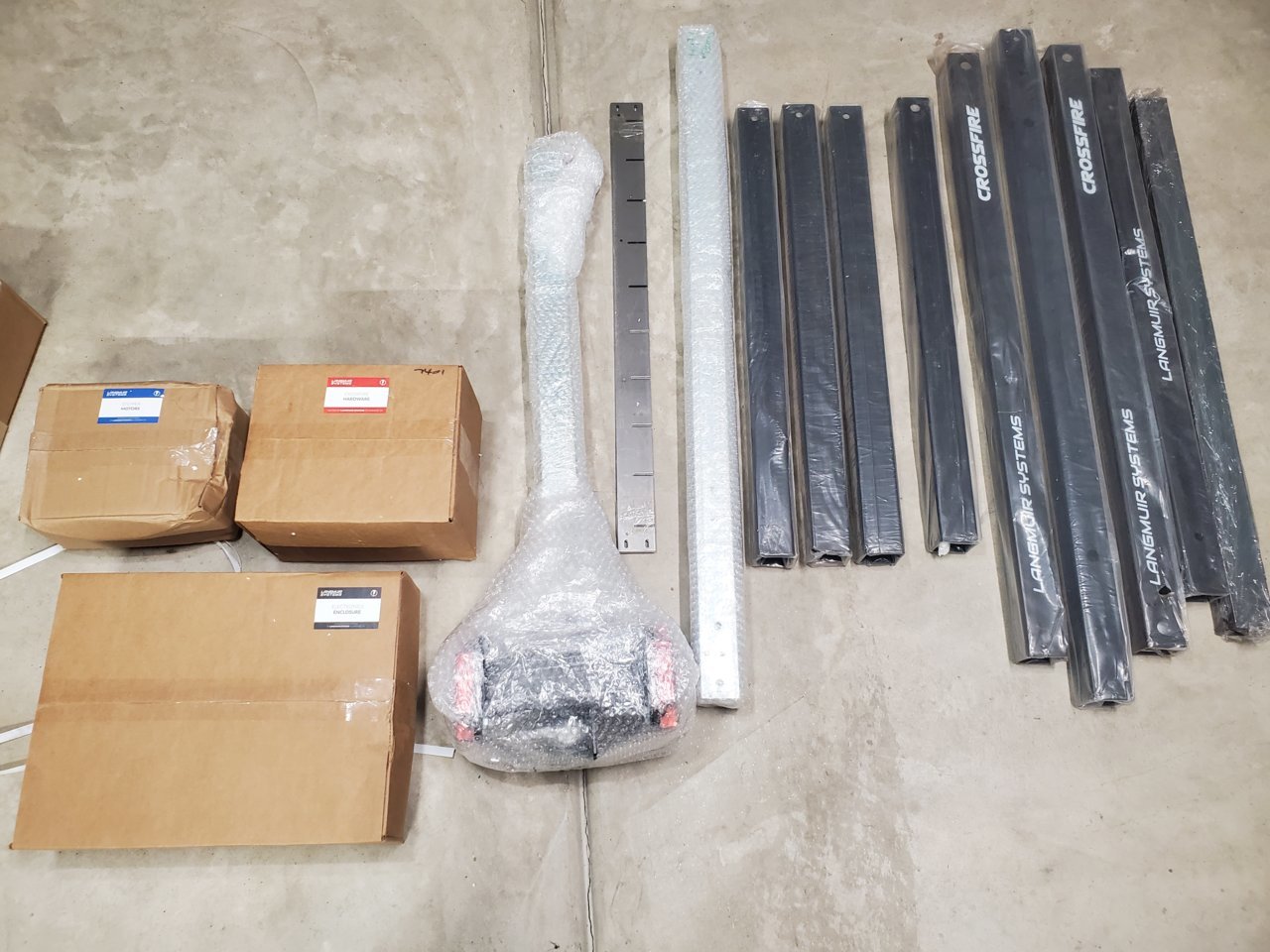

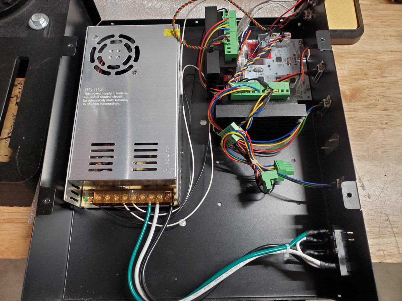

    Ehh..
    On the plus side, everything was packaged well.
    All voids filled so nothing bounced around, straps keeping everything in place, staples kept the box closed up and plastic wrap all around kept it pretty waterproof too.
    There are smaller boxes inside, all labeled for ease of assembly.
    After removing the gantry, you've got the remainder of the frame assembly packed below.
    So here's the Crossfire in its entirety.

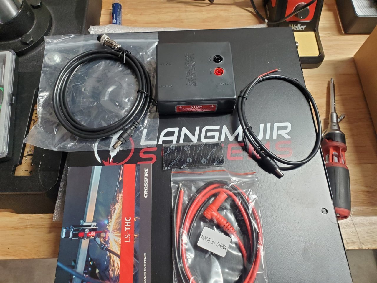

    My THC Z-Axis upgrade kit did ship at the same time so at least I've got one of my upgrades.
    The water table just shipped today but even then, I still need the XL kit to ship and deliver so I can begin assembly.
    For the meanwhile I figured I'd install the Z-axis kit.

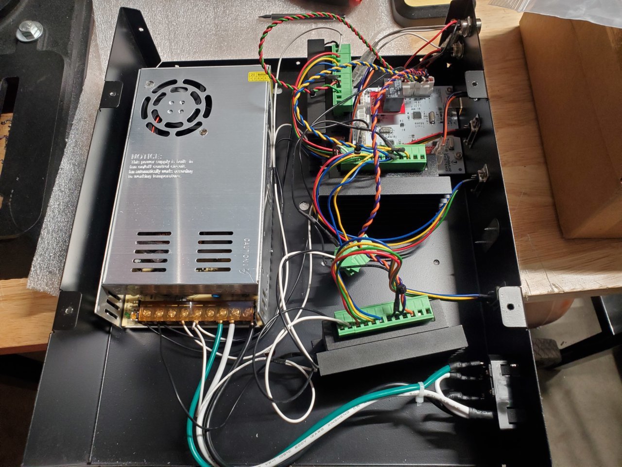

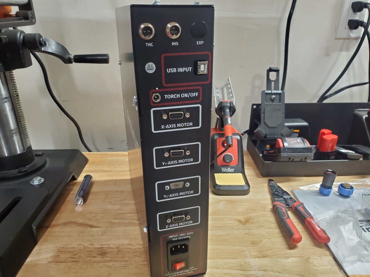

    The electronics box gets opened up and the upgrade gets installed.
    Shitty thing is, I seem to be missing some hardware. Two nuts and bolts really to mount this to the control box but it's all plugged and wired in now.
    I'll head to Home Depot tomorrow to grab some hardware but because those were missing, I'm assuming I'm missing a cable as well.
    The CUT60 comes with a CNC plug and a DVI input cable and torch signal cable get soldered to said plug. I've got the DVI input cable which just receives the divided voltage signal to tell the torch what its height should be while cutting.
    I seem to be missing the TORCH ON/OFF signal cable but this is based off a user's install on the Pro table.
    I'll give it until Monday to confirm if this cable is needed or not for my setup.
    EDIT:
    Correction; not missing a cable.
    Apparently, the banana plug cabling is used to tap into your machine; the barrel plug I assumed I was missing is purchased separately and is used for a clean install and get all signaling from the CNC plug itself.
