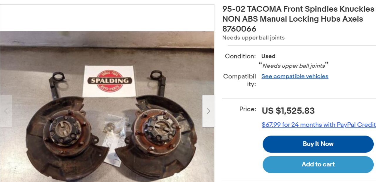

    It's less Tacoma and more mod
    Area51Runner[QUOTED] likes this.
    But I also can't imagine wanting manual hubs for any reason

    Stop. Please.
    Ever since I read about Greg doing his PreRunner conversion and going the ADD route, I am so tempted to switch over. All I would need to do it is order a set of bearings and the seals. Have the spare knuckles, ADD hubs and OEM Green CVs on hand. Would just need to pull the front diff, bolt back up the actuator and tube and reinstall. Oh and run the wiring for the rocker switch.
    Must resist... I am done, don't want to rip it apart again. :rofl:

    You've already got your setup and I doubt you paid as much as that or even half that for it. I wouldn't trade unless you're going to start wheeling in a more "spirited" manner haha. Manual hubs are totally fine, ADD is just more stout, especially if you remove the ADD part and just run the manual hub diff tube with add spindles and CVs, that's as simple and bombproof as it gets. My point is I just wouldn't ever pay more for manual hubs over ADD, its kinda like paying more for a small beer rather than less for a pitcher.
