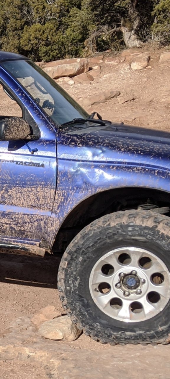

    I got a crinkle fries fender
    jubei and Das it mang like this.

    i got a dimple on mine from the UBJ when it tried hitting the stratosphere upon removal . adds character

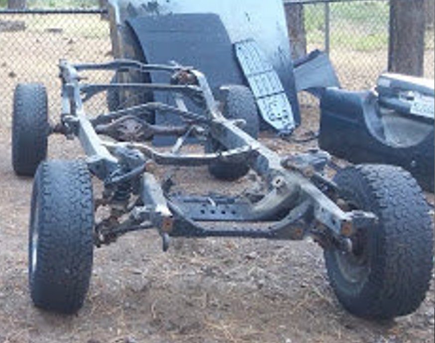

    Not the best picture but you can kind of see how my 2wd frame was

    That actually does help alot thank you!!! looks level with that lift in the front, u had 6 inches with the spindle and downey lift, iirc, right??? It'd prolly settle more with a bed, did u add any additional leaves?

    It was a 2wd leaf's witch have a higher arc, fabtech shackles and it cept the truck level with the Downey kit and spindles up front. No Bro lean.
