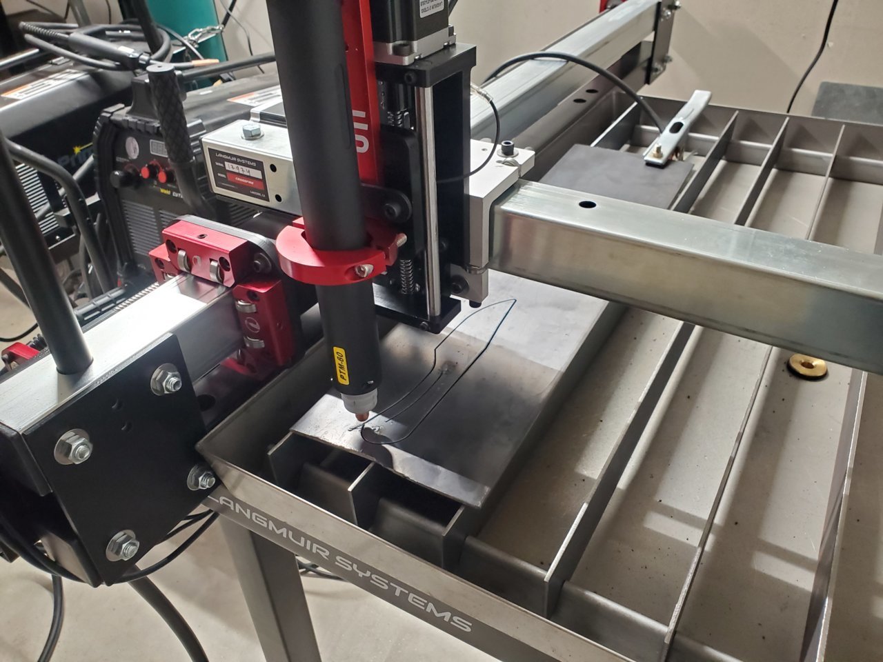

    Case you missed it, got my CNC plasma table going.
    Just not cutting anything until I get my water additive in so I don't go cutting into my water table.
    Plenty of electrodes and tips (different sizes) as well as metal on hand for several projects.

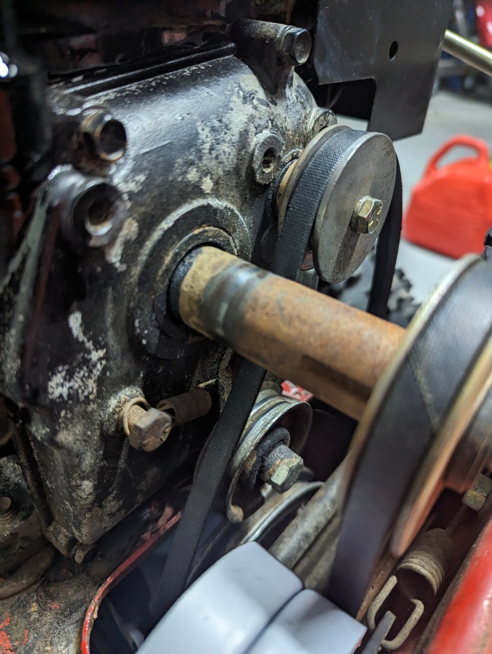

    Can you help me, this seems routed wrong and I can't figure it out lol. Belt is same size as old one but I forgot the before picture. Looked at a half dozen YouTube videos and none of them have this exact setup. I'm inclined to say the idler is configured wrong but idk. The little door spring on a bolt is odd, it takes very little resistance to move. over and under doesn't seem right

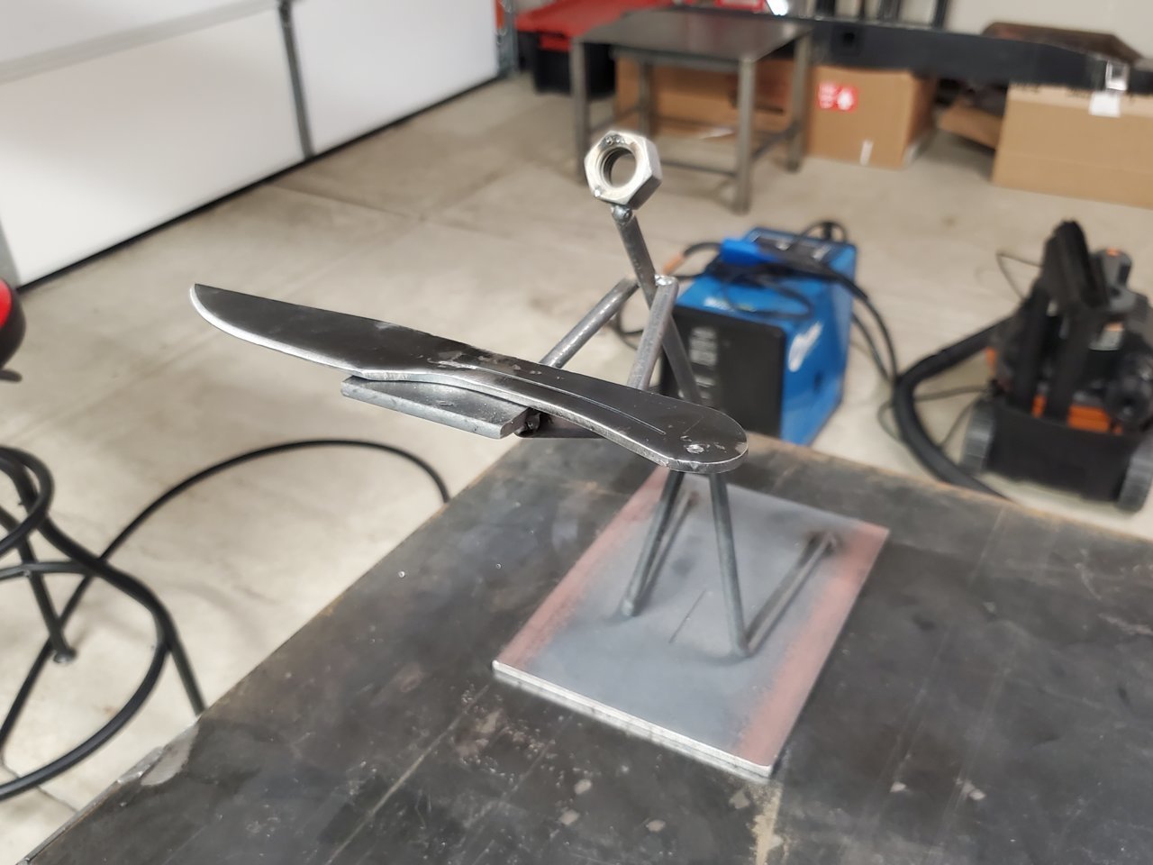

    Look at this guy!! All tech'd out! Looks awesome! Im sure you wanted to make some type of gun item but knife seemed like a more logical start. :rofl::rofl:

    Basic shape, wanted to work on a file that was simple to start.
    Learned about smoothing for accuracy, torch cut speeds, where cuts start and end, and how outside cuts go counterclockwise and interior cuts go clockwise, and more.

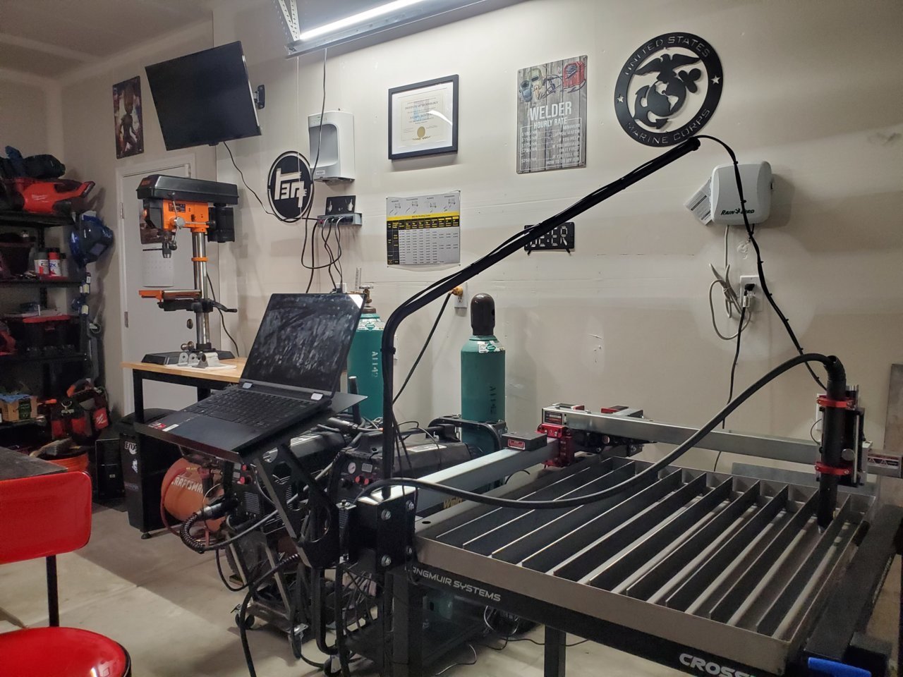

    Yeah, I heard the torch speed is hard to dial in at first.The 2 other people I know with tables use fusion. The cuts seem really nice for that thick of metal. How much are you into it for running?

    You mean total investment, or if I've calculated cost per cut?
    I need to check power usage but keeping at 220V and running 1/8" or thinner I could keep it at about 0.20-.25 per inch, thicker like 3/16" or 1/4" will run upwards of 0.35-.45 an inch.
    Will add a flat cost to already made files for 'clean up' and post processing.
    Will be more of course if I'm having to make/recreate a part like I am with these mounts I'm working on.

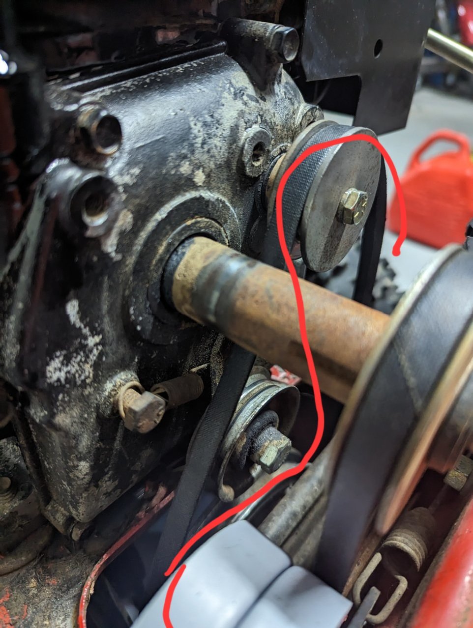

    Although it looks like it's been riding over for a long time (given the clean mark on the crank)
    If there's not enough tension those springs do get weak over time. The hook on a shitty extension spring over a bolt is actually stock lol... depending on how rusty/brittle it is you may be able to get away with bending the hook more, to make it shorter

    That's the confusing thing, if I route the belt that way it's pushing the spring and not in tension

    Can you take a pic from the other side of the crank so I can see the idler arm? Also a pic up the handle showing the cable and drive engagement lever?
    Is that belt your main drive? I've only ever seen that pulley on those snowblower used for reverse, not drive

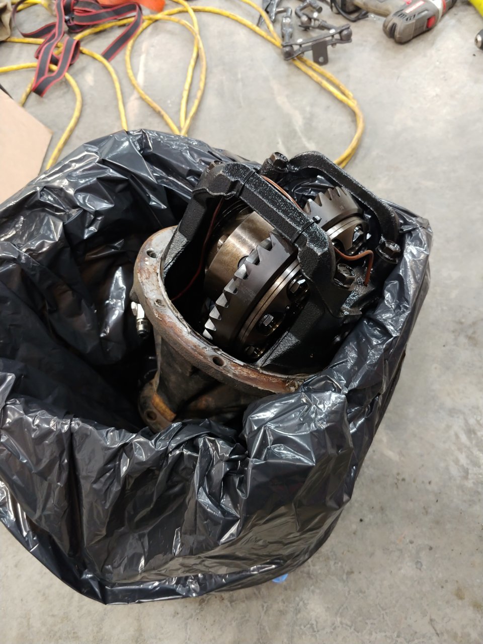

    5 gallon bucket; this is what I mentioned @Ozark_RegCab as to how most people ship their 3rds

    $700+ for plasma cutter (I got $70 off, military discount)
    $1,650+ for basic cnc table ($2600, because I added multiple options)
    $300+ for machine torch (optional, $30 off, military discount)
    $$$+ for air compressor (got mine free, I know you have one already)
    So for me I've got $3,600 invested so far before the extra consumables I purchased. That's another $110 alone.
    For someone else buying into it, I'd expect about $5k for a small basic setup.
