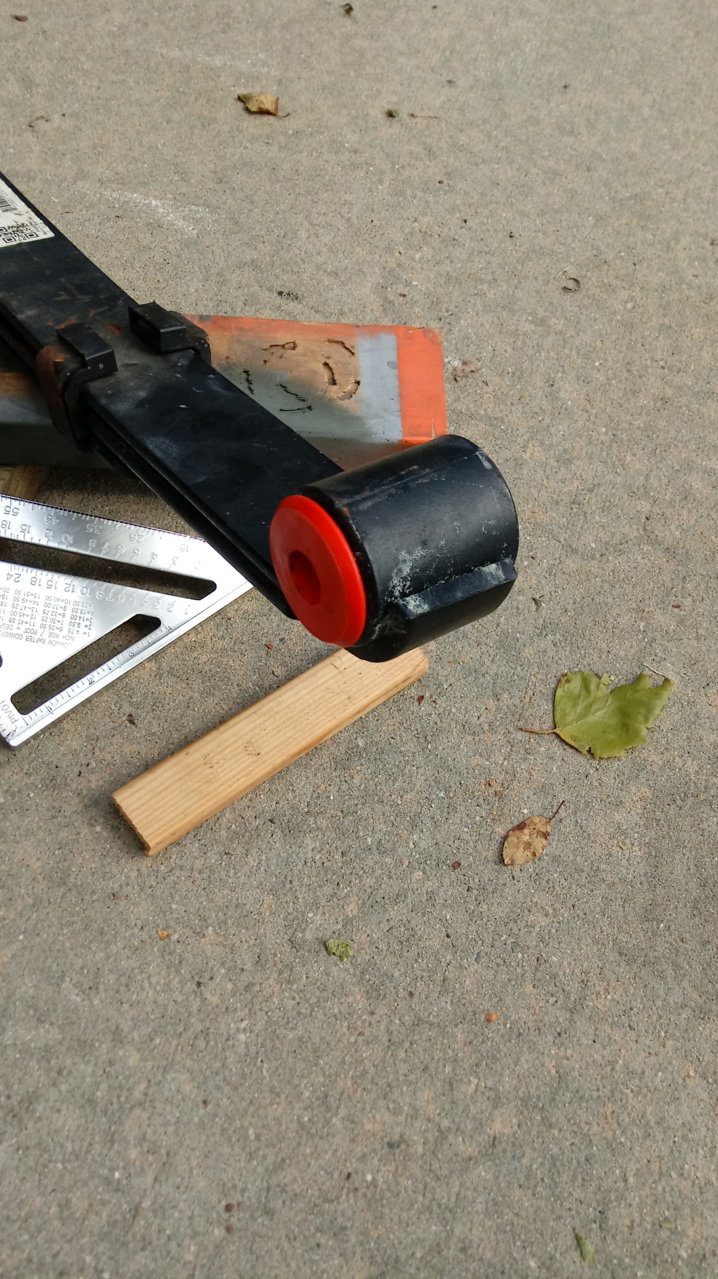

    Squeaky. And I need axle shims.
    So this is weird. I bought aftermarket springs from SD springs. It turns out, they use a different size bushing than the oem springs. The energy suspension bushing fits perfectly snug without having to remove the outer sleeve. 1015181329.jpg 1015181329a.jpg

    Have you considered greaseable shackles?

    Shackles arent the issue. Ive regreased them before. Still squeaked the minute I reassembled.

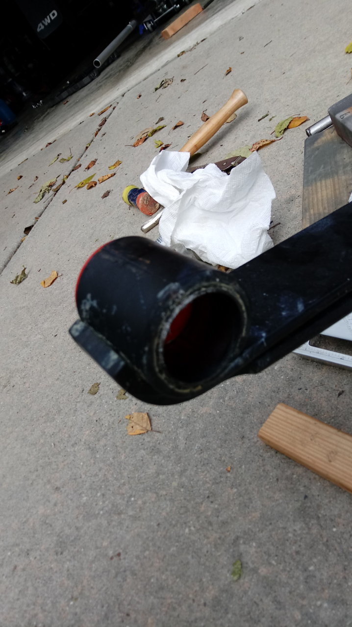

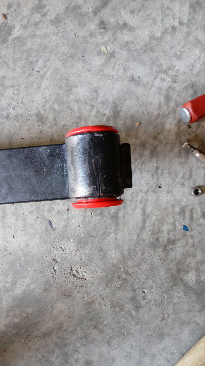

    So, the bushing fits. But for some stupid reason, I cant get it in all the way with the stupid sleeve in. They fit fine, without the sleeve but decided they didnt like the sleeve when I put it in. I would leave it like this, but it wont fit between the spring hangers up front. 1015181411.jpg

    Cant hammer it in?
    Or just cut it a little shorter

    How do you get it back out?

    Can you pry the spring hangars apart a little somehow? I know they're pretty beefy but if it's a matter of a couple MM's or so it might not be too hard to do. Otherwise grind/shave off a bit of the outer lip of the bushings maybe?

    I just use a knock out and pop it out

    just saw this photo...yeah it looks like those bushings are a bit too long if that's as far as they go into the eyes...might have to trim them

    Thats alot of force to make it bigger

    yeah I'm thinking he might have to trim the bushings after seeing the other photo...mine fit snug up against the eyes, they didn't stick out like his do. I used the Daystar bushings

    Its cause they're in a diameter too small and when compressed cant expand outward now
