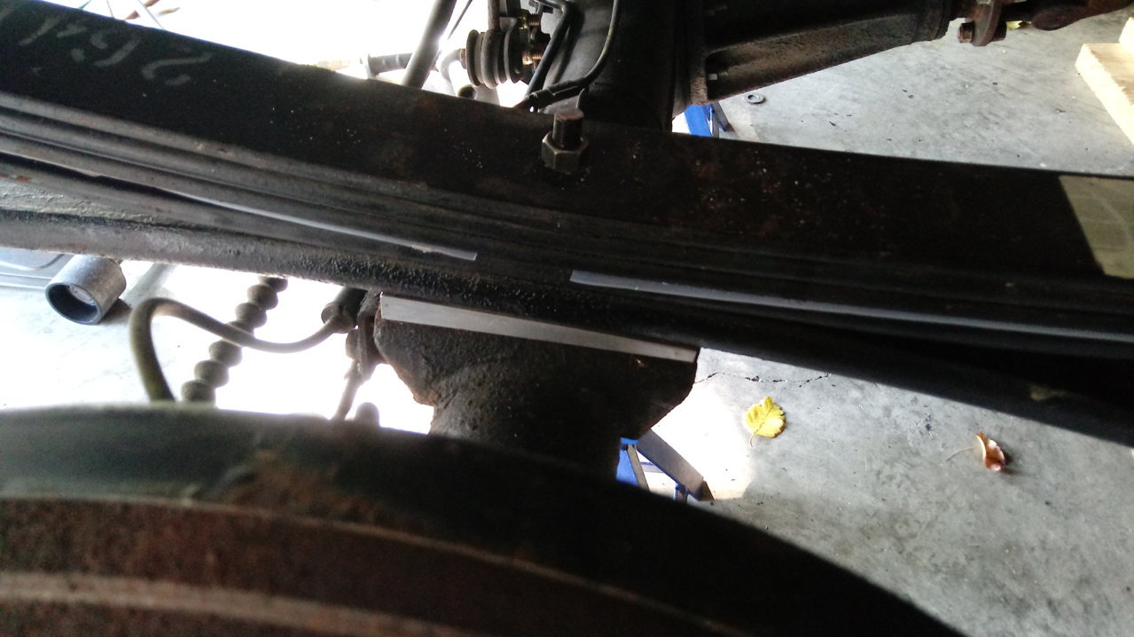

    Pinion angle is being taken care of with shims. Ones metal, ones plastic. Wont matter as I put Teflon liner in between the leafs anyways. 1015181602.jpg

    Isn’t that pushing the pinion down how thats setup. Dont you want it going up

    Skinny side to the front. Look at the diff.

    That setup up would be pushing it up.

    You right. I confused myself

    Hmm, so artistic. The placement of 2 leaves in your photo while working on your leafs. ;)
