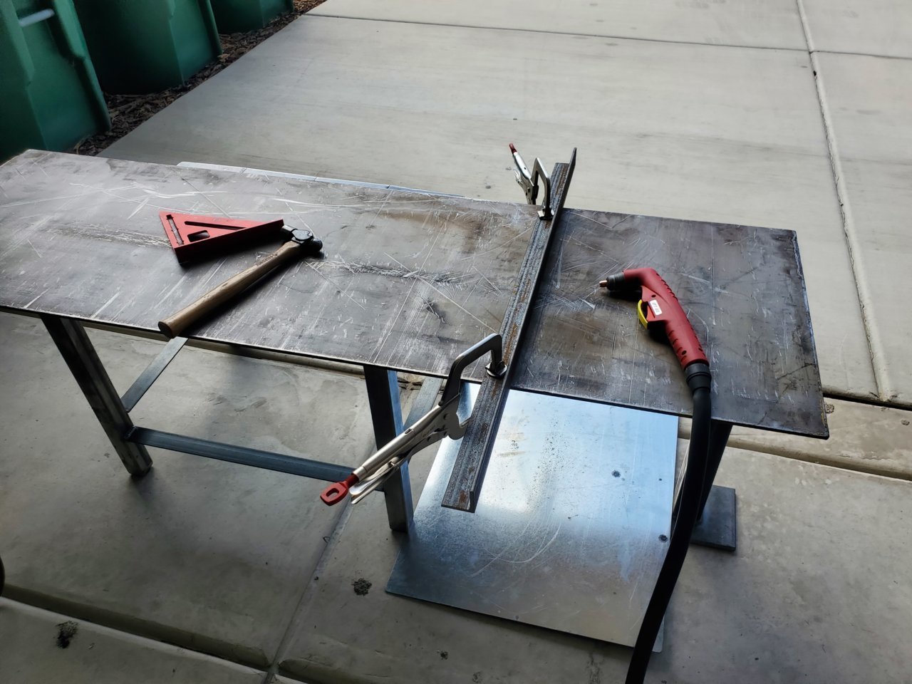

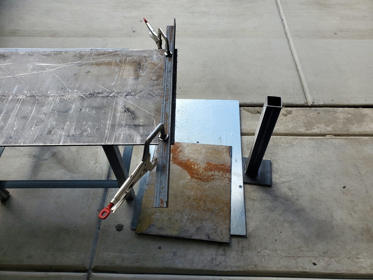

    You don't need a table of water either.
    I just cut the suspended parts off; be sure to either have something holding the other end or soften the landing for when it falls. I remember just holding the edge of the piece as I finished the cut to lay it down gently.
    This was 1/4" thick mild steel.

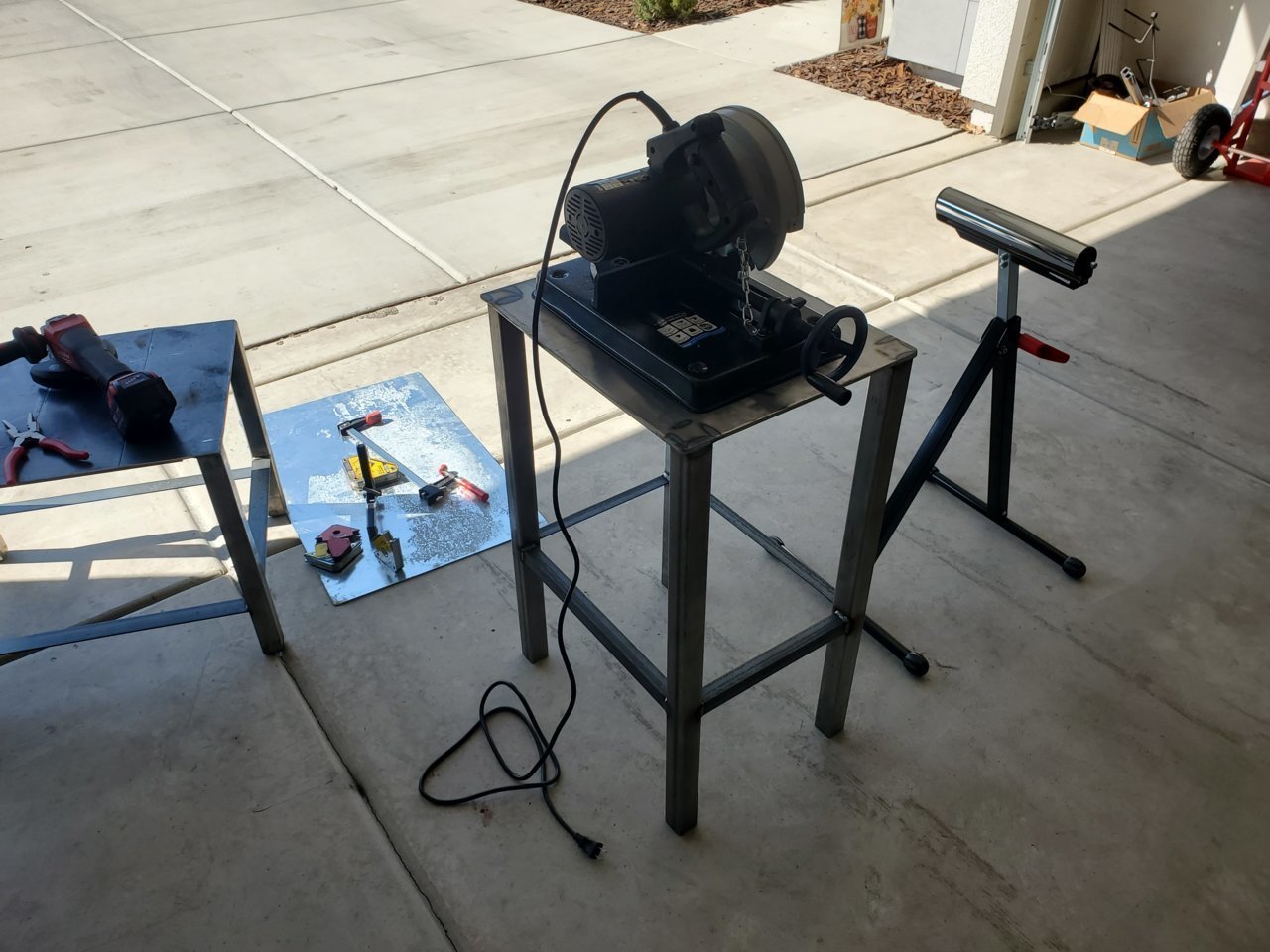

    Used it as my saw table.
    Still got plenty left.
