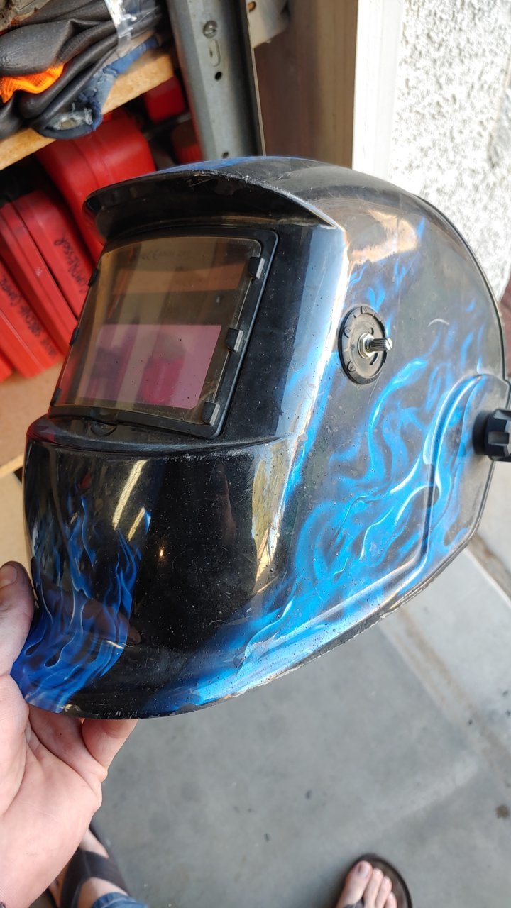

    @Kwikvette this might be a dumb question, but is it normal to not be able to see a damn thing through an electronic welding helmet aside from the arc? I can never follow my joint without stopping every half inch to make sure I'm going the right way

    Depends how sensitive your eyes are; do you have blue eyes?
    I have both my hoods at 9 1/2 when I strike an arc. I can see several things close-by in my peripheral but really I'm never looking anywhere else except my arc.
    But are my surroundings completely dark? No they're not to the point where I can't see them.

    What shade is your helmet when it's darkened? For most lower amperage stuff (sub 180) I use a 9-10 shade), when it isn't darkened its a 4. But if I turn my helmet to say a 12.5 I can't see shit but a dim puddle.

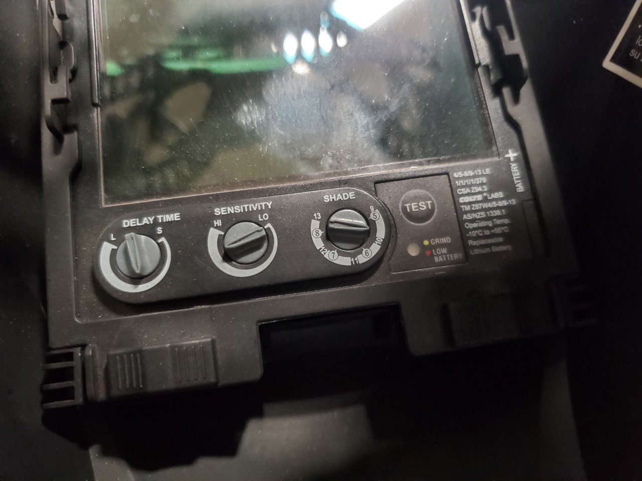

    I do have blue eyes, but it's more like the helmet doesn't have any variability. It's either shade or completely black, there's no in between. I'm in my driveway in daylight...

    What hood you running?
    Is your lens clean and clear? If not, replace it.

    9.5 is really the only place it darkens. Anything higher and it's just the off state and I go blind

    Idk some high rated one on Amazon I got years ago

    It's probably because you're outside in bright sun and have a ton of light bleed. Might need a cloth around the back of your helmet then cause at 9.5 you should see the arc fine

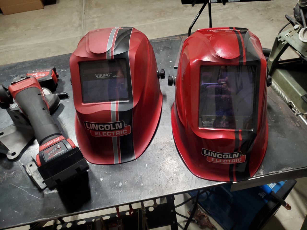

    Replace it, your eyes are worth more.
    These are my 2 hoods and my settings.
    I do my welding with the garage door open and get plenty of sunlight from time to time; no issues.

    Then again this is why pipe welders run different hoods than ours.

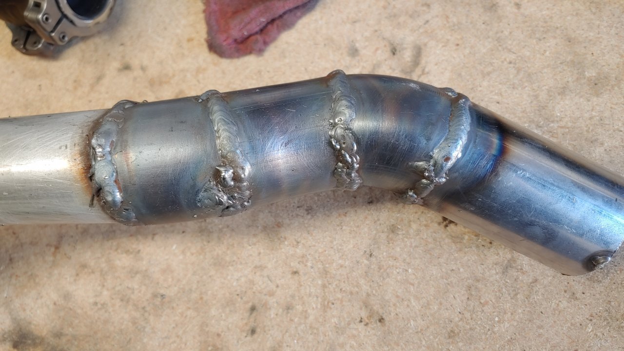

    The inconsistency of my welds is rediculous lol
    Out of nowhere it will be perfect, or burn a hole straight through *ugh*

    Gaps will do that; fitment is absolutely key here.

    I think I will. I've long suspected this one is defective
