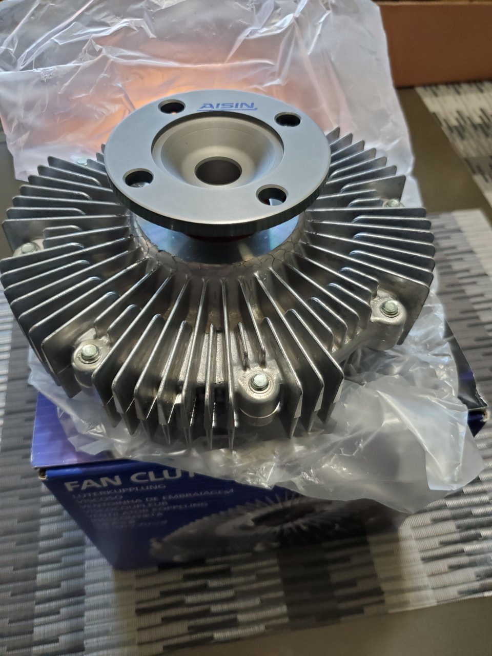

    I think the DC tow package fan clutch is more aggressive than the standard 3.4l fan clutch? dunno brain is too smooth to remember anything

    I think I've heard that before too....two smoothbrain confirmations are better than one
    the big difference is the trans cooler right? Never had to worry about one so not sure

    There's a colored band on the fan clutch assembly. Orange and green are the two variants.

    I'll add some water brain. If the truck had a tow package from the dealer, they got a "heavy duty" fan clutch. I think they were green.

    Yes green is HD, just want maximum coolin

    I found the green to be far louder than my stock orange. Truck roars at low speeds.
    I never towed with the orange so no clue if it made any real difference in stuff like stop and go traffic.

    Green one is the one you want.
    I had put one in the 4R.

    The first time I drove my truck after the e-fans were removed and stock fan clutch put in, it scared the shit out of me sounded like a semi truck coming my way. Totally not used to it

    It "locks up" at a lower temp so it'll start spinning sooner than the orange one hence it being louder.
    I never towed with the Tacoma but did with the 4R and in general, the 4R was cool especially after throwing in a new thermostat. That's saying something considering a 4R runs just a tad warmer than a Tacoma (all things being equal).
