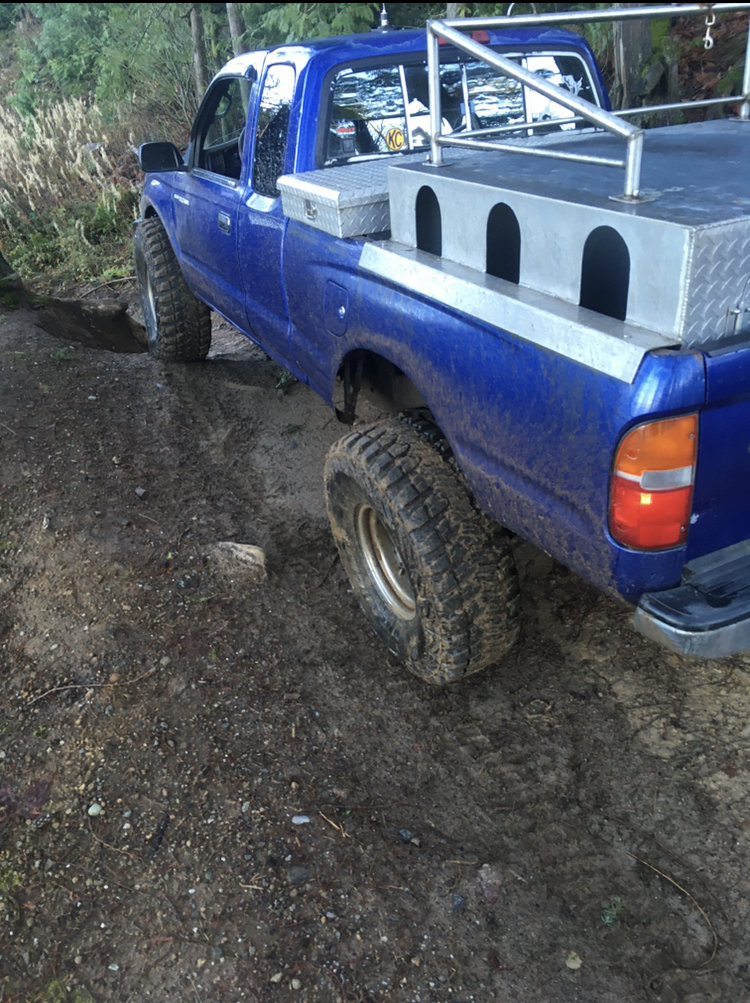

    7739F9DB-1275-4F42-A0C0-849AE00F3D68.jpg Going through the bed isn’t an option. It’s my hunting truck for my hounds and they need the room.

    I have a D44 from a Honda Passport 1.5 spacer and 35’s under it now.
