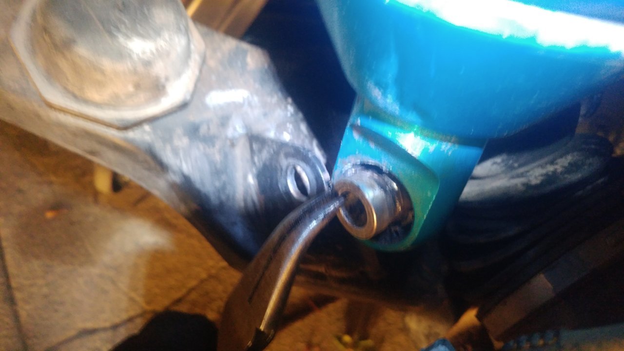

    Cross posting in both threads since I've got my coilovers ubolted...
    What's the best way to remove the misalignment spacers so I can press out my spherical bearings? Does the snap ring come out first? @Speedytech7
  7. Oct 16, 2018 at 6:55 PM
    Speedytech7
    Feb 20, 2014
    #123587
    58,405
    FCQM+VG Cheney, Washington
    It's less Tacoma and more mod
    The misalignment spacers just pull out or fall out by hand, theres nothing holding them in when the coilover isnt installed
  8. Oct 16, 2018 at 6:55 PM

  11. Oct 16, 2018 at 6:56 PM
    eon_blue
    Mar 4, 2016
    #180213
    69,991
    Azusa, CA
    Weird mine seem pretty stuck in there after pulling the 19mm bolt out ...I'll give em a harder tug with some pliers, didn't want to damage them if there was a specific way

  14. Oct 16, 2018 at 6:57 PM
    Speedytech7
    Feb 20, 2014
    #123587
    58,405
    Put a set of pliers on either side and pull apart, only thing holding them would be grit or corrosion

  20. Oct 16, 2018 at 7:01 PM
    eon_blue
    Mar 4, 2016
    #180213
    69,991
    Azusa, CA
    These fuckers
    And yes there's a snap ring on Kings at least
