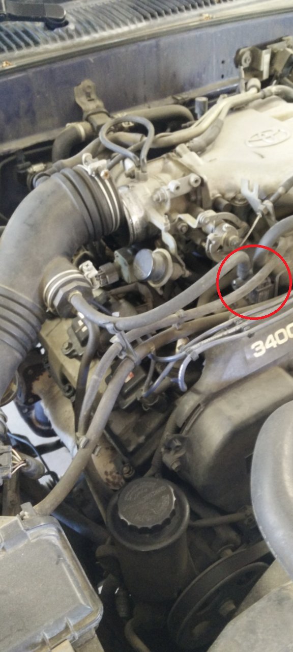

    Hmm, 4Runners appear to be different in this respect. The AC idle up on 95-97 tacomas with 5VZ and 3RZ is done by a secondary solenoid. I removed mine last night actually, but your doesn't appear to be there or have ever been there since I don't see a plug for it either. So maybe you do have a fucky IAC

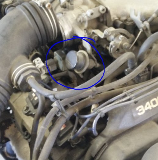

    Dunno if it helps but this is what mine looked like

    That's the AC idle up for early trucks

    What's this thing?
  13. Mar 2, 2023 at 9:52 AM
    Speedytech7
    Feb 20, 2014
    #123587
    57,420
    3435 E Trent Ave, Spokane, WA 99202
    It's less Tacoma and more mod
    Dashpot, makes it so you cannot close the throttle entirely abruptly. Keeps it cracked just a tiny bit for a second when you let off fast to avoid the rich spike emissions.
