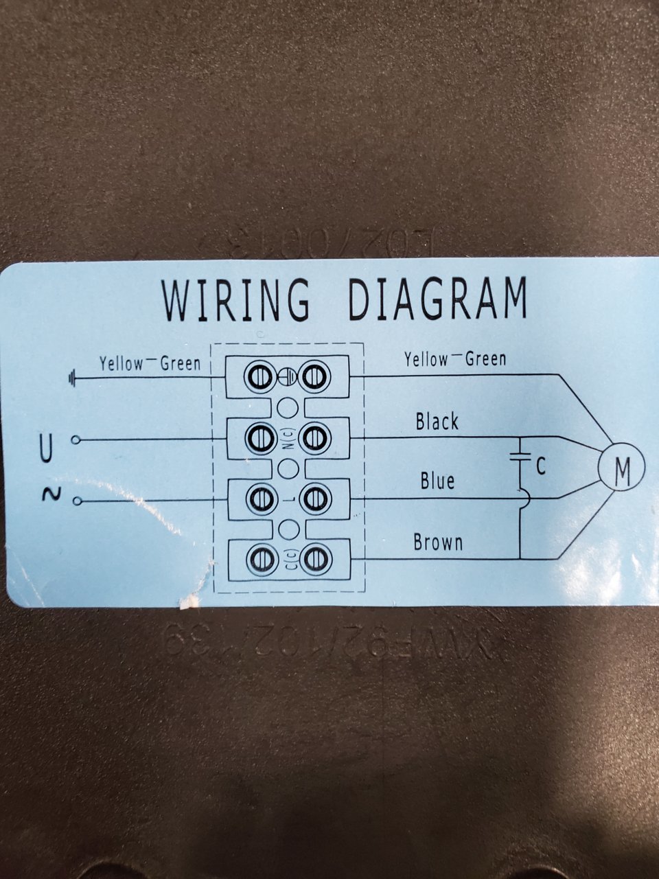

    https://www.electricalonline4u.com/identifying-windings-single-phase-induction-motor/
    "the resistance between the common and starting will be greater than the Resistance between the common and run wire. So the greater resistance between common and other wires will identify that this is starting, “starting connection”, or terminal. So you find out that starting connection. So it’s clear the other wire is run connection wire."

    Wait is this a 3 phase motor? Why are there 3 wires + gnd?

    Nope it's a 120v single phase. Really confused me as well... this is their wiring diagram in all its chinesium glory20230301_111248.jpg

    Alright that makes sense. I just made it home so I'll measure those resistances in the morning.
    Thank you for going out of your way to help me make sense of this. I knew I was fucked when I had to tell tech support (of the heat exchangers manufacturer) that there's a difference between a start cap and a run cap lol

    Oh, well there you go, right?
    Blue-Black should be primary, brown-black secondary, right?

    Ready when you are lol
    I'll be going solely off the phase diagram above that keeps popping up since I have no clue other than this how much of an out-of-phase pull you need.
    It would seem you only need about half the magnitude of Im for Is (start), and can remain in lagging pf as shown by I, so the cyan line can be around half the magnitude of the blue line.
