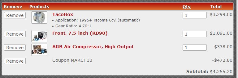

    Spend the extra $150 on the ARB twin it's badass
    The front ARB locker is amazing, works way better than the factory yota rear elockers
    I'm sure someone will chime in with "but air leaks blah" yeah we know :luvya:

    The dual is like $650 now... from what I could see
    But honestly I would be more willing to pull the trigger on the tacobox if it didn't mean tracking down someone to make me a custom driveshaft

    Does it make any sense to do a Truetrac in the front if I have a rear e-locker?

    No one ever likes my answer to that.

    Give it to me straight lol, I could go either way right now

    No, an LSD in the front is annoying when doing anything but going straight and not as effective as a locker if you lift a tire.
    treyus30[QUOTED] likes this.

    Does that include on-road?
    I'm thinking front locker = I'm going offroading a lot more often, or LSD = I'm cornering harder (assuming I'm cornering at all in 4WD)

    Won't do shit if the ADD isn't locked in anyway, you shouldn't be cornering in 4WD on pavement, you'll unalive the chain and drive gears in the T-case fast enough.

    ok, ARB locker it is

    I could see an argument for a front LSD with an AWD t-case though, then you could corner on dry pavement and still turn (albiet with resistance) and see traction improvement.
