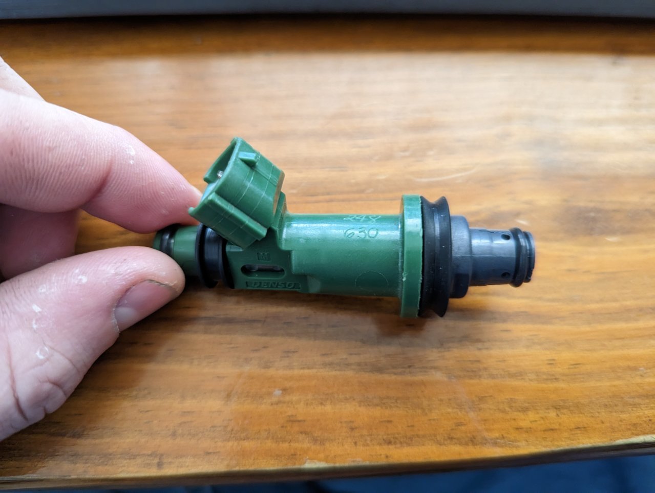

    You obviously know more about injectors than me, but it's gonna piss me off if he directly lied to me after I repeatedly expressed that I didn't want modified injectors
    Wish I could have gone with something like Bosch but I have no idea what I'd be looking for to mate with the factory fuel rail, etc

    I wonder if he flow tested them and found them lacking... I cannot remember if the LCE ones were engraved or not now. @Digiratus do you remember or have a pic, I know you took a lot of pics when I was installing them. They look identical otherwise.

    That's what I'm working on right now, a combo that gets people the ability to use 60mm, 48mm, or 36mm Bosch or Siemens/Deka domestic injectors which are cheaper and have greater support. This also removes the variable of the air pintle seals failing and you losing boost pressure at one or more of the 6 seals in the lower intake manifold. I don't know that Denso would have ever made an injector with an air pintle that was that large, so I'd suspect they're modified but probably by someone talented and they were probably flow benched afterward.

    I don't remember any engravings. I'll see if I have any pics.

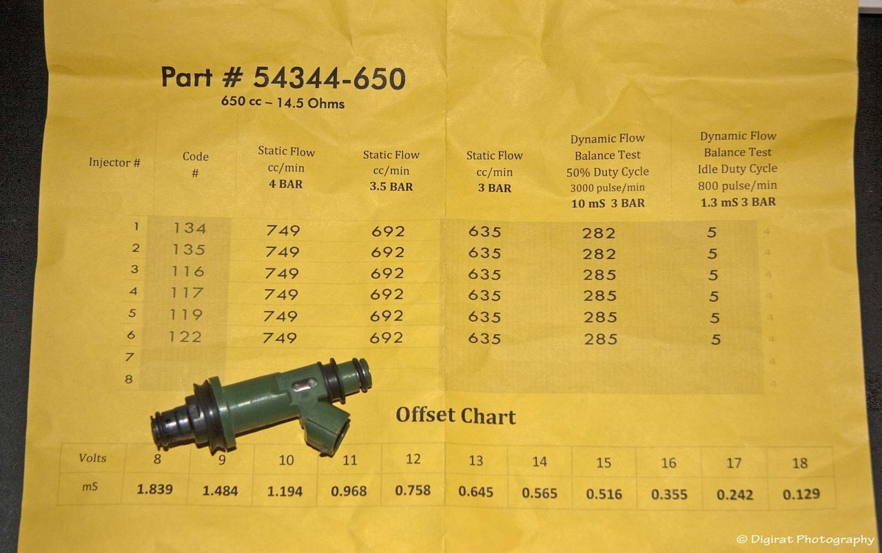

    @Speedytech7
    @treyus30
    I only have one close up photo of one of the injectors and the tech sheet I got with them from snpspeed.
    I cropped this one to enlarge it. I'm not seeing any engraving, though that face might be facing the other way.

    Alright, he must have moved to engraving columns 4 and 5 on them instead. Thanks for the info.
    My caps are a weird color too

    Oops, I forgot they had two listings. I was looking at these: https://www.lceperformance.com/Performance-5VZ-Modified-Fuel-Injector-Set-p/1062213.htm
    But ya, idk. I assumed all Densos would look roughly the same.
    I can see inside the cap without removing it and it definitely does not have the little pintle holes that OEM injectors have, so I don't think they are OEM-modified, at least.. Is there a problem if they are the same as LCE other than coloring him a liar?
