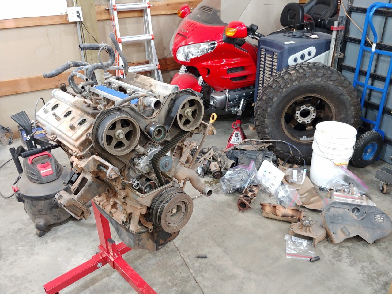

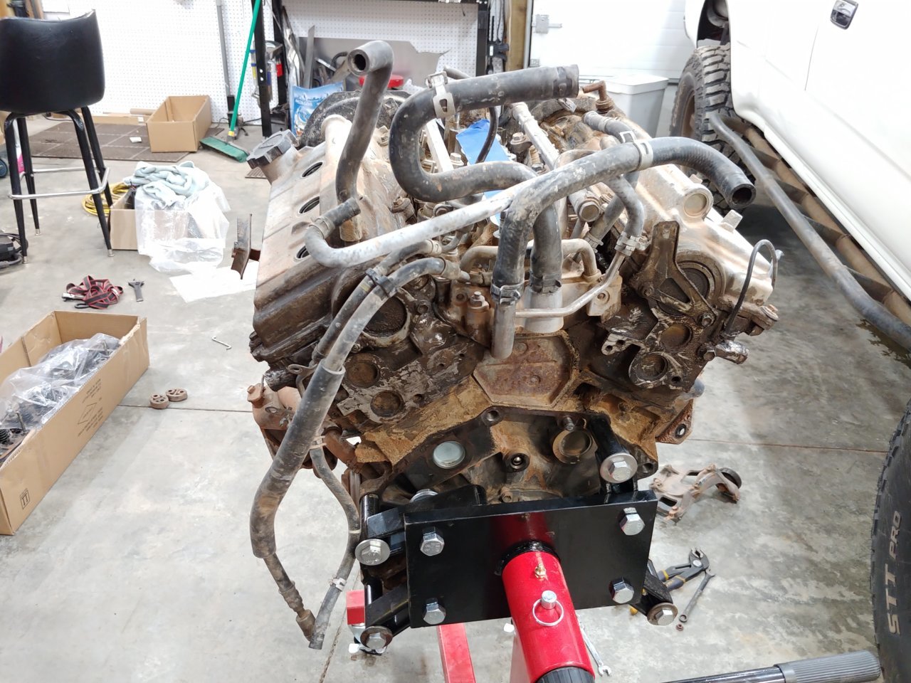

    I started taking the engine down. She's a bit leaky, gonna re wrap my harness too while I'm in here.

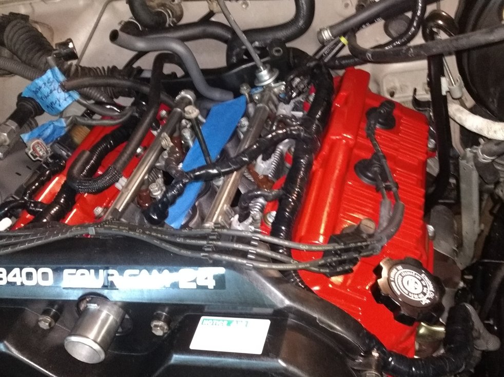

    I removed the plastic from my harness around the injectors. Those Squirrel Concepts dudes in California use tesa tape. Not sure what I'd wrap the rest of the harness with.

    I rewrapped all of mine with F4 silicone tape. Rodents will not eat it.
    https://youtu.be/Ug9o8a6-Sg4

    Shoot I have some of that stuff but it's so thick... and if I remember correctly like $20 a roll.
    CS_AR[QUOTED] likes this.

    This one goes further than any that I have used. It is thick and can be stretched 3x beyond roll out length.
    https://www.amazon.com/Proxicast-Pro-Grade-Weatherproof-Self-Fusing-Electrical/dp/B00K5GW67O

    I like to use Tesa tape too, but I have some convoluted tubing for the thicker areas too.

    You just unlocked a memory from my 95 tacoma
    The pastic heat shields were missing entirely so there was nothing supporting the harness Goin to the injectors
    With all the bouncing around the terminals inside the connectors no longer made contact with the injectors once I wrapped and supported the harness in Tessa tape and bolted them to the valve covers with p clips
    That was a pain to figure out

    I have paperwork showing that the valve cover gaskets were done in 2015, but they used FelPro permadry shit and they leaked surprise surprise. Back of the engine is just a fucking mess from VCGs. But front and rear mains are dry as are cam seals which is nice.

    I'm debating on the rubber cushioned p clamps as well.
