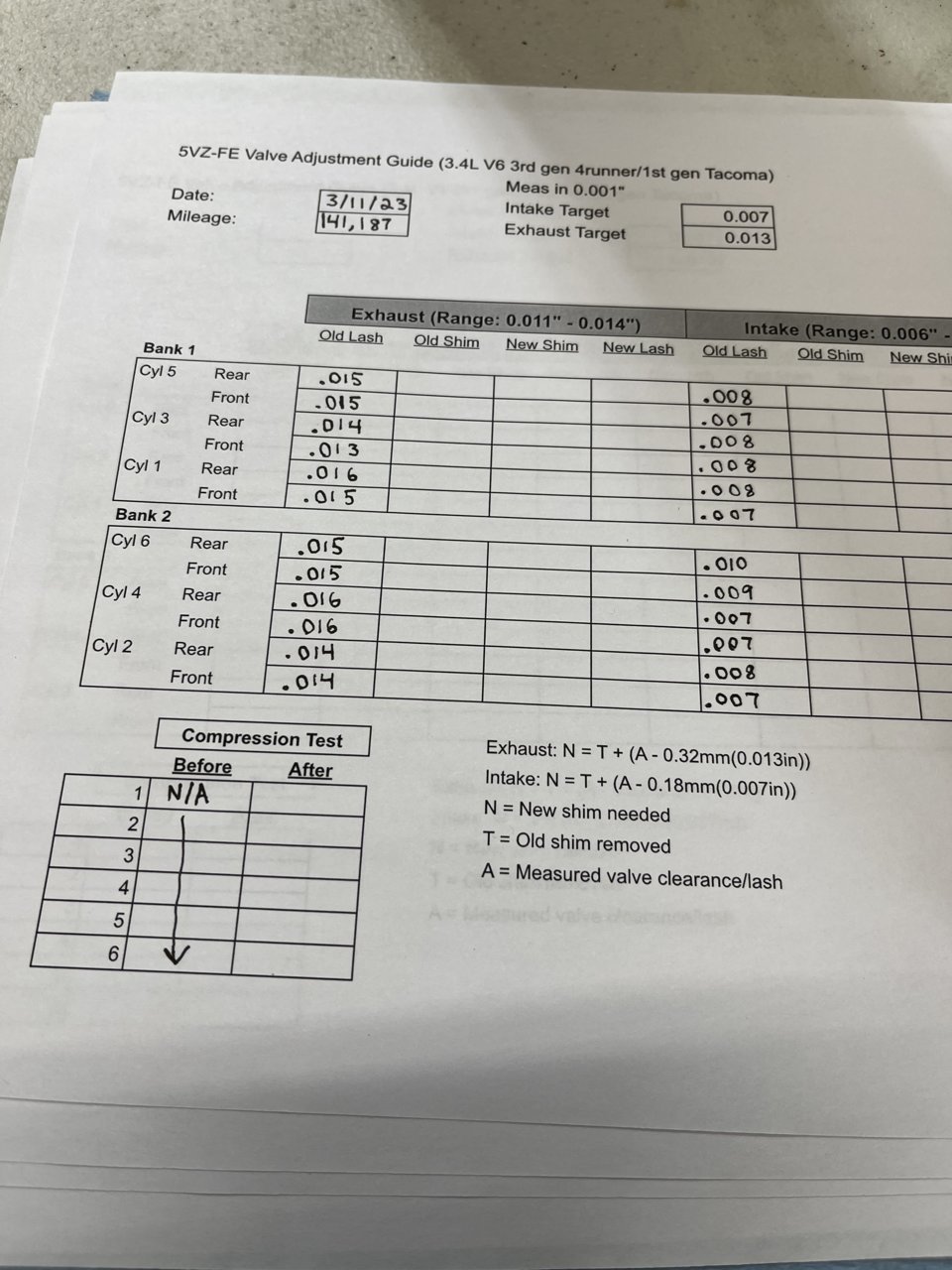

    Some feeler gauges were definitely super tight fits. Like the bank 2 cyl 6 exhaust or the cyl 2 intake .008 value. But they fit so I went with that value…
    Some of these are completely fine. Exhaust is high across the board almost though…

    Cool, are you diagnosing an issue or just doing PM?

    Multiple head gasket leaks. Likely external and caused by corrosion. Just checking everything on reassembly.
