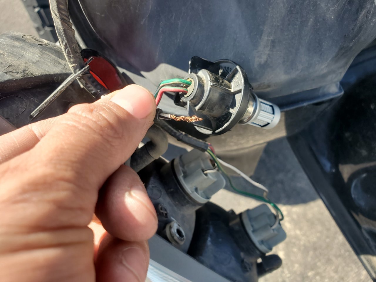

    Fixed my rear tail light issue.

    What was it

    So the rear lights work the same as 4Runners and Tacomas via ground switch.
    I inspected the bulb sockets (to clean them with Deoxit) and found a loose ground wire.
    I pulled it out so I can better diagnose -
    Left it off, and my issue remained the same.
    I put it directly in contact with the metal bulb socket and to my surprise, my issue remained the same.
    I know it's a ground cause it's got a black stripe (common with Toyota). It wasn't until I followed it back and it "splits" into three grounds; one for each bulb socket in each taillight housing.
    The wire had been cut, as if pinched. Stripped it back a bit, crimp connected it, and it works as it should.

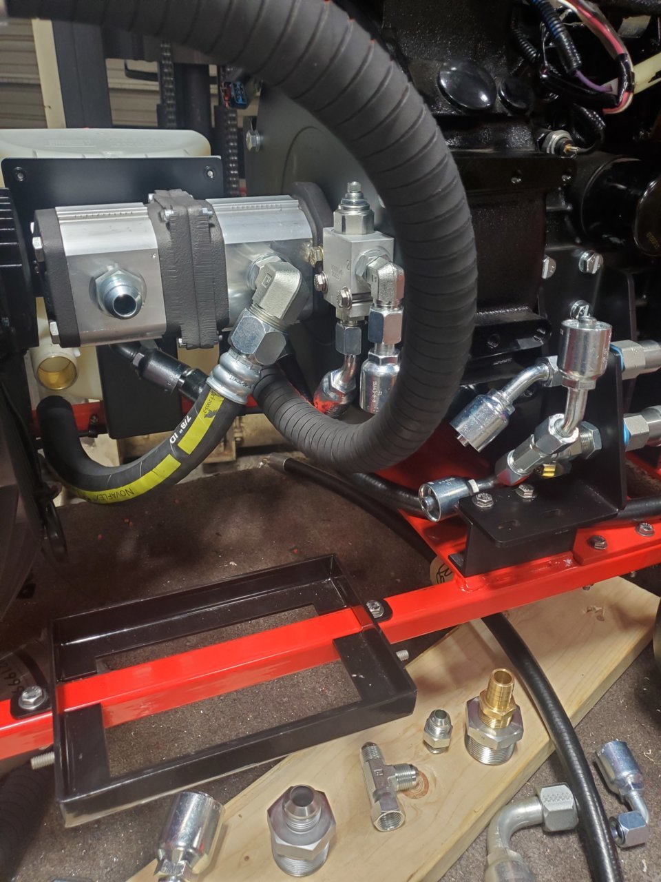

    Someone plz put me out of my misery :help:20230316_164014.jpg

    @Kwikvette @Wulf it's ya boi, toomanyadaptersman

    BRO
    DAS CRAZY IF PEOPLE GIVE YOU SHIT CUZ YOU JUST ADAPTIN AND SHIT BRO
    LIFE GIVES YOU LEMONS AND YOU JUSS TRYIN TO ADAPT N SHIT

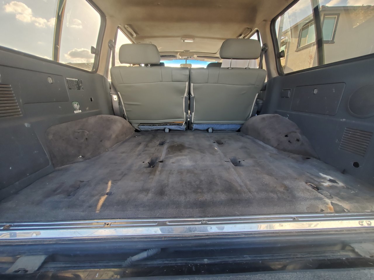

    On a real note, I didn't realize how the rear "carpet" easily lifts up.
    This will make replacing it super easy but I only want to do that once I can find clean replacement interior parts that aren't overpriced.
    Ripped some more "extra wire" out, and with the sub removed, I feel better about what's going on in this LC.
    Also replaced many of the clips that hold the interior so no more rattling in the rear.

    My carpet back there is always moist and I've given up on finding out why, I just dont tuck it in anymore

    Shit that sucks.
    Mine isn't moist at all (even with the recent rain) but it's worn and stained like a MF.
    Ideally I should go with sound insulation and do away with the carpet and replace it with an all-weather mat back there.
    I just hate how the trunk space looks ugly compared to the rest of the interior with new leather/seat/console.
