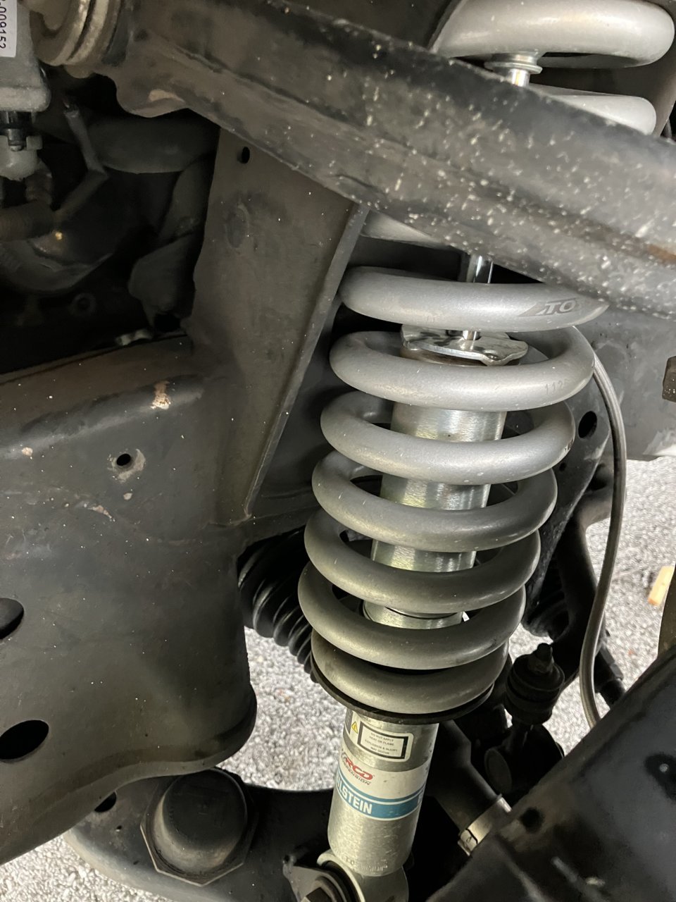

    It's tough especially when you've been exposed to other coilovers/shocks that are just better valved, and better overall.

    There's more as far as your part number goes, or better yet their length and spring rate.

    Yeah I regret all the years I put off getting coilovers and real shocks for my green truck. It was a night and day difference on and off road. It's one of the first things I do now when starting a build, so much improvement for really not a huge sum of money.

    Pretty sure those are the infamous 620lb coils though, that setup was dogshit with my 5100s

    620lbs, 13" length?
    He has a stock front end too.

    With coilovers I just pickup whatever I can find used cheap, they're all the same when it comes down to it, most even use the same parts internally. I'm just gonna revalve them and change springs anyway.

    I have the same coils and 5100s, and think my ride quality is pretty decent, but that's totally a subjective feeling. Just got my wife the new Rav4 Hybrid and drove it on an 8-hr road trip over the weekend. Ole' Dorothy [tacoma] felt pretty harsh upon my return, but not to the point I felt the front end would fall apart

    Something like that, I forget them length, it's not an important metric since they're not typical coilover springs they're made to fit on stock front style setups. But without weight and with a swaybar they're rough man.

    Well, coils for sure are.
    I think there's maybe some 8-9 different 'brand' coils that all buy their coils from the same manufacturer.
    Pretty sure I had texted you pics of coils we were powder coating for Eibach, King, and several more.
