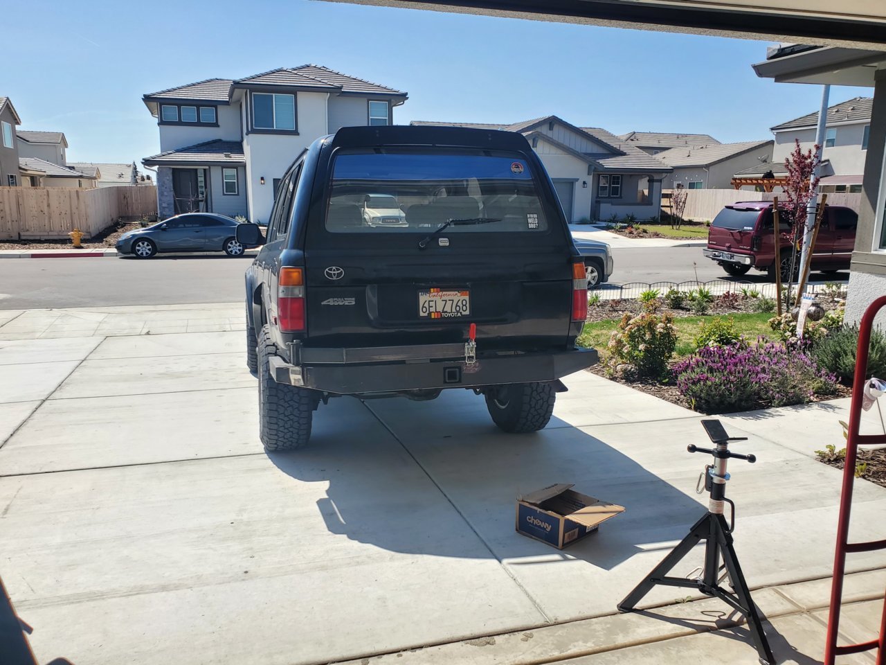

    Like I said, it's been pretty much 90% done for a long time now.
    Just dreading the hardest part and that's getting the spare out from the shed; it's all the way in the back.
    As for the wings, I'm going to locate someone local to bend some DOM for me so I can weld it up for side protection.

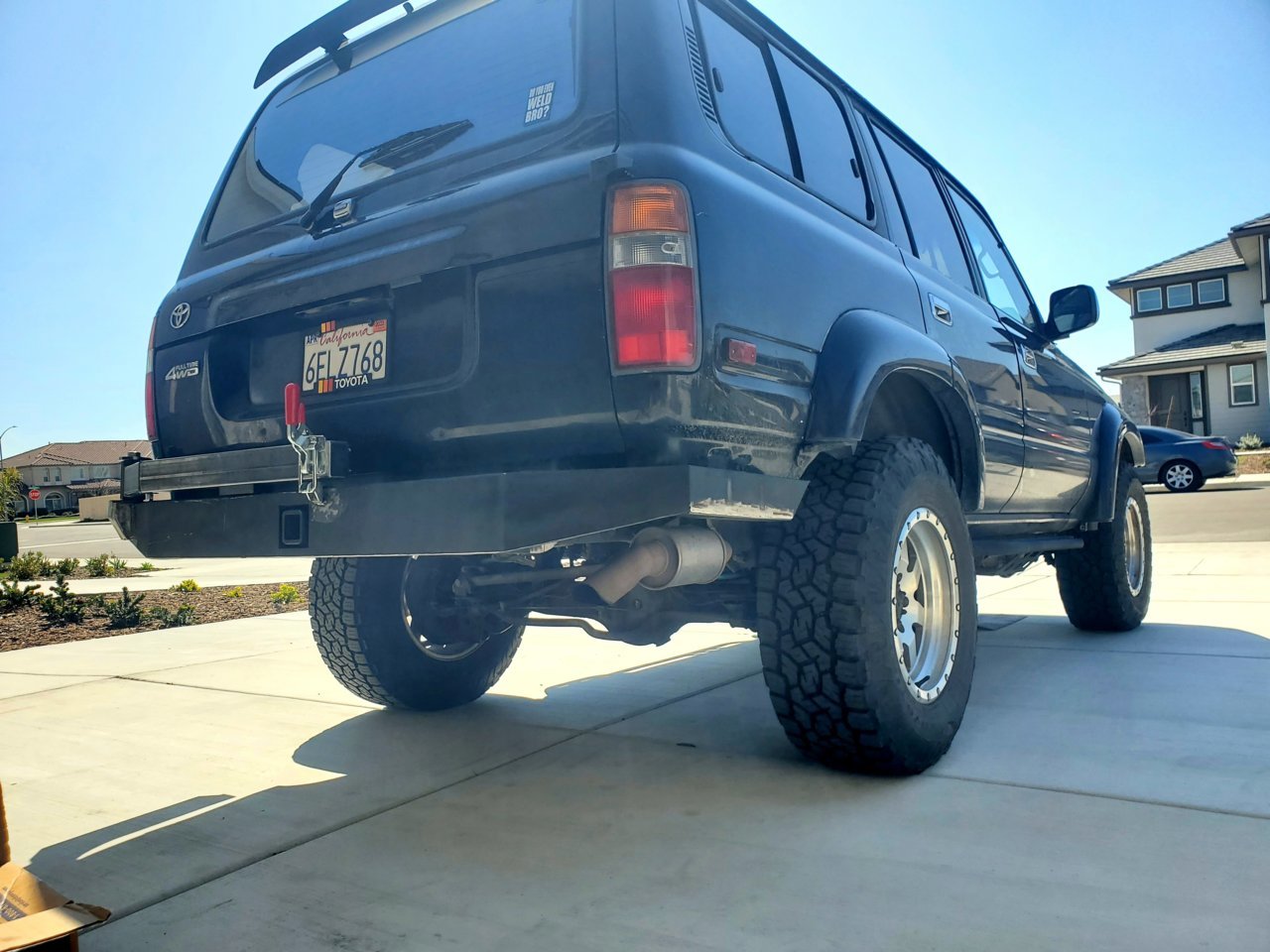

    You probably explained it but what's up with the gap around the receiver?
  11. Mar 26, 2023 at 12:08 PM
    Kwikvette
    Feb 27, 2019
    #284735
    80,895
    Fresno County
    4 run, 2 don't
    Aesthetics.
    I've always hated a large flat metal surface.
    Looks so plain and cheap.
    So I wanted to break it up by still keeping the receiver flush with the face of the bumper, but add a little recess around it.

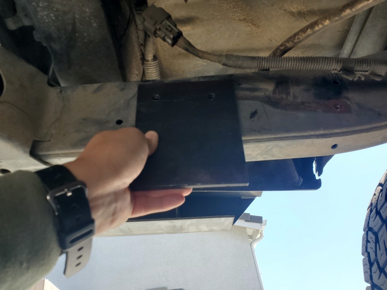

    Cutting 1/4" plate that will serve as a mount to the frame for reinforcing the wings from cave-in.

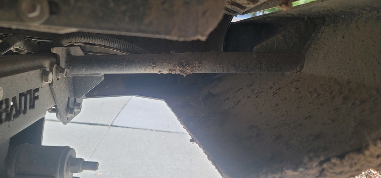

    Have 15' left of that 2" x 3" rectangular tube I can weld to said plate in a similar fashion to this?
    Though I'm thinking the rectangular tube will add too much weight and will be way overkill.

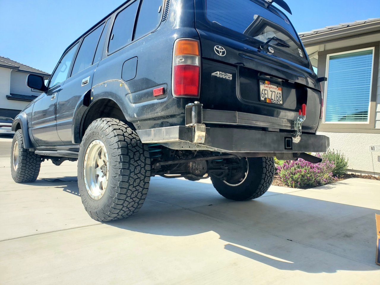

    This can’t possibly be your land cruiser, I see a rear bumper on it.
