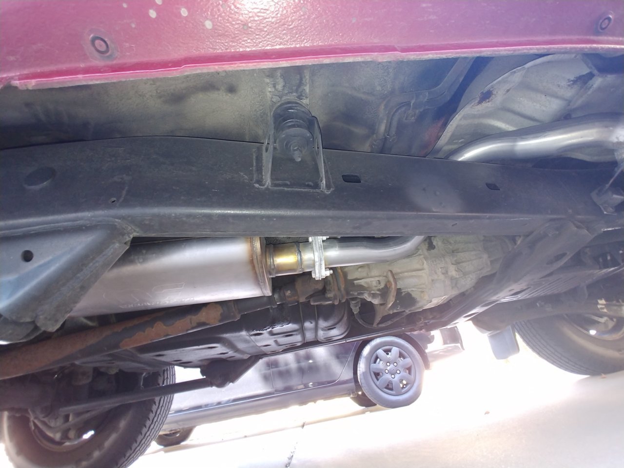

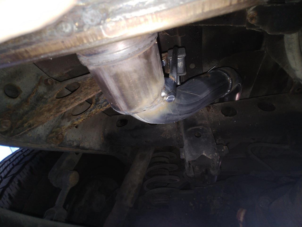

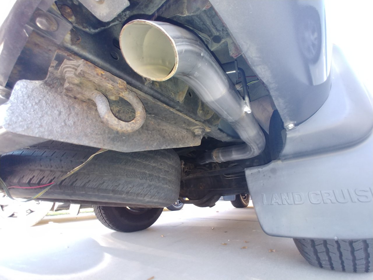

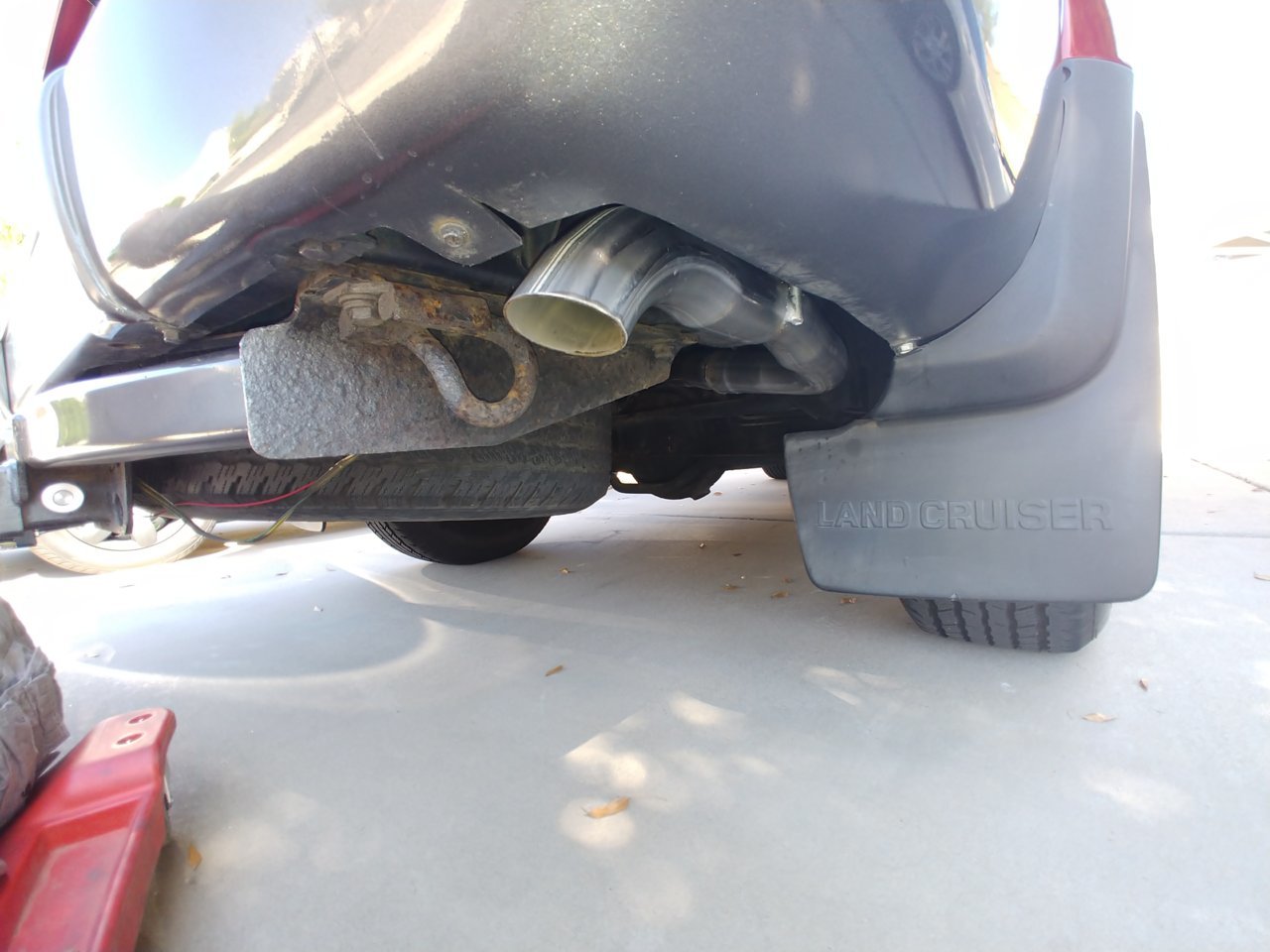

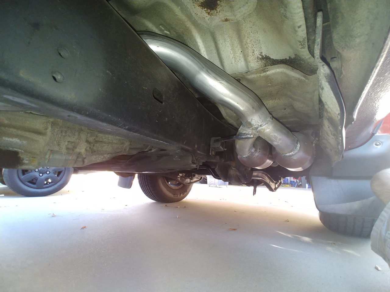

    That is some clean work!

    That's a great deal. Re-doing my exhaust would be nice, except...
    Yeah. I live in Nazi Germany. And you know how much the Nazis like their emissions standards.
    I know they make CA CARB compliant exhaust components but it doesn't seem worth it - they still come with the same restrictive designs because they are confined by the emissions regulations.

    It's less Tacoma and more mod
    They don't care about anything done after the cats for carb if that makes you feel better

    Its the company truck
    Only the cats need to be carb. Everything else can be whatever.

    @BartMaster1234 i have a a full 2.5” exhust with a magmaflow muffler. But my cats and headers are stock

    How much of a noticeable different would it make if I invested in new headers, cats, and a muffler?

    Other then sound not much if your N/A. It will flow better though. Maybe pick up a few hp but nothing super noticeable but it will sound good. You can even have it dump before your axel if you want

    @BartMaster1234 you dont need new cats, all carb legal cats are the same so might as well stick with the oem ines till they give out. Unless you get some bolt in high flows and just swap them out when time to smog lol.
    I also really wouldn’t go bigger then 2.5” exhust, are engines will never make enough power to really need a bigger size pipe, also 2.5 is cheaper and lighter then 3”

    Headers are nice for a few reasons, performance difference will be minimal (the stock engine doesnt need more flow) but your stock manifold cracks usually so it is a solid replacement. The long tube ones like LCE sells are minimum restriction meeting all in a large collector setup for larger than stock pipe (if you wish), they also are cut in at an angle for extra scavenging effect from low pressure cause by high pressure passing over the other pipes. Plus they are good for changing the sound a bit and they're much easier to work on with their coating. A new CARB cat may flow better than your old carb cat but not much we can do there. Larger diameter tubing (ideally before and after cat) and new muffler will change exhaust velocity and sounds, usually for the better. If you ever did go for performance with a SC or something the extra flow is great because as your volumetic efficiency increases your power does as well. Engine is a huge air pump, you remove restriction points and it functions faster. Plus you can pick and tune the sound to your desire.
