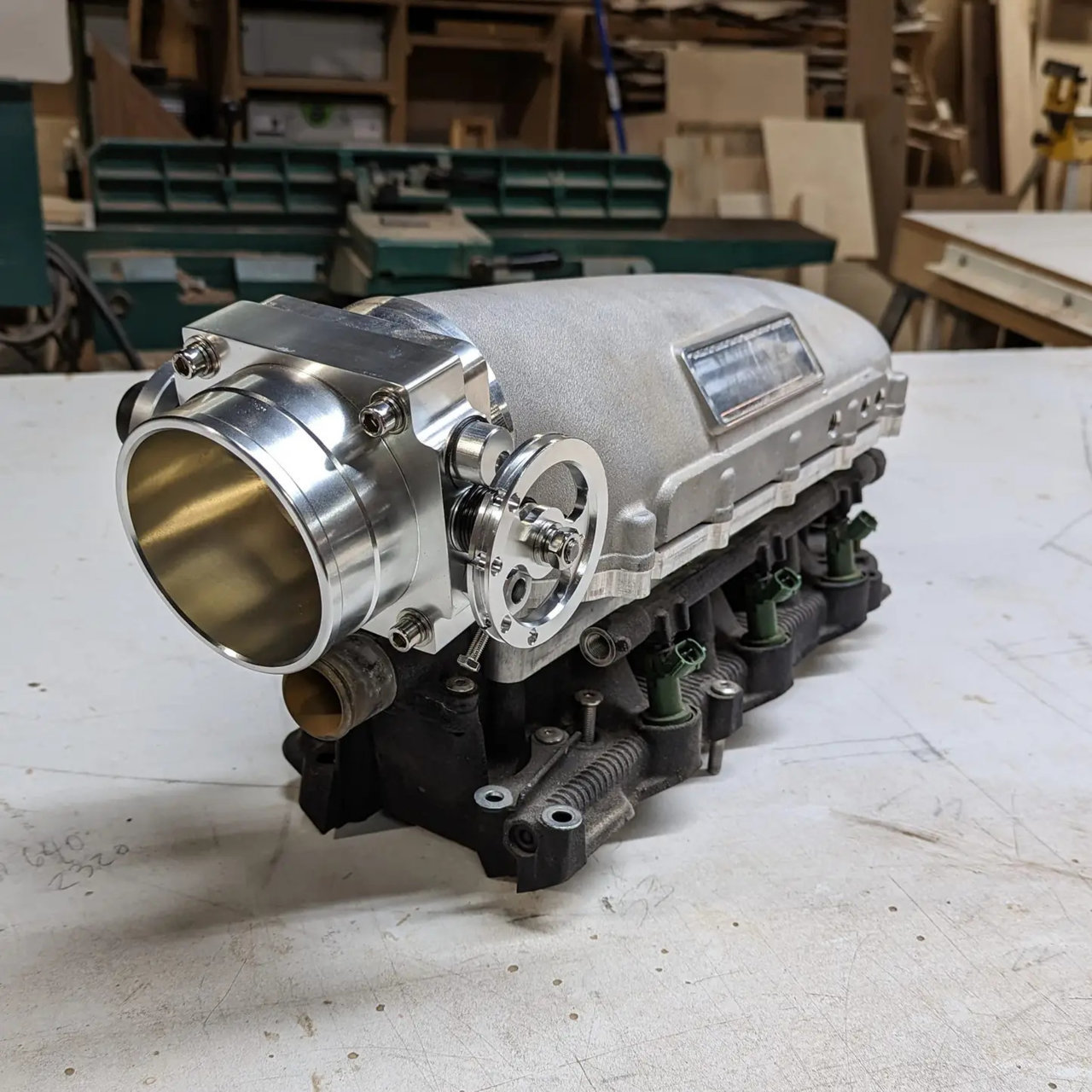

    I'd use a large bore DBW Bosch or GM body if it were me, they're both nice and thin. It's common for guys to use Ford style ones though, which is annoying but I guess they're super easy to configure and wire.

    The idea is to use LS throttles for big power. But the stock ecu runs this engine perfectly fine till you get to stupidly large cams.

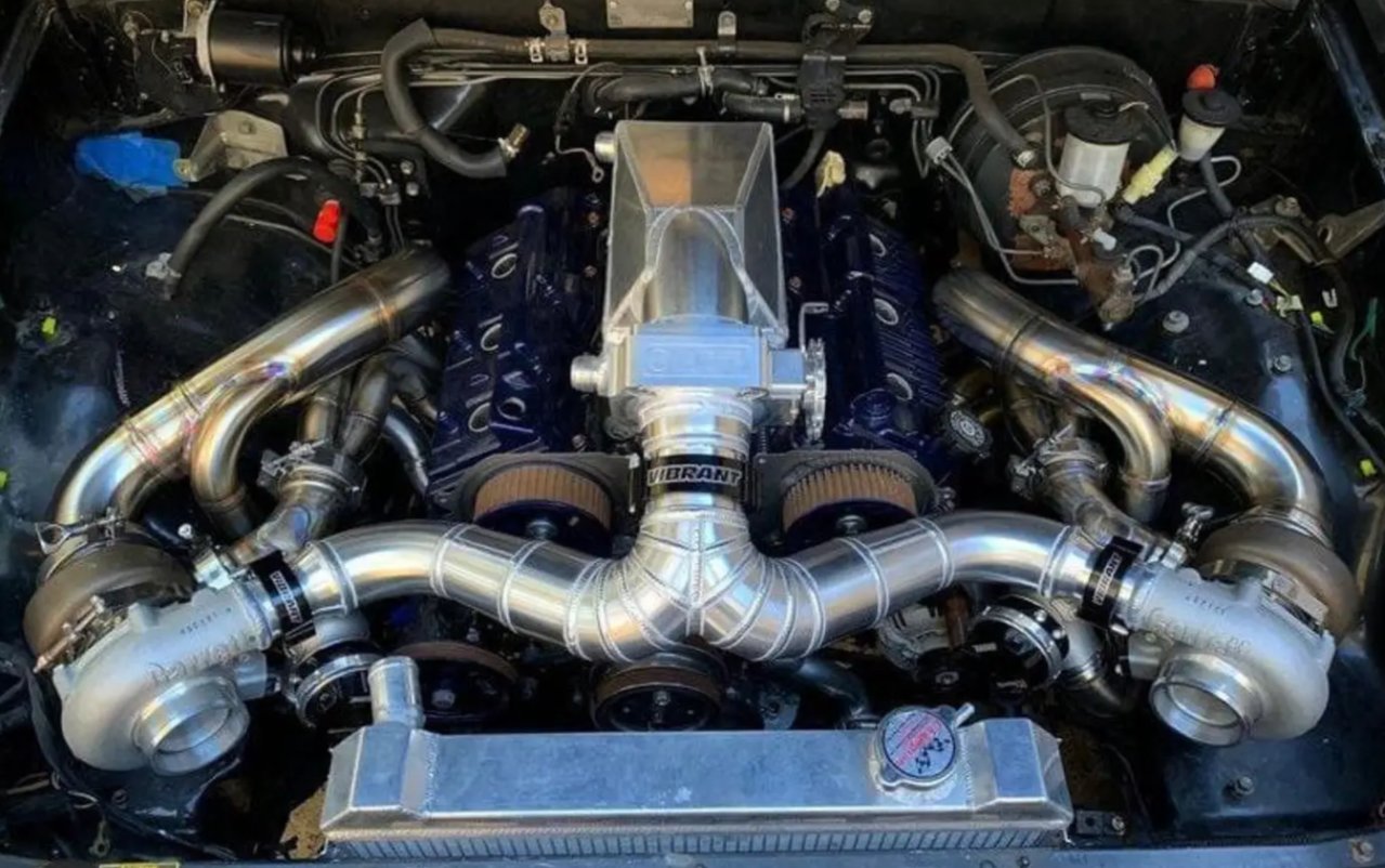

    Fuck that intake is tall as hell, but I like those cast manifolds, if you're gonna have cast, might as well have em close to the block.

    The headers are amazing. Like seriously. The casting quality is insane. And they’re toight to the block

    Are you sponsored by FIPG, cause that engines got a ton

    Half a tube gets the whole engine done if you do proper beads. And you need seal packing for the coolant jackets
    I’m well supplied usually

    Marc tossed that engine together. He puts more sealant down that I usually do. Lol

    I've picked it out of strainers and whatnot when other people have worked on their shit, I try not to overdo it.

    He doesn’t over do it. He just spreads it by hand where I leave the bead before assembly. The race engine had no signs of excessive sealant his way. My way just looks cleaner. The race engine ran ~13hrs of endurance racing with a bent rod before it blew lol. 2ar trough. He doesn’t race the GR anymore. The extra torque just kills tires. The 2ar was on pace to win before the kaboom
